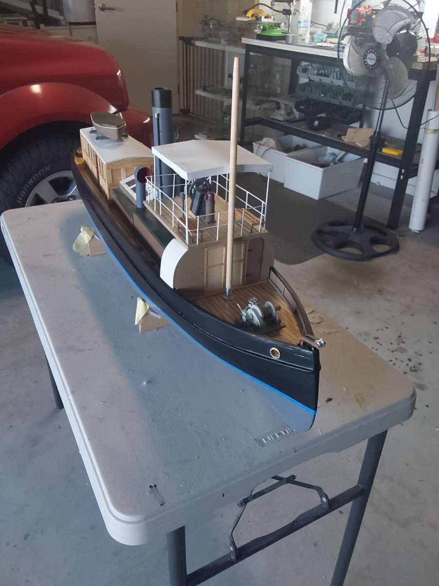

Another lovely clean, neat and tidy build Mick. And an interesting vessel with such a history.
Can I make one observation, not to be taken as a criticism, but simply something that would look a bit better. A taper in a mast takes place over quite a length of the mast and is a very gradual thing. I would normally taper a mast over around a half to two thirds of its total length. I bought a battery powered plastic lathe for the job so I have a good deal of control over the process, which a friend of mine also uses for making arrows!
If you don’t have access to a lathe I understand it can be a bit trickier to create such a gentle consistent taper but frequent checking for appropriate diameters at specific points should help greatly. If you compare yours with the photograph you can see what I mean.

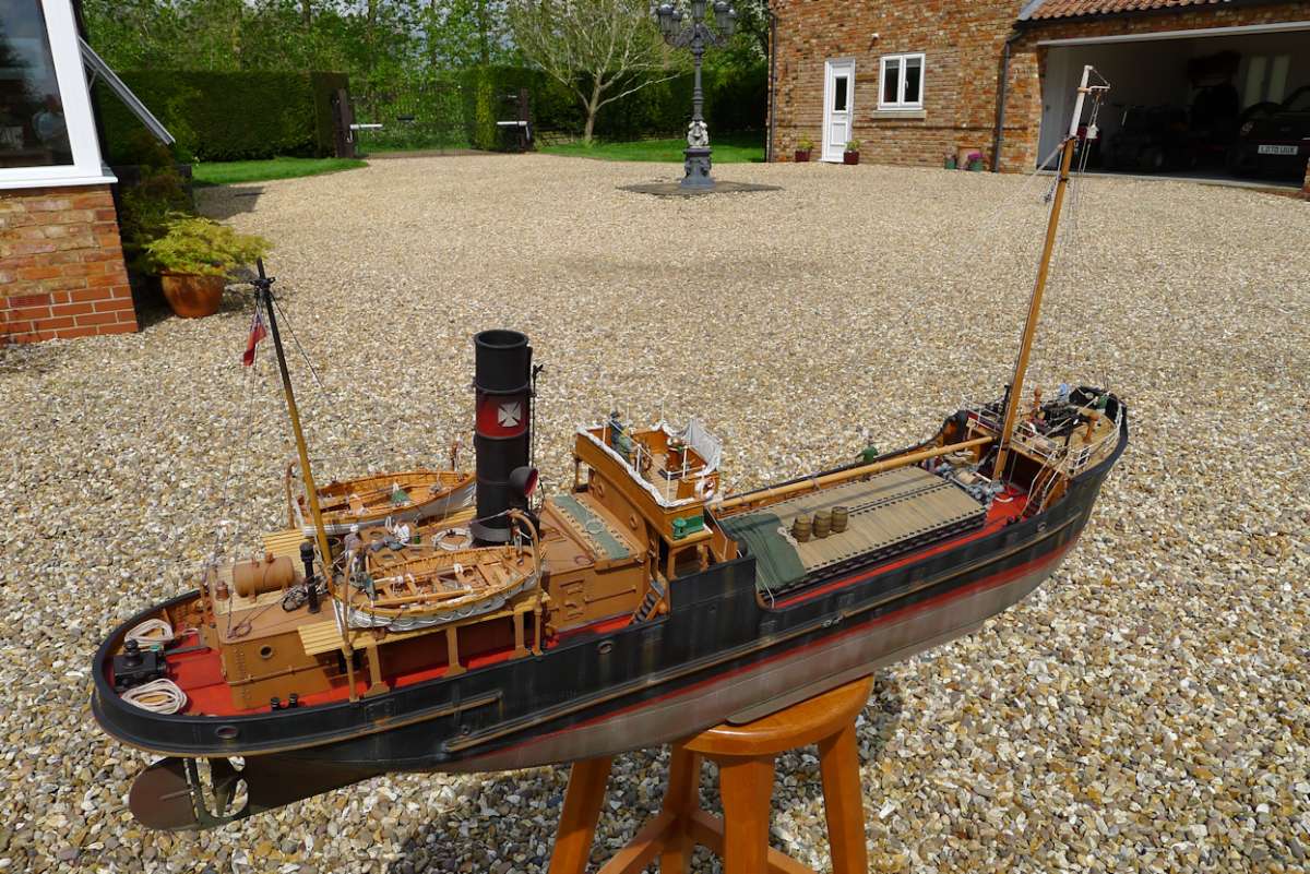

Both masts on the Ben Ain are tapered from lower than half their height and the boom is tapered for well over one third the total length from either end.
