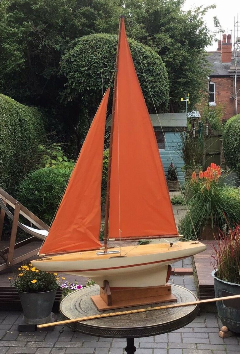

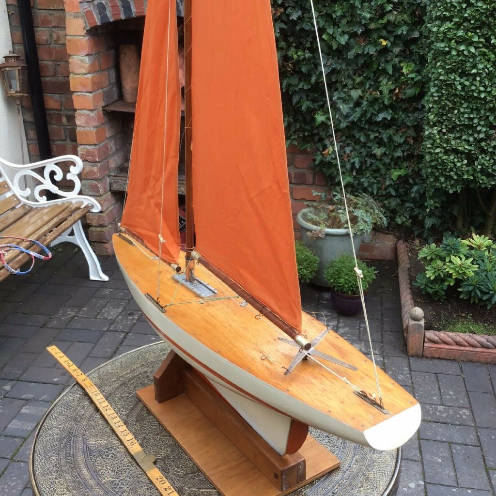

      I recently bought a pond yacht on eBay and wonder if anyone here recognizes the design? She was sold as dating from the 1950s but is clearly much younger, perhaps from the 1970s or 80s. She is a bit of a puzzle—a free sailing model too small for club racing but too sophisticated to be a toy. The rigging for the main sheets to the Braine gear quadrant is missing and there is no sign of blocks or fairleads for it ever having been fitted to the deck. But there is monofilament fishing line rigging set up to connect the jib boom to the quadrant. (I can’t figure out how this should be set up and am thinking now that the main sheets may have been rigged to the jib boom in error, although there is no horse for jib sheets.) Most of the rigging is braided line, with neat round bowsies on the booms and rectangular bowsies elsewhere. I am beginning to wonder if this boat was built from a kit, but the adjustable step for the mast and the Braine gear quadrant are clearly home-made. Curiously, the selvage of both sails is on the luff rather than the leach. She is 30 inches ( cm) long with a beam of inches ( cm). Any thoughts?

          Hello Jonathon
          I don`t recognise the model
          That`s probably why you have not had a reply?
          Just a few questions…….
          I note it has vane steering and also note that the Vane is missing which would control the rudder
          The Vane is fixed to the rudder and is normally set by the user to set a course across the pond
          You need a pond where you have complete access to your model as it arrives at the pond edge
          I think the Vane has some attachment to the sail setting too
          You really need to make contact with a keen yachter, who will provide the nitty gritty info.
          Look through the earlier postings and seek out anybody with a similar interest
          Best of luck

                Thank you all for the responses. I have been in touch with the UK VMYG about another of my yachts, but so far without any response. Hobbies of Dereham is a great suggestion, and would explain a lot about this model, thank you so much for that suggestion.
                The steering on this model is of the Braine gear type, and should indeed be connected to the main sheets and mainsail but this rigging is currently entirely missing. The jib boom, however, is set up to connect to the Braine quadrant, which is an unusual refinement on such a small and simple yacht. This is what makes me suspect that the rigging has been set up wrongly.
