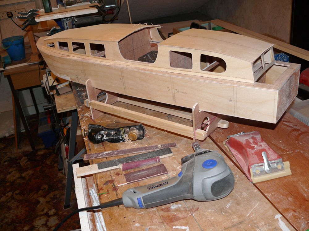

            The morning after the night before!
            More fun for Bob!………Trimmimg the roof!
            What could be nicer than a super sharpened quality plane, just waiting to skim down those crisp solid edges of the roof?………Followed by a nice clean up with the sanding block?
            Let me get at it………..Lambs to the slaughter!………Whoopee!
            er……………What`s that?
            A cry from the kitchen………."Your breakfast is going cold!"
            Back soon………..Bob

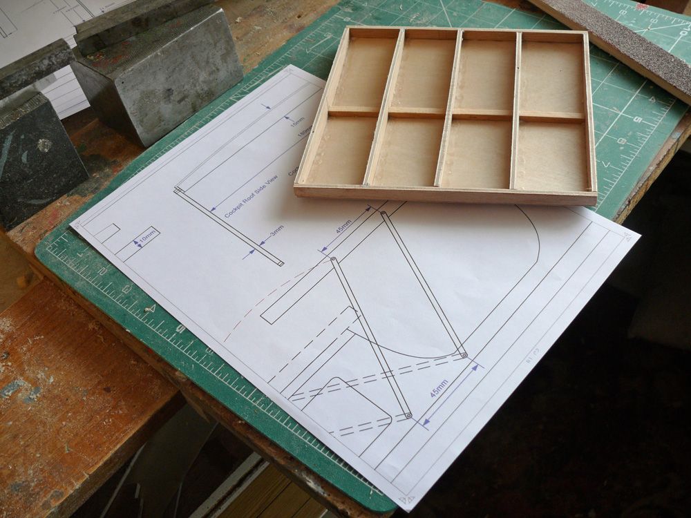

            #43809
              Shop floor to Drawing Office……
              Need a drawing showing roof cut out in the Cockpit area, please
              Take a look at Peter Fitness`s pictures for his version and also his clolour scheme for inspiration

                            #43830
                              Shop floor to top floor
                              The cockpit roof is drawn parallel…..How about tapering it towards the stern?
                              Also, it is shown in the raised position, but the legs are leaning back and won`t stay in that position automatically
                              I think they should be leaning forward in the raised position?
                              Can you show the canopy in the folded back position please

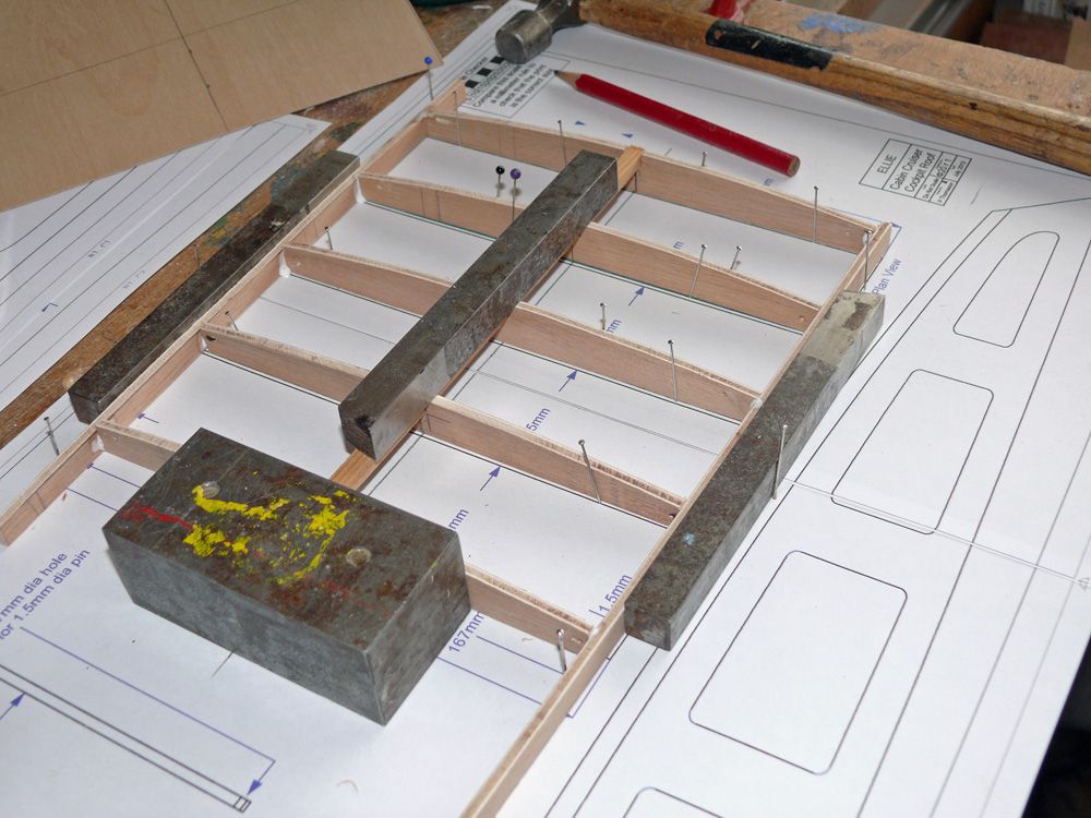

                                            Building the canopy frame………Remember the good old Keilkraft days?
                                            I made five identical ribs from 5mm ply at the same time and adjusted them to suit the tapering outer side strips
                                            Note Paul. I`ve added a central spine, for a bit of rigidity at the sanding stage

                                              I have to admit that I didn't think that a central spine would be needed but if in your expert opinion you consider it better to have one then I will include it in the drawings.
                                              I see from the latest photo that you are demonstrating how to use the drawings as templates, as they say a picture is worth a thousand words and I am very grateful that you have taken the time to show the less experienced builders how the drawing/template system works.

                                                I'm using 1mm ply for the canopy roof
                                                Picture soon
                                                Probably brass or Ali for the supports….with a few extra holes

                                                  Just for the Newbies
                                                  The finished canopy……Using 1mm ply and 4mm for the formers and frame
                                                  The next job is to make the support legs
                                                  I prefer Aluminium about 5 mm x 2 mm section……..or brass……..(Sod`s Law…..Got none!
