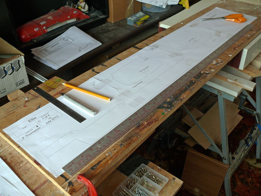

            The first job is to assemble the four prints that make up the keel
            Lay them out on a flat surface and align the bottom line of the keel with a straight edge, then finish off with the Sellotape

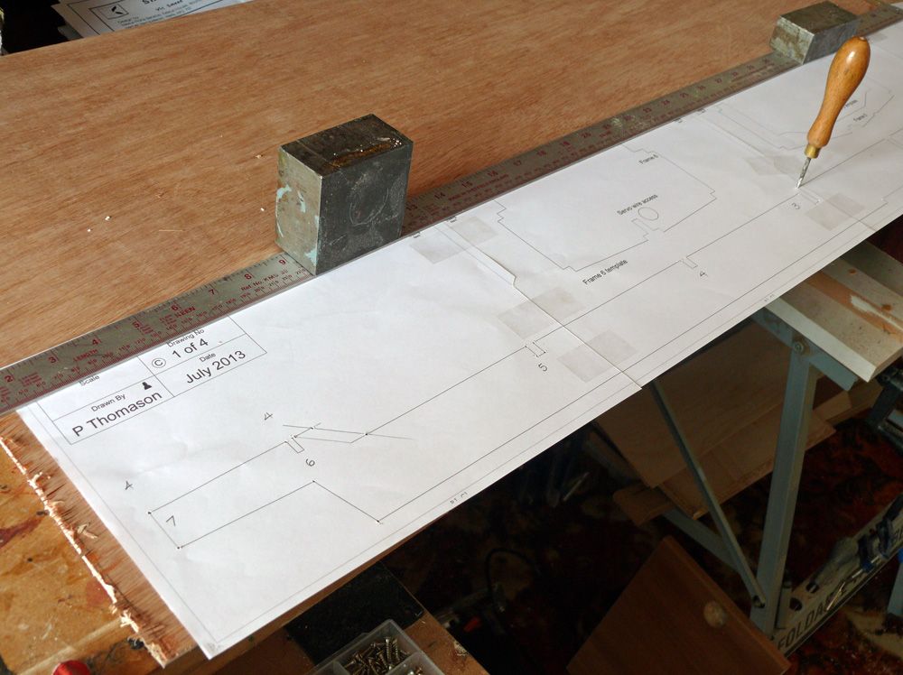

              Lay the keel plan over the 6mm ply and mark out the keel shape using a Bradawl
              #42312

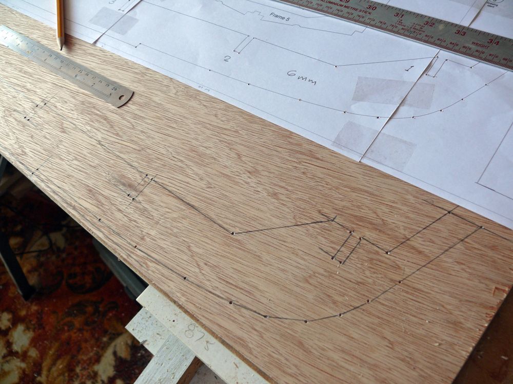

                The bradawl holes are joined up with a bold pencil
                Use a straight edge for the lond edges
                The keel can now be cut out on the Bandsaw

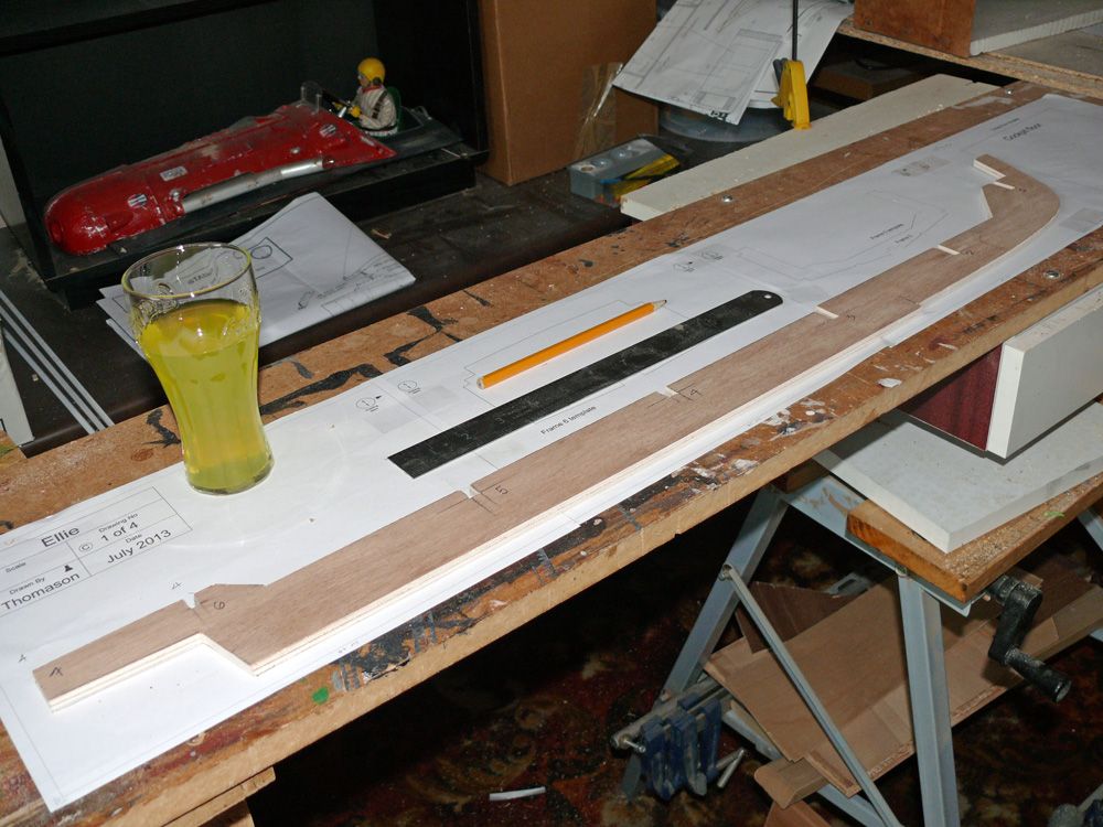

                #42321
                  The keel is now finished and works out at 35 1/2" overall length…..A nice handy size for the car boot
                  Advice for the Newbies……Check the keel for accuracy, squareness and straightness
                  Sand all over and remove sharp corners
                  It was so dull in the playroom just now, that I had to use the flash!

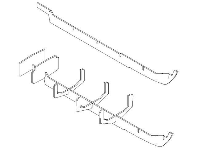

                                It may be a nice idea to show the hull formers and keel on the datum face, as being assembled upside down
                                The formers will be screwed to 25 x 20 strips and the strips will be screwed to the datum base
                                #42341
                                  Its a very good idea Bob and I've already started to draft the drawings but from an objective point of view is the model world ready for this level of detail?
                                  #42343
                                    Shop floor to Tommason Towers…..
                                    I think so
                                    A picture is worth a thousand words
                                    #42351
                                      This kind of thing
                                      I know they are the wrong way up but I dont want to give everything away.
                                      Edited By Paul T on 25/07/2013 11:28:22

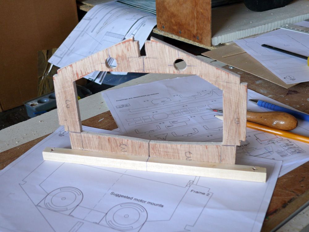

                                            There yer go, Paul
                                            Former 3 in all it`s glory
                                            Bob……Leading Chargehand
                                            #42358
                                              Looking good Bob
                                              I just hope that I have the propshafts positioned right or those holes will have to be changed and I wouldn't be very popular with the leading chargehand.
