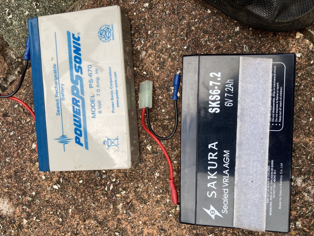

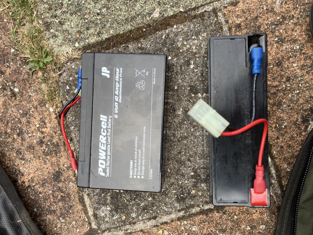

                  ok so hopefully I will be able to add some photos to this post. I believe I may have discovered part of the problem. I played around with a volt meter and I may have purchased some bad batteries. I have looked after these well and yet the voltage drops rapidly under load. I used some of the old 6v 7ah and the speed in and out of the water was acceptable. A question I do have that maybe you all can hopefully answer I’d where can I get some decent batteries that will last well and also as I said I am running the 850 on a 6v system ( purchased this way) would I be better keeping to this system to get better length of use out the batteries or would putting 12v but reducing the speed controller to half power say make the boat a little faster and prolong the battery? When I go fishing it can be over a few days with varied use. That said the boat is used for around 10 mins at a time every few hours say.

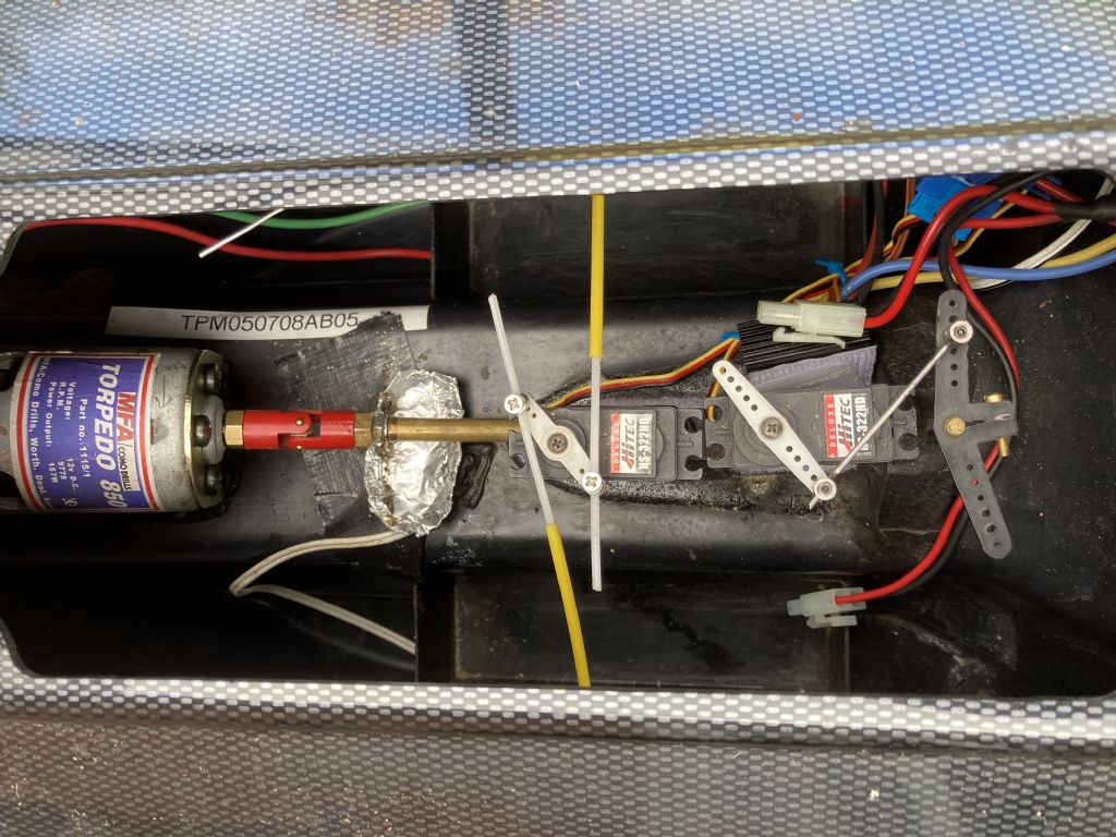

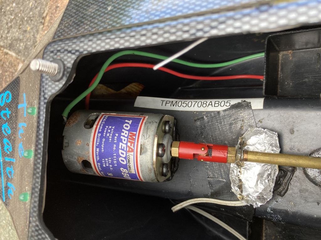

                        #101724
                          i still think it could partly to do with your shaft, and now having seen the photo of the motor ,coupling and shaft/tube………….there seems to be absolutely no play between motor and shaft, and when you open up on the throttle the thrust from the motor pushes forward and the far end of the coupling from the motor end then will bind on the prop tube causing friction and a binding of the motor/coupling and and shaft will slow the motor down with friction and increase amps used from your already dodgy batteries.
                          #101725
                            if you watch this video of one of my boats, you will see the trust of the motor pushes the coupling [same as what you have in your bait boat] towards the end of the prop tube and thus giving room for your shaft and coupling to run without binding.
                            on your boat there is actually no space at all for allowing and movement, and your 850 is a lot more powerful than mine, and is listed as 12 – 24 volts. as such with no space for thrust movement you are bound to get friction and therefore a drain on your battery power.
                            i would suggest you move your motor back away from the tube by about 5 mm at least to allow movement created by the motor.
                            #101726
                              watch the couplings and see how they move .just click on to the photos until you find the video. this was the boat with rusted shafts.

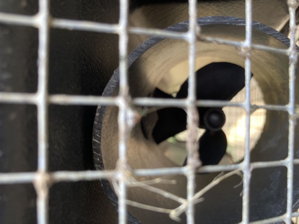

                                Thankyou. How do I watch the video? I can’t see a link anywhere. I do notice I get a little water and grease coming into the hull where the prop screws in. Is this normal?
                                #101730
                                  Click on the word "Facebook" in Neil's post.
                                  Further to what Neil has said I notice that you haven't got an oiling tube on your shaft. If the tube has grease in and you are getting water ingress there is a very good chance the tube is full of solidified grease/muck/rust/water etc..etc.. Particularly if it has been sat there for six years with water in it.
                                  I really think you should remove the motor, coupling and shaft, give everything a thorough clean up, re-oil or grease, I'm not a fan of grease in shafts but with your motor you should get away with it, and reassemble ensuring you have the play that Neil suggests.
                                  Along with Neil I strongly suspect you will find a tight shaft.
                                  Edited By Richard Simpson on 22/08/2022 08:18:15

                                        Water coming through is a sign of worn bushes. Do you have either grease or oil in the tube? With your motor you could get away with grease, which will help to seal the bushes better and prevent leakage. You can get new bushes or you might find the leak slows down to an acceptable level with some grease in it.

                                                    Yes, the 10ah batteries sound as if they are clapped out. Initial voltage OK and then suddenly dropping on load is a typical symptom.
