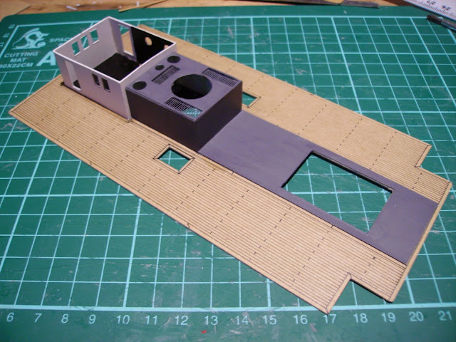

                #28443
                Laurent Gontier-Versailles
                  @laurentgontier-versailles47241
                  Hi Colin,
                  all by hand, much easier than on PC, scale 1/100:
                  Regards,
                  Laurent
                  #28444
                    Very neat Laurent, I did the same thing on my old SS Granada model to the same scale but not as neatly as you.
                    The spreadsheet I have does do a good job at 1:150 scale though so I’ll stick with that as a labour saving method. Not that  I’ve got into the workshop lately!
