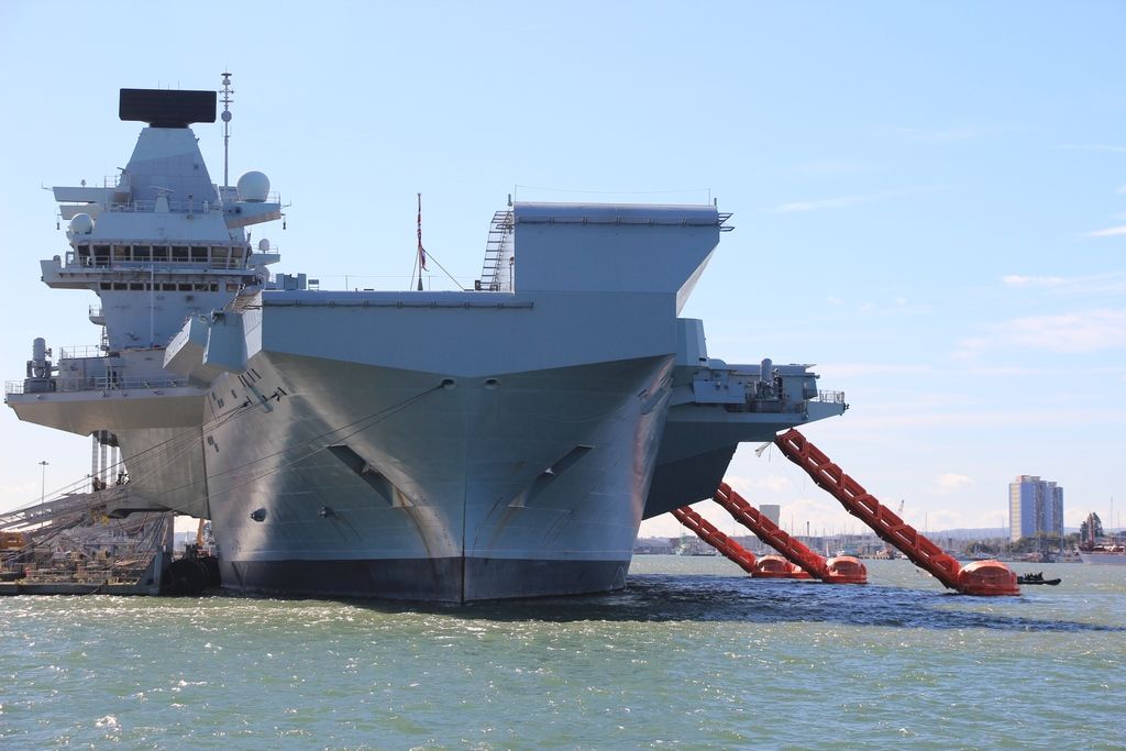

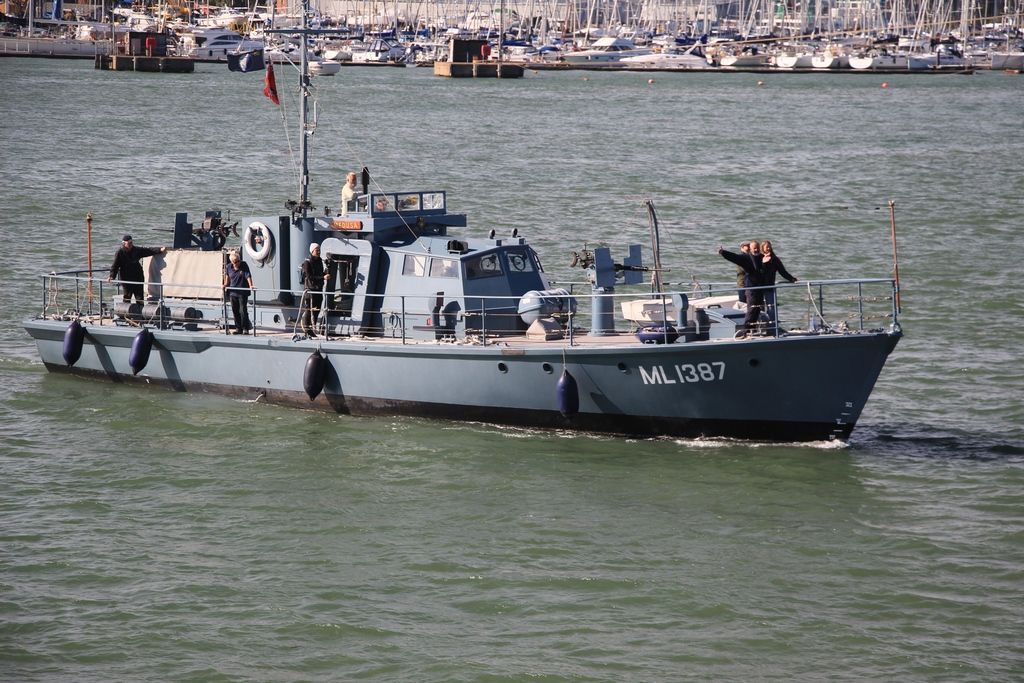

        As it was a nice sunny day, I visited Portsmouth Dockyard using my annual ticket and took the harbour cruise. As is often the case there was a variety of shipping on view including HMS Prince of Wales testing her emergency evacuation chutes. The photos in my album are a selection of the vessels I saw. Definitely 'a good day out'.
        Prince of Wales bow view
        HDML Medusa

              It’s a shame they have had to put the stabilisers out on the POW. Perhaps it needs some torpedo bulges to help??

                    Shame they couldn't afford a decent bow for the new carrier !! looks like its been effected by defence cuts
                    Also makes the older Ark Royal and Victorious look even better !!
                    #98170
                      I have wondered about the bow, but presumably they will have tested the ship in a wind tunnel, to get the right airflow across the deck so I suppose this is what they came up with??
                      #98171
                        Ashley, bending 25mm steel plate to a specific compound curve is a very expensive process, which is why it is only used where absolutely necessary. In a hull this is only in areas that affect flow through the water, i.e. bow shape including the flare to part the waves, and flow through the propellers and around the rudders, i.e. stern frame.
                        Everything above the water is a lot less shape critical and so flat plate is used as much as possible in modern ship design. There is no value whatsoever in having the top of the bow shaped so I am sure that is simply why it is flat.
                        This is precisely why cruiser sterns disappeared many years ago to be replaced by transom sterns. Try to find a modern container ship with anything other than a completely flat stern. This is also why even cruise ships are a lot more 'box' shaped than they ever were to maximise the use of flat plate as well as maximise the internal volume available for cabins.

                          Richard whereAS I can see where you are coming from, airflow over deck for an aircraft carrier is of vital importance (i would have thought) but it may be that there wasnt much difference viz a sexy rounded bow, so they made it flat to save a few bob??

                            Would it not be correct to assume that, for most flight operations, the carrier would be turned into the wind?
                            I'm also not so sure that modern fighter jets are anywhere as near dependent on wind direction as they used to be. I'm sure someone here will know.
                            #98180
                              Some information on the design history here:
                              Airflow over the deck would have been factored in. Fixed wing launches are via the ski jump and recovery is usually by sideslip hover if unloaded or by a rolling recovery if weapons are stil aboard the aircraft.
