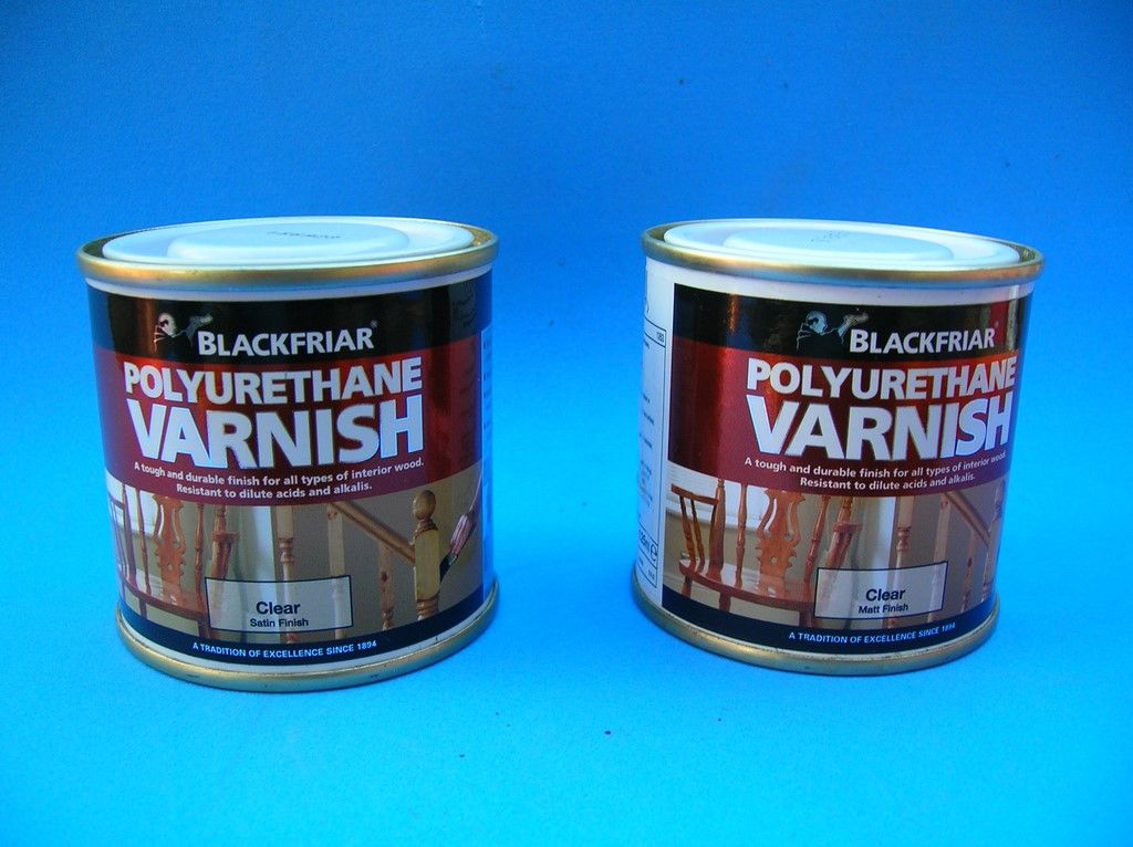

      As some people on here will be aware, I am a great fan of traditional polyurethane varnish which can be used over most finishes without problems and is very durable. Several firms make it but it is less easy to obtain than it used to be as the main outlets often only stock the acrylic quick dry type.
      Earlier today whilst in a traditional hardware shop in Emsworth, Hants, I came across these handy sized 125ml tins from Blackfriar. They also do a gloss as well. They are not cheap on the face of it at £4.25 each (although a lot cheaper pro rata than Humbrol tinlets) but I thought they were worth it!
      Edited By Colin Bishop, Website Editor on 01/10/2015 16:21:14
      #4253
        Handy size tins

                    Ashley, if you had looked at the piccy you would have noticed that the tins are Matt and Satin. Shiny boats are for Russian Oligarchs and people who build from hardboard. angel
