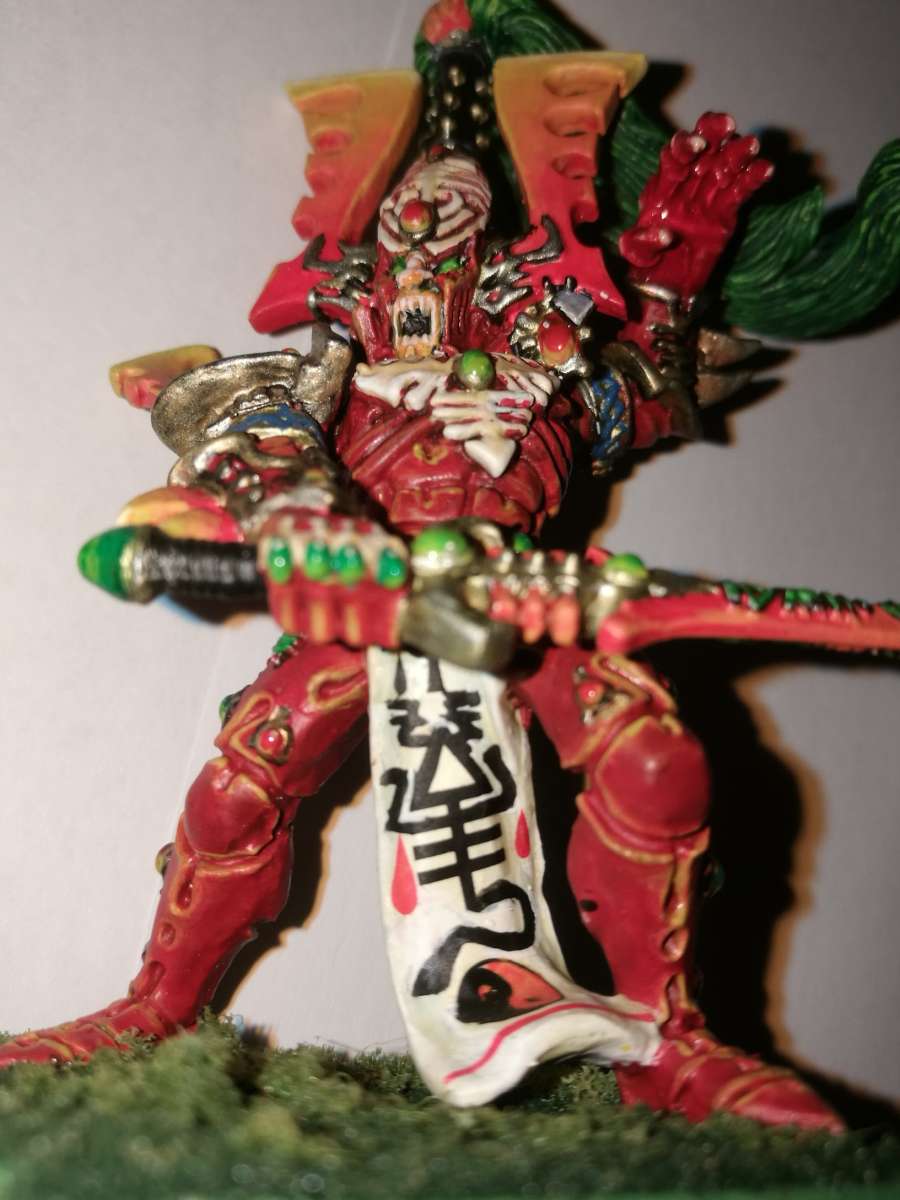

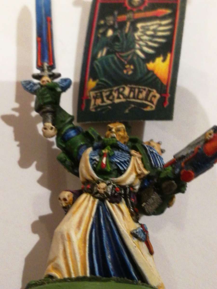

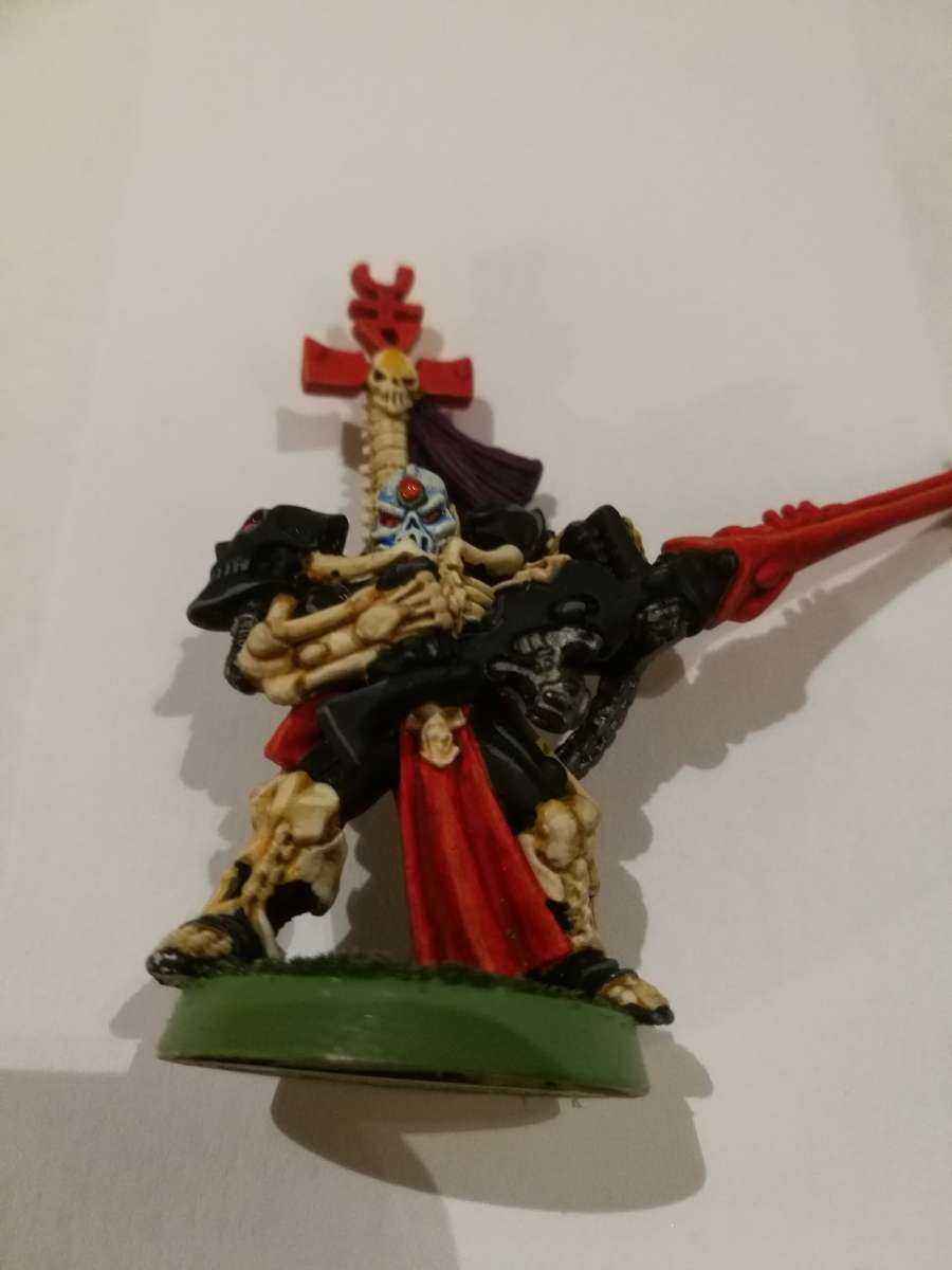

                Acrylics do allow some really nice effects for figure painting. A few e of examples from my Warhammer figure painting days.  TimIMG_20211031_165121_1761768764780IMG_20211031_164707_1761768626628IMG_20211029_214522_BURST002_1761768690889IMG_20211029_214522_BURST001_COVER_1761768686713

                    Lovely shading, something I have never been able to do with acrylics.
