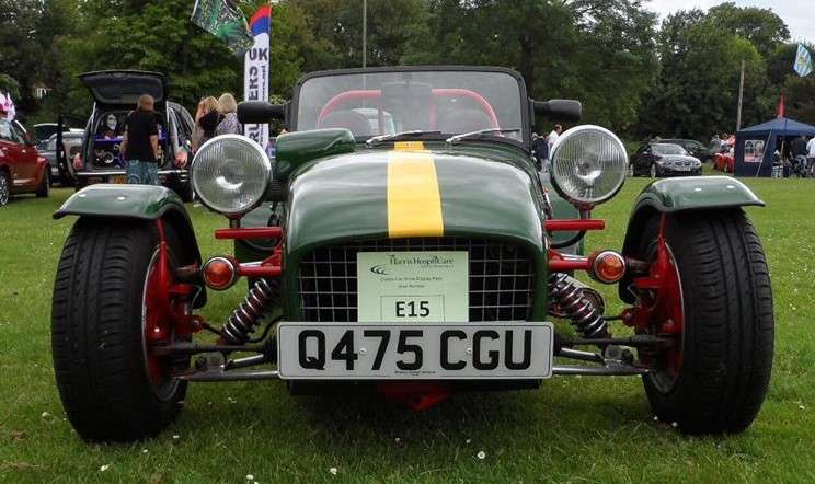

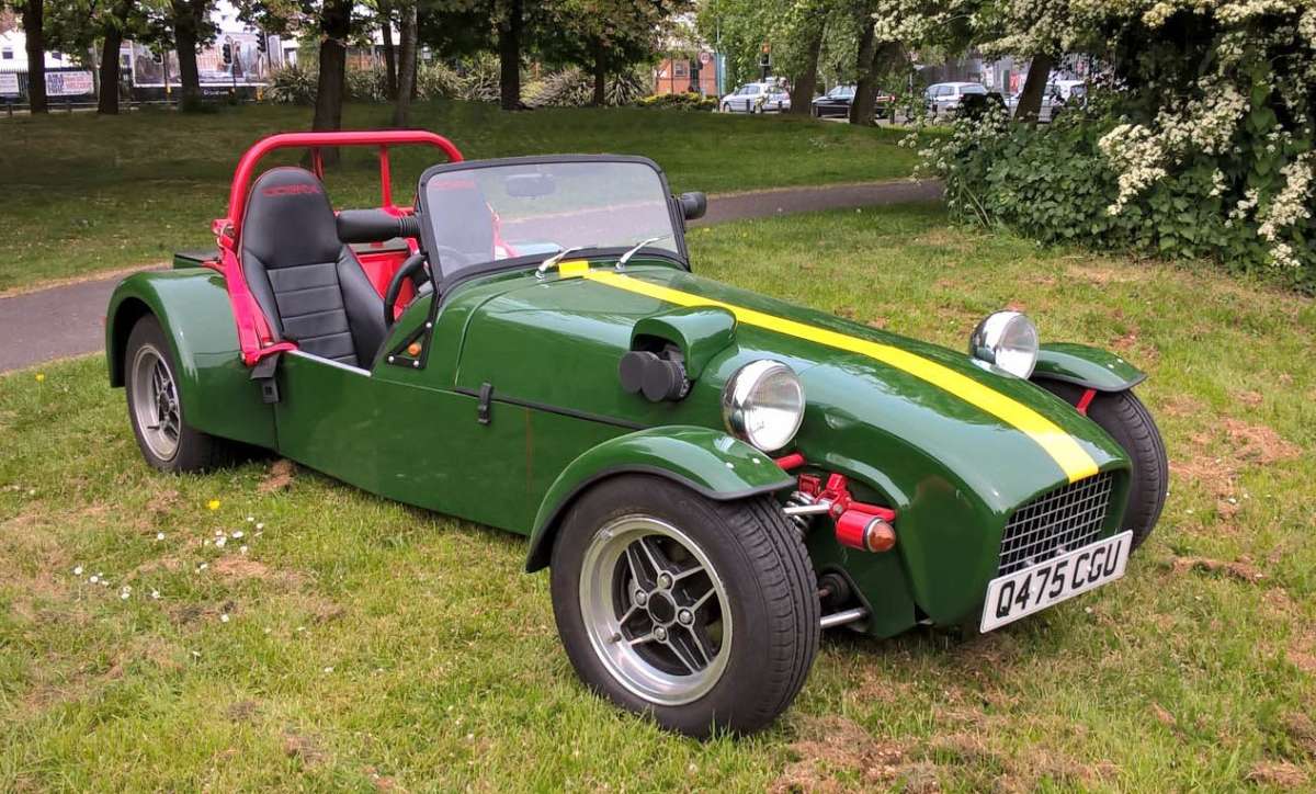

          David Marks 2
            @davidmarks2
            Not strictly my vehicle nor is it a motorcycle, but one built by my son under Dad’s supervision. The car was scratch built i.e. not from a kit but built following a book “Build yourself a car for under £250” by Ron Champion and published by Haynes. The donor car was a Mk II 1300 Escort which provided in the main, the engine, gearbox and back axle. The chassis is mainly from 1 inch square X 16 s.w.g. steel box section, clad in sheet aluminium apart from the wings, windscreen scuttle and nose cone which are GRP. My son was 18 when the build commenced and undertaking a motor vehicle apprenticeship. He was greatly encouraged by his college lecturers and obviously myself. I was lucky enough to have undertaken an extremely good apprenticeship in mechanical engineering with the MOD and for a good number of years trained apprentices myself, plus student and graduate engineers within MOD.  My son Michael was my final “apprenticemichael car (2)Locost2 (2)” and can now produce items built by hand in both metal and wood.
            #123908
              Absolutely beautiful, very much the look of a Caterham.  I was once tempted and went for a test drive in one and while the performance was as impressive as you would expect I wasn’t expecting the suspension to be quite so hard for road use!  I’ve never been in a car where my teeth did actually chatter together.
              At the end f the day did he build it for less than £250.00?  Does he still have it?
              #123915
                Your son made a cracking job of that under your expert guidance.
                  Talking of Ford based specials our first house was a modern terrace with the garages in a block at the rear without power or lighting. I can’t remember the name of the kit, but one of our neighbours built one in his garage – they were singles with not much room either side! Took him quite awhile but I was amazed when he wheeled it out of the garage and finally started it up. It’s amazing what you can do when you’re young. I’d want a fully fitted workshop nowadays with a ramp for the work I used to do on cars and motorcycles!
                  Richard –  Yes he still has the car. The only problem he has now is the fact that we live in one of the London boroughs so the car is liable for a daily fee as it is not compliant with the “low emission” requirements. However, if it was still an S reg. Mk II Escort it would be OK. The cost of the build was much more than £250. Ron Champion scrounged most of his materials for the original car, sourced seats etc from a scrap yard but like scratch building model boats the pleasure was in the build itself. Michael has great trouble when taking the car for an MOT in convincing the mechanic (sorry technician) that it was not built from a kit.
