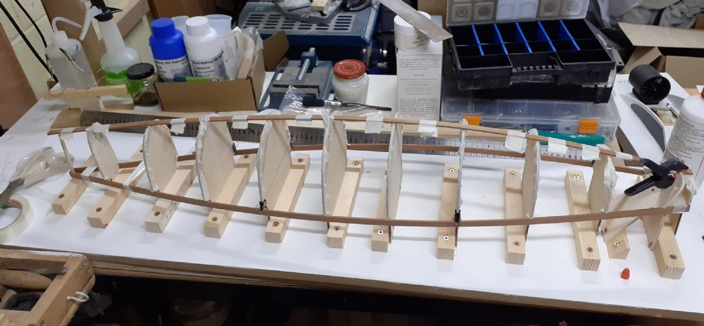

Hi. Brian, I found the run of the planks were easy after the first few around the transition from the centre line of the hull to the vertical stem, after that it was easy to put a full length plank about 3/8” wide in the centre tapered to approx. 3/16” at the transom and 1/4” at the stem.
The hardwood hull is around 400 grams over the minimum 4 kilos. The balsa hull with two layers of lightweight glass on the outside and one on the inside plus extra around the fin box is only a few grams over the 4 k.
Both sail well, the balsa one is competitive against a 2017 professional hull and the heavier hull is good in stronger winds.
I have used a Hitech 1/4 scale servo winch in the hardwood hull, but is too slow, so I have fitted a PJ sails one in the balsa hull, it is much faster and not as heavy, with postage it cost just over £100-00 from Frank Parsons at Nylet sails.
I hope this all helps and I look forward to seeing your progress.
