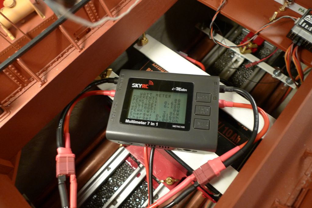

                          #60770
                            Martin. A wattmeter is moderately essential. They are so easy to use…you simply plug them in between the battery and ESC, tab the button (on most) and the display scrolls around showing you current draw, voltage, watts and so on. Very cheap, ebay does them,. Component shop sells same…
                            It is possibly the best way to set up a boat, as you can see from the performance how fast it goes, and then look at the current draw to see if the currents shown are translating into increased performance or not, when trying out different props and so on.
                            This sort of measurement sheds light on the fact that the performance MAY be about the same with say, a 40mm 3 blade plastic prop and an X30 twin blade, but the motor may be struggling to turn the X prop and so drawing more current (for an example)
                            Also allows you to judge performance and current draw for better run times, there may not be much of a difference between very fast and ever-so-slightly less fast with certain batt/prop combinations, but a big difference in current draw.

                                      #60790
                                        Martin. The most current draw will be at a standstill, so holding the boat still, putting on full throttle and looking at the reading will give you the worst case highest current reading.
                                        Once moving the water is travelling past the prop at speed and this lessens the amount of power required to turn it. Basically….. will not argue with anybody who has another idea.
                                        Some of the meters can be left in the boat and will capture the highest amp draw, so you can look at this when the boat comes in. However, things like motor temp and also battery temp should be borne in mind when assessing all this. To be honest I think this is all a bit deep for your application, and as long as the static current draw does not wildly exceed the spec of a comparable motor (say, a J.Perkins 480) and the motor gets no more that fairly warm or even slightly hot to the touch, you will be ok.

                                          #60795
                                          Banjoman
                                            @banjoman
                                            Martin,
                                            Re: wattmeters, the one I got is the SkyRC iMeter 7-in-1 multimeter (**LINK**), which does indeed go in the boat (or whatever) and which will record and remember (until it is deconnected) among other things the peak current:
                                            This is of course handy, as it allows one to get a peak current draw figure from actually running the boat, as opposed to holding it still. It is also possible to get a reading of current draw, but only by looking directly at the meter which of course takes one back to the holding-it-still scenario where current draw will be more or less the same as peak draw.
                                            As Ashley has already said, peak draw is very useful figure to know for configuration purposes, although I would not have minded also being able to know average current draw, as this would be a rather useful figure for comparison with peak when calculating potential run times.
                                            This particular meter also has an optical tachometer, a battery tester, thrust calculator, temperature gauge and battery checker, the only one of which I've used so far is the tachometer. The latter is of course primarily intended for air props, but did seem to work on a boat propeller, too; at least it gave me a reading in the expected RPM range, although I did of course not have anything to check the reading against. And of course that reading had to be taken out of the water, so the value of this particular bell-and-whistle for model boats is perhpas a tad limited. I haven't yet tried painting a line on (for example) the motor-propellor axis coupling to see if I could get a reading from there, too, but will have a go at that one of these days. If that works, it would of course be possible to check RPM's with the hull in the water, too.
                                            I'm not particularly trying to say that this thingamajig is the bees-knees, must-have, cat's pyjama of a wattmeter, and it is of course more expensive than a simpler one, but it has so far done what it says on the box to my full satisfaction.
                                            /Mattias
