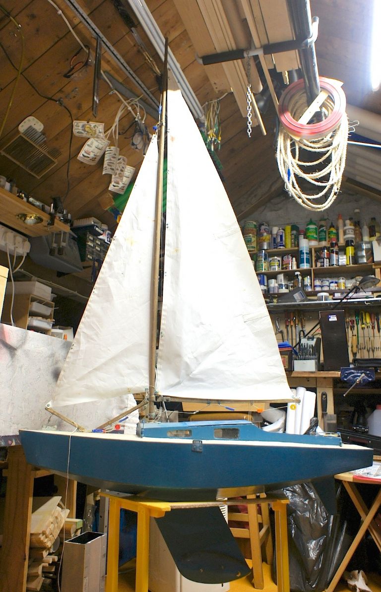

                    I've just weighed my attic dweller, and she's 5.15Kg. So adding all the "top hamper" [look it up] that's about 5.5Kg afloat, maybe 6 with bigger batteries.
                    And can anyone confirm that this is the type of vessel we are discussing, a poor photo I agree, but is this a "Starlet"? Now you have the size, do you think a small prop is going to inhibit her drift?

                      Certainly looks like a Starlet to me.
                      #51245
                        It does to me, too. Many thanks, chaps. I hope Peter is now following this.

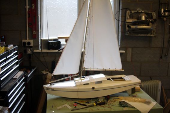

                          To answer Kim, yes, that is the Starlet and I have included a picture of mine. Now that you have looked at your dry docked model, do you think that there is room to put in a suitable motor? If so, which one, where and with what controls? Dave has suggested the alternative of making a new boat from scratch so if anyone has any suggestions for a plan or kit suitable for both power and sail I would be very grateful to hear them.
                          I am principally a "wood worker" so the only experience I have of electronics RC is from the 20 year old Starlet. Technology has moved on a little since then! Any advice about servos and control systems for this project will also be vey welcome.
