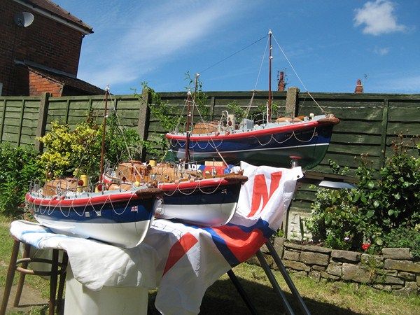

                            hi Stephen,
                            i have just noticed your question about running a Rother class lifeboat and what engines to use.
                            i have built many lifeboats in my last 25 years of classic lifeboat building.
                            i have designed 6 different lifeboat kits over that period of time, five of them being smaller classic lifeboats around and a little longer than the Rother.
                            so i'll list what i run them all on….and being a cheapskate i buy the cheapest i can on ebay.
                            i also run them on 12v X 3.4 or 7 amp hour Yuasa type batteries,depending on which fit in the boat.
                            2 x low revving 12v motors such as these motors on ebay….
                            Dc Motor Johnson 12 V/552 | eBay
                            2 x shaft couplings to suit the diameter of the motor output shaft and the propellor shaft. plenty on ebay either plastic or metal, similar to these.
                            model boat universal shaft coupling | eBay
                            2 x electronic Electronic Speed Controllers, best on the market are ACTION esc's and can be bought from Componant shop. they should have forward'reverse function and MUST be rated at 40 amp. contact iain, the company owner to discuss with him what esc is available.
                            Action Electronics | Component-Shop
                            2 x spade fuse holders [same as used in motor vehicles] these go in line on the red/positive lead from the esc's to the positive battery lead to protect the esc from too much power being taken by the motors should the propellor stall for some reason…..string or weed or plastic bags wrapped round the propellor.esc's are expensive, 20 amp fuses are not.
                            12V/24V STANDARD BLADE IN LINE FUSE HOLDER UP TO 30A WITH SIDE SPADE CONNECTORS | eBay
                            1 x 7ah battery,
                            NP7-12 12v 7Ah 20HR GENUINE Yuasa Lead Acid Rechargeable Battery NP6-12 | eBay
                            or
                            RMAAOSwLCdgGUXz">Power-Sonic 12V 3.4Ah Rechargeable Battery Caravan Solar Alarm Leisure PS1230 | eBay
                            my views are my personal choice, and is what i used on my fifferent classic lifeboats.
                            but this is an idea of what you need to get your model on the lake. 002 (copy).jpg
                            Edited By neil howard-pritchard on 05/02/2021 19:37:01
