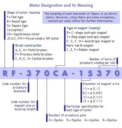

                                Here is a simple guide to Mabuchi motor designations – may help somewhat motor designation mabuchi.jpg
