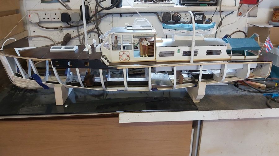

      I've managed to get bored with all my other creations so whilst wondering what I could do next I found a set of plans on the internet and thought… Hmmmm… like you do.
      I wanted something no larger than 1 metre in length (because I'd struggle to get anything bigger in the car) and this one came in at 1250mm or thereabouts so it had to be scaled down slightly. Not a problem and construction began in earnest. My preferred medium is plastic (shock horror) so all the various bits were scanned into a cutter and the parts made. I tend to use laminated 20 thou styrene which is strong but surprisingly light and easy to work with.
      I've already had a lot of help and advice from various people on another site (which shall remain nameless) but for reasons of actually daring to have an opinion about something, I was summarily banned. If anyone here was a contributor to my thread over there then I'd like to thank them for all their assistance.

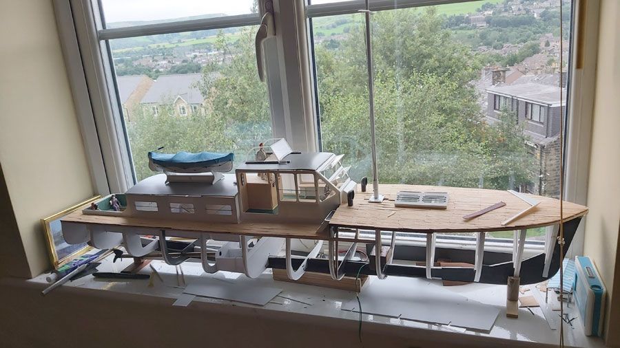

      Anyway, the build so far:

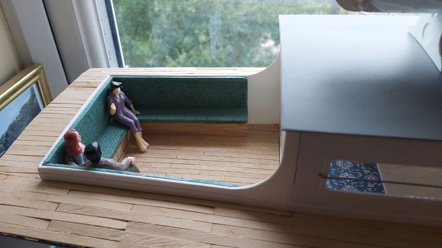

      The superstructure (which is removable at this stage) is almost complete, the motors, radio gear and battery are in the garage waiting for me to decide where to place them. I intend to sort of plank the hull using long 4x2mm balsa 'planks' with a coat of epoxy on the inside for both strength and waterproofing.
      More bits:

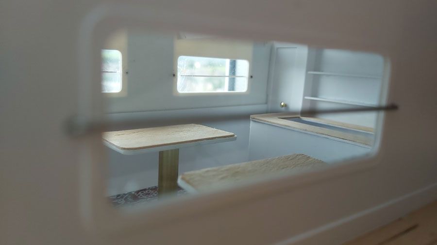

      The rear cabin bar/lounge area. This will eventually be populated with G scale figures and properly stocked and illuminated.
      The rear sun deck area. This area will have a 'canvas' canopy draped over it eventually and maybe a table.

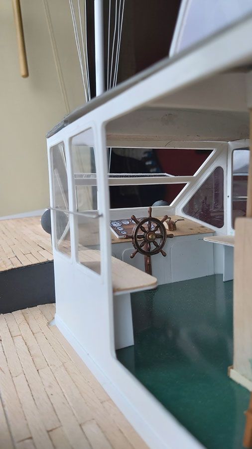

      The pilot house. All but finished with real wood cladding on the walls. Chintzy.

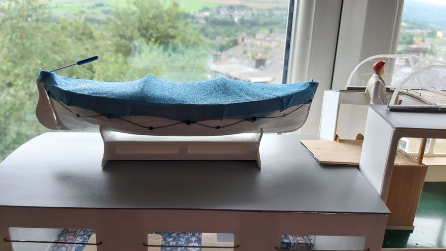

      The other boat. Not sure what to call this really. Is it a lifeboat? Is it just a get you to and from boat? Whatever, the basic shell is one my great uncle built about 50 years ago. All I've done is pimp it up a little with a rudder and a tarp.
      That's it for now. There's lots more bits and pieces to do, not least of which is clad the hull and sand off those very rough deck planks but that's for another day.
      Thanks for reading
      Andy

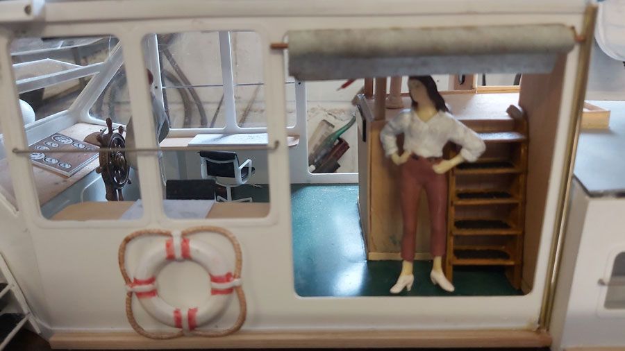

                    So I've finally made a start on planking the hull and what a tedious job it is too – put a few pieces on, wait for the glue to dry then repeat ad infinitum….
                    So in the meantime I've been playing with more interesting stuff such as…
                    replacing the wholly unsatisfactory wooden deck with a more aesthetically pleasing plastic one.

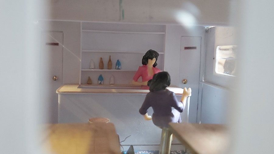

                    Stocking the bar…
                    Building a tent…
                    and figuring out where best to put the gorgeous Ellie.
                    All these bits are currently still removeable so that when I eventually finish building the hull I will still have easy access to the interior for waterproofing and ballast etc.
                    I do have one slight problem though. I set the aluminium plate (1st photo) to mount the motors on at the wrong angle and consequently the motors/propshafts are binding. Not good but easily fixable.

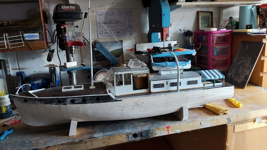

                          So with all the superstructure removed, hull planking began in earnest today.
                          One side is almost complete and I've done about 2" of the other side. This much has taken all day….. it's going to be a long job.
                          My plan is once it's all planked then I will sand it all smooth-ish then cover & dope(?) it. Once I'm happy with that I'll skim it with Isopon and resin the inside.
                          Any thoughts on this plan of action? I'm open to suggestions.

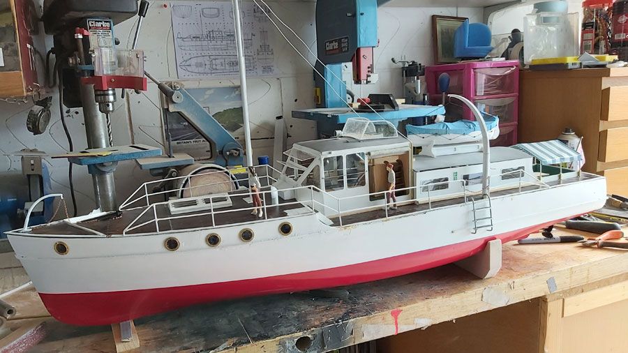

                              So. Latest progress pictures.
                              As usual, superstructure & fittings placed for photographic effect. There is still a lot of filling/finish fitting to do on the hull itself but it's getting there.

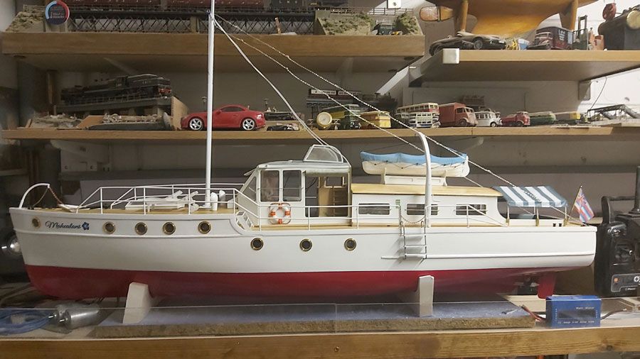

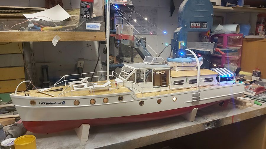

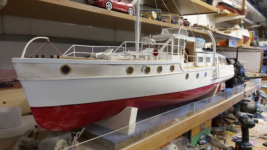

                                The other day, messing about in the garage, I decided that the dark wood (plastic) deck didn't quite look right so I replaced it with a more convincing scribed wooden one. I also noticed that I'd missed 6 portholes so I rectified that too. Whilst I had the bit between my teeth I decided to tackle a few other niggles like the electrics and the lights which are now controlled by the radio.
                                While I was doing all these various things, I remembered that I'd stolen the motors from this boat to put in Pecola, another of my project boats. I'm currently awaiting delivery of two replacements before I can go any further.
                                So this is what she looks like now. Just short of a new coat of paint on the hull, a new roof for the rear cabin and some fancy lettering.

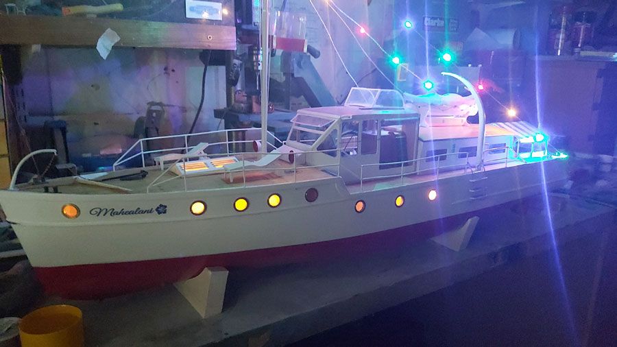

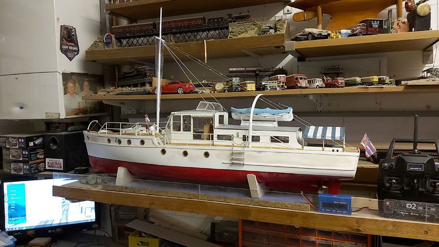

                                          About a week ago I decided to tackle the coat of paint that was needed on the hull. I ended up with a beautifully smooth glossy white finish that was practically perfect in every way. I was really pleased with myself and thought – I'll finish that off nicely with a coat of protective lacquer, like you do.
                                          Disaster!
                                          Some sort of reaction between the paint and the lacquer and everything bubbled off. Not happy, I had to strip it all back and start again. That's all done now and this time I'll be using yacht varnish on it. Well it is a yacht, innit? What could possibly go wrong? (I have sandpaper and new paint on standby)
                                          This is how she looks now, complete with party lights party
                                          #92074
                                            Great job Andy. Good detail, like the people, like the tent at the rear. Excellent.
                                            NEVER overspray different paints without testing first (but you know that now!!)
