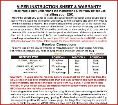

                                  Has anybody out there experienced problems with their motor drives, by not cutting the wire, please?
                                  #59211
                                    Are all of your red wires connected to the RC
                                    #59212
                                      "CAUTION!" (Red text) – Third line et seq.
                                      #59213
                                        Yes……All the wires are connected
                                        If I cut the wires to three of them, I would not be able to run an individual motor, without first connecting the intact wire
                                        At the moment, I can run any of the motors…….Which has been handy lately
                                        #59214
                                          Your wiring is obviously working and yet it contradicts the manufactures recommendations so you will appreciate the concern especially if someone else follows your example and destroys their expensive electronic equipment.
                                          To put everyone's mind at rest could you explain how you wired up your motors and perhaps you could include a wiring diagram.
                                          #59215
                                            Bob,
                                            As Dave says, this has been explained on numerous occasions. Each red wire is a separate power supply from the speed controller to the receiver. In an ideal world, when using more than one speed controller the outputs will all be identical but because of various factors including manufacturing tolerances the separate loads being placed on the speed controllers by the motors etc., in practice the supply voltage can fluctuate and because everything is interconnected there're is a very real potential for the electronics to become unbalanced and generate unwanted feedback as a result of which one of the components may get fried. It obviously makes sense to power the receiver from one power source, either a separate battery (my preference) or one speed controller.
                                            In a sense you are already experiencing a not dissimilar problem with your twin motor one shaft setups. The two motors should perform identically but in practice they don't because they have differing manufacturing tolerances and the pole positions are probably out of synch so they don't act exactly in unison when power is applied. They are fighting each other.
                                            Your setup may indeed appear to be working OK but what you can't see is the internal stresses it may be putting on the electronics. When the device self destructs the manufacturer gets blamed which is why they use red ink in the instructions as Dave has illustrated above.
                                            #59216
                                              Many thanks, Dave…….I only wanted to know the reason, so that I could decide whether to cut the wires or not
                                              Having Googled the question…….There were so many people asking the same question and the replies did not highlight a hazard
                                              The club expert, says, cutting the wires is good practice and agree`s that I seem to have got away with it!
                                              Sorry David Marks 1……We seem to have messed up your thread
                                              Shall we vacate?
                                              #59217
                                                PS: If you want to run the motors selectively then just use a separate receiver supply, you only need 4 AA cells for that. Then you can switch the motors in an out to your heart's content.
                                                #59218
                                                  Many thanks Colin……..For your posts
                                                  I`ll give all the posts much thought and make a decision shortly
                                                  I`m hoping something will come out of this, when the time arrives…….Some manufacturer will give the matter some serious thought and declare that the difference between similar ESC`s is so minute……..There is no problem after all!
                                                  It`s possible
                                                  #59219
                                                    Well, it may be possible Bob, but 100,000+ ton cruise ships not infrequently suffer total electrical blackouts due to their 'speed controllers' getting their electronic unmentionables in a twist when trying to balance the loadings on them so what hope is there for a £25 model controller made up of a few cheap Chinese components?
                                                    #59221
                                                      You have spent a year and a lot of money building a large and impressive model boat, yet you have chosen to ignore the advice of several folk on this forum and also gone against the instructions of the ESC manufacturer. This could (but not necessarily will) have consequences.
                                                      The first one of these is that it invalidates the warranty. Whether or not that bothers you is your concern only
                                                      Secondly, MTroniks ESCs are known for catching fire for no obvious reason. I have had several customers who have experienced this. It's lucky in your case that the input voltage is only 7.2v, so the power dissipated by the regulators in the ESCs is pretty small. However pitting the output voltage from one regulator against another – and then multiplying the risk by two – does nothing to reduce the chances of a serious fire.
                                                      This isn't my model and frankly I really couldn't care much about its fate, but I feel that I would be called to account if I hadn't said or done my best to dissuade you from such recklessness. It would take the work of maybe a couple of minutes to disable all but one of the ESCs, in line with MTroniks' instructions. I'm not sure what point you're trying to prove but it won't be on my conscience.
                                                      Do what you like, Bob; it's your style – for better or worse.
