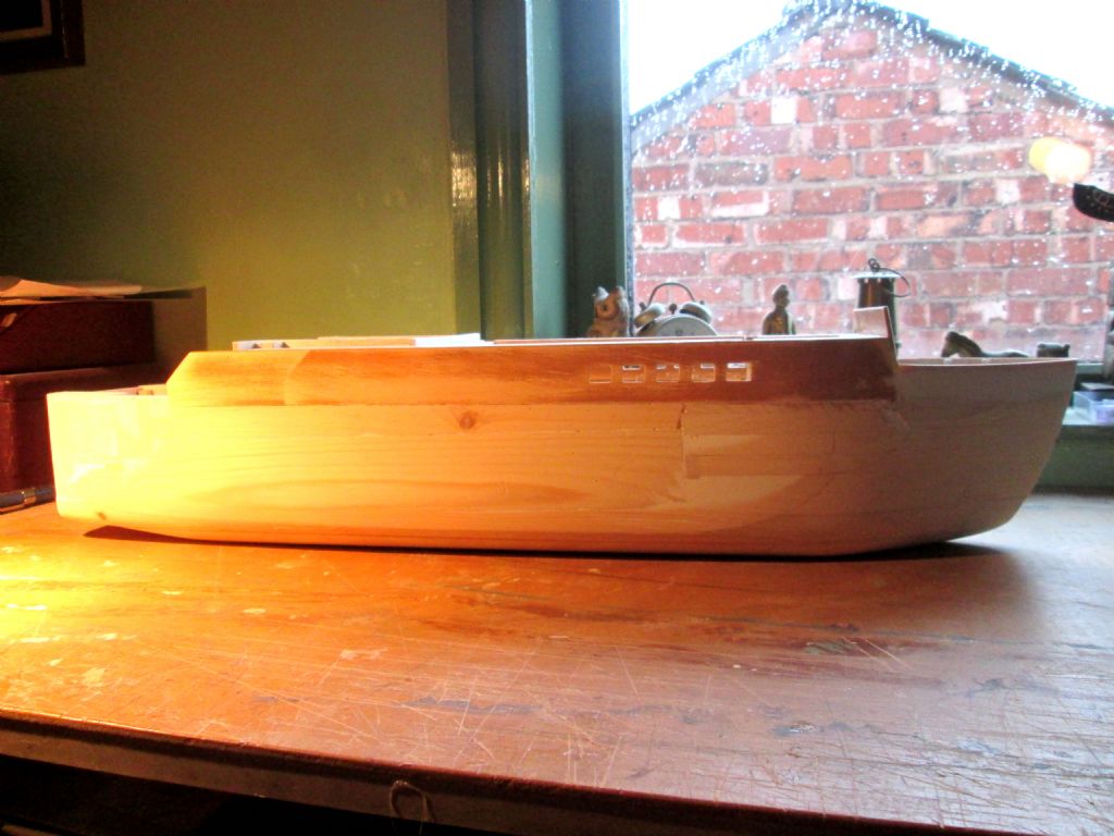

      hull.jpgWell made a start, its now time for sanding sealer for the hull.
      Spent a few days trying to get a good set of plans but nothing about, so set off with a few pics and a sketch from the side to be going on with.

          43:. Good man. Working without plans is very rewarding, and as long as you make a reasonable job of it, no one can gainsay you, as there are no plans to compare with. Certainly true of half the things I build!
          ​Although there may be no actual plans of your vessel, things like fittings will be generic for the period of course for the detailing.
          ​Do you have any measurements of the real ship, as this is usually of great help…..failing this, scaling to persons in a picture is a good method.

            Yes it does feel good, to have seen a sketch of boat deck and a set of dimensions about length and beam. So away I went, a few pictures and as you say people are a good indicator of scale worked out to be about 1/76 so hopefully train stuff will be ok.

                                whoops already found a bit of a differance from the first drawing. and after study of photos made my first modification. so not a big one to differ from original.
                                yes think it will only look the part, think it would be too difficult to follow at this scale and no drawings so a close 'looking the part' it will be ok from the side of pond hopefuly .
                                next problem is the ramp hinge had thoughts about use of a strip of cloth no doubt it could be hidden and not seen after painting and the like

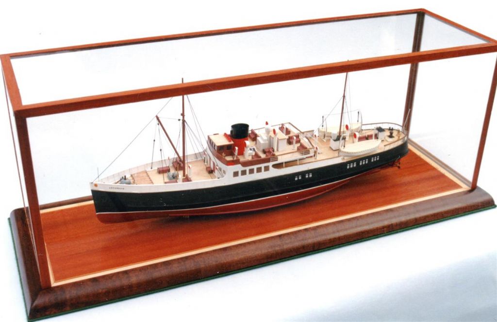

                                        Last year, I produced a series of downloads called The Shelterdeck, containing historical notes, model constructional notes and various nautical articles. They are about 16 pages in length, and each contains a ship plan. Each issue took me between 7 and 8 hours to write, so there is a nominal charge of £1.49 each (less than the price of a cup of coffee). Interest in these articles steadily declined, so I eventually discontinued them after just over a year, but they all remain available. The plans of Lochnevis are contained in this one: **LINK**
                                        If you click the link, and scroll down a bit, you are not committed to purchase, but may read the synopsis. Then, if you wish to purchase the download, a Paypal/credit card button is provided.
                                        I am not a business, or a plans service, being aged 73, but a retired seafarer, whose hobby is writing, and building ship models. Please see my photo album here on Model Boats. Here is a photograph of my model Lochnevis, built from the plans in The Shelteredeck.

                                          I may be mistaken, but I think that Dave's model is of the current Lochnevis (**LINK**), whereas yours looks like an older ferry with the same name … ?!

                                            I didn't know there is a current Lochnevis, but looking at your link, there are three large windows and two small ones on the side. In Dave's model, there are five, all the same size, as in my older Lochnevis shown above. No doubt Dave will clarify which one presently. If it is the present one, I doubt whether plans will be made available, even though they will exist, because of security!

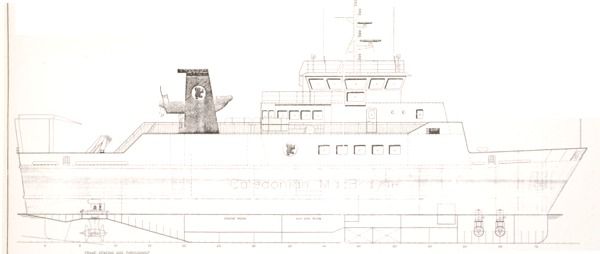

                                                lochnevis (5).jpghi all
                                                yes its the current one I am working on, and yes had to sort out the windows, but this is what happens when you get drawings from ships of calmac …not realy as is. so windows are now sorted ready for painting of the hull and working on the ramp now, so hope i dont come across any more fopars. at least as easy to remedy as the windows.
