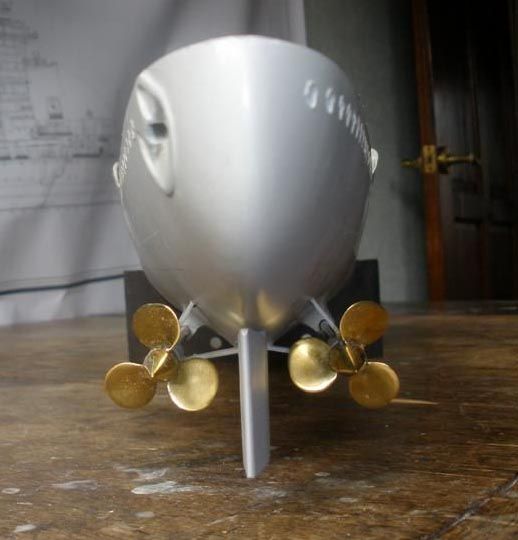

              Your in luck here, Paul
              Thanks to our old friend Andy Hustler, he has posted a picture of his Graf Spey props and it`s just up your street!
              Right hand prop on the starboard side
              Thanks Andy

                  I think Paul is referring to the hand of the props, Dave
                  Yes, Bob – that I understood and my post indicated, in what I hoped was a positive way, that Paul's interpretation was absolutely correct. This has subsequently been shown to be fact – in accordance with Andy's photo which you posted.
