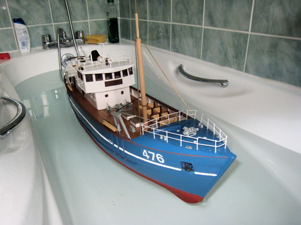

      Boat close to completion and weighted down with about 1 kg of lead to float on an even keel sloghtly above the water line.  All looked OK until, a few hours later, I noticed water dripping from the keel.  Tipping the boat upside down, a fair amount of water came out and here is
      a  split between the keel and the first planks towards the front
      of the hull. Looking inside, the PVA glue used to attach the planks has turned white – a sign that it is wet?  I am paying the price for my intial error – that of fixing
      the deck in place before planking the hull. One side at the front,
      forward of my battery hatch, was not accessible for coating with epoxy.
      The rest I did coat. What to do now? First I will dry it out overnight and hope that none of
      the planking becomes so distorted by wetting and drying that the hull
      starts to split. Hopefully, the two coats of epoxy resin on the outside
      of the hull will be flexible enough to counter any slight stresses.
      Next, I will strip the paint along the base of the keel and add a
      really thick cost of epoxy. I might then varnish over the Halfords red primer with a matt varnish.  I could try to spray the inside of the
      front of the hull with a varnish – holding the boat upside down and
      spraying through the battery hatch. Any ideas or suggestions would be
      appreciated – I don’t really want this to become a static model only.
      Jeremy

        #25714
          Drill a hole in the deck and pour varnish in………then roll it about
          But dry out the hull first………….Bob

                            Thanks for the comments.  I didn’t see any evidence of water coming in through the propshaft (which is greased) or the rudder tube which is above the water line..
                            I think the problem is at the bow end where I was unable to epoxy internally on one side because of my initial mistake of fixing the deck in place before planking – never again!  The rest I could access through hatched in the deck.
                            The planking wasn’t perfect as you will see on my photos but I had hoped that two coats of epoxy resin would have sealed any gaps.  With the resin in place and overpainted below the waterline with Halfords red oxide primer, there were no visible cracks.  The only one which has opened up is along the bottom of the keel where the first plank on either side is fixed directly to the keel former – in hindsight probably with gaps in the glueing.
                            I have now added a third coat of epoxy in the suspect area and will re-apply the primer.  I will then seal that with varnish.  I have acrylic varnish in a spray can – will this waterproof the primer ot must I go for a solvent based varnish – polyurethane?
                            The hull is now completely dry and I will try to cover the bow end internally with varnish as discussed in earlier postings.  Hopefully that will solve the problem.  It is my first plank on frame boat – indeed my first boat of any sort for probably 15 years.  We live and learn – helped in no small way by the contributions on this forum.

                                What a relief!  Hull now watertight after additional epoxy coat at the prow, double coat of varnish below the waterline, varnish swilled interior at the prow and epoxy flooding the join between the planking and the keel at the stern andsealing the propellor tube at its point of entry to the hull..  Thanks to all for their advice.  I will never never again fix a deck in place before complete waterproffing of the inside of the hull and successful leak testing.

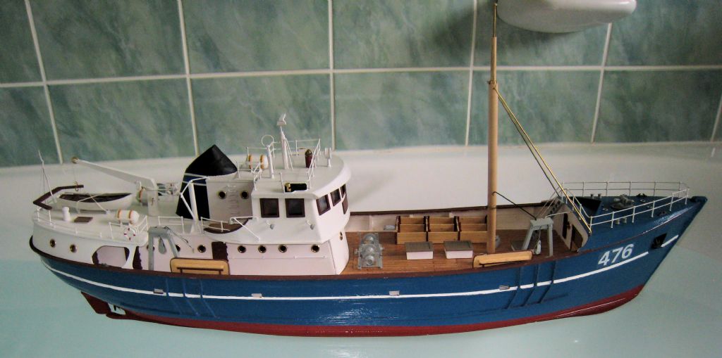

                                    Maiden voyage successfully undertaken.  Now to take to the open sea or at least to a nearby lake.
                                    Jeremy
                                    #25876
                                      Very nice looking boat Jeremy. Glad you appear to have got her sorted out.
