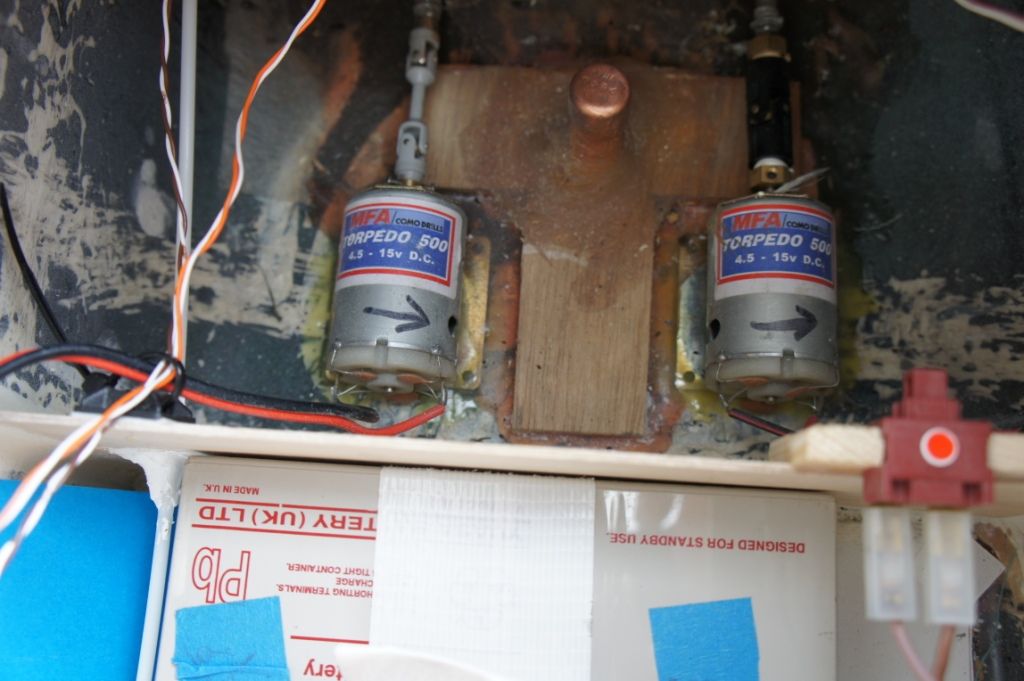

                          Hello Paul,
                          when I built the Sea Crusader (Celastine) she was poered by two MFA Torpedo 500 motors, both run off a 6V large gel battery [about 12Ahr] and she would run all day. She was about 6feet long.
                          Sea crusader
                          I had to add ballast, and added it using a bolt on keel beneath the hull made from solid copper buzz-bar. You can see that in this image. It weighs in about 5Kg and is attached with two bolts up through the hull.
                          Sea Crusader
                          To this day she has never turned over, and I have sailed her with some success in competition.
                          Kim.
