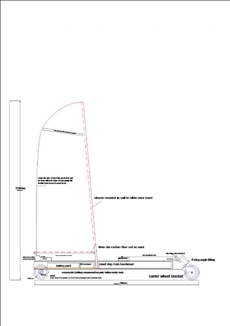

      A chat about land yachts with my old friend Micheal has had me thinking about the problems associated with building a model version.
      This is a quick drawing of a land yacht based on a length of plastic waste pipe and skate wheels.
      Nice and cheap to build and should be fun to 'sail'
      Edited By Paul T on 06/03/2018 19:57:00
      #7127
        #76188
          I chose the skate wheels because of their ability to grip on hard surfaces and the 6200zz bearings in each hub (these bearings are deep grove ball bearing and benefit from metal shields protecting the moving parts)
          TOOGOO(R) Skating Shoes 608ZZ Bearing Inline Skate Wheel Clear Gray
          The plastic waste body is strong, light and easy to work with. I angled the front steering wheel for better performance and tighter steering at speed.

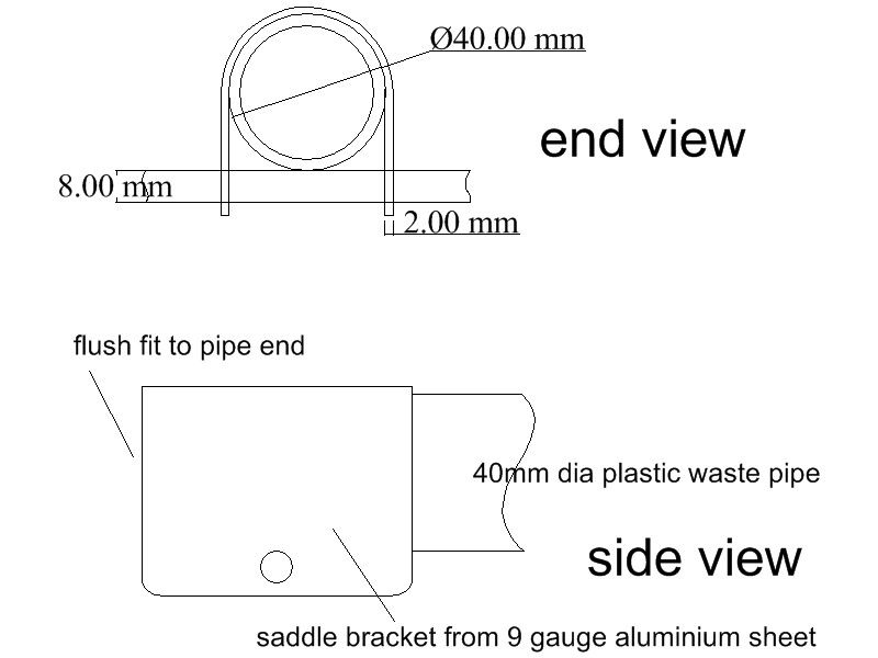

                  These are the details for the rear axle supporting saddle bracket.
                  Its a simple saddle bracket and could be made from any mailable metal or even an adapted plastic plumbing bracket, I specified the overall length at 70mm to minimise twist but this could be reduced to suit any available material.
