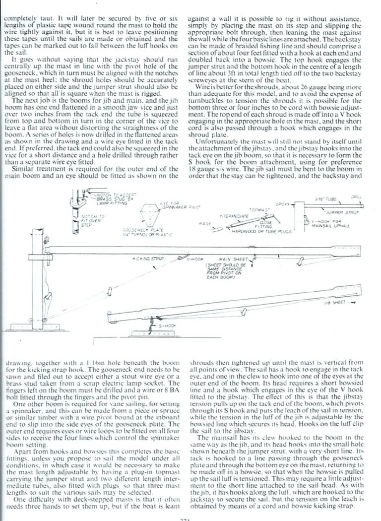

              Part 1 of the magazine items will be in the magazine which you have bought. Part two is missing from my collection, part three is below.

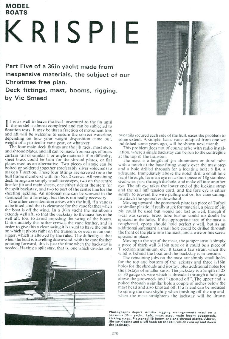

              #63324
                Part 4 is missing, part 5 is below.

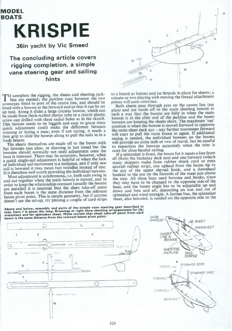

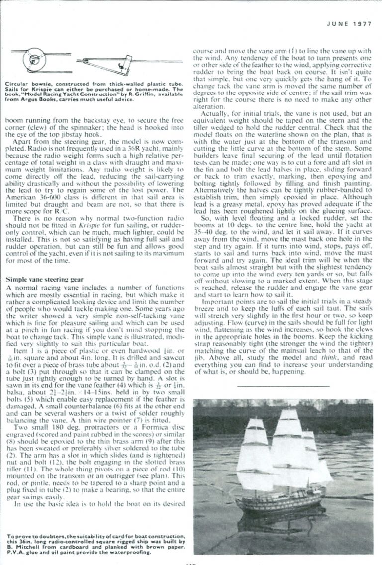

                #63326
                  Meant to mention earlier – part 2 was the January 1977 magazine, part 3 was in February 1977, part 4 was in March 1977, none in April, Part 5 was in March 1977 and the conclusion was in June 1977.
                  The June 1977 concluding article is below.
                  #63330
