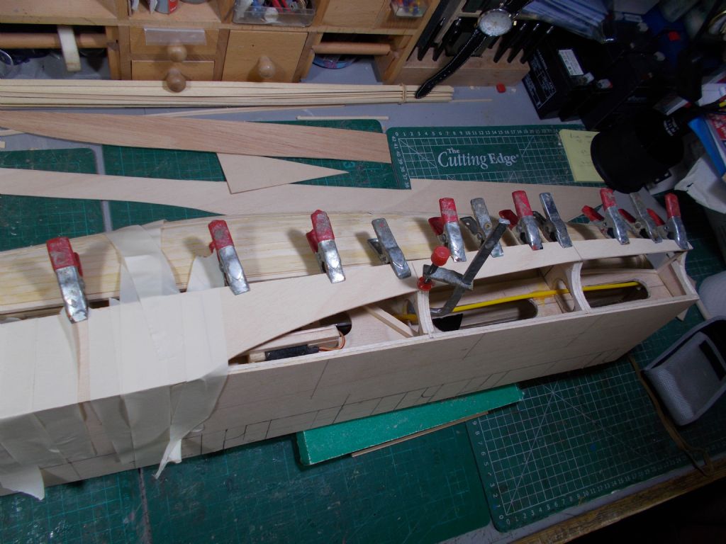

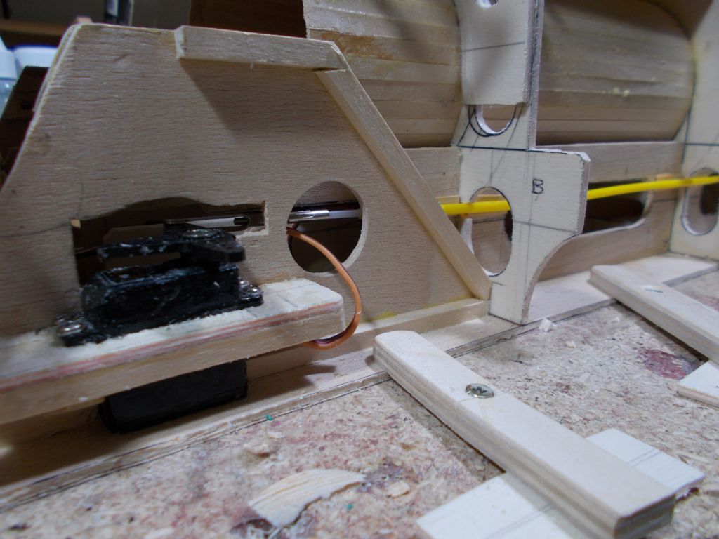

        bb2 (2).jpgjust to pick up where Ashley left off on a previous thread – it took me a long time and a lot of searching to find out what you actually call those wiggly pushrod thingies – cos I needed one for my latest project and I ended up searching on the aircraft forums to find the correct name – SNAKES – Flexible snakes at that.
        Here is a picture of mine, the one I am using, which at some point will be semi-submerged and require sealing. I am going to inject a small amount of grease into the sleeve before inserting the inner flexible push rod.
        Ashley may pick up on the model I am currently building, as he has already built one similar.
        Mine will either work or be a brick – a slow brick
        John

              Andy, are you able to see the picture I included? The bellows is at the bottom of the opening. If you can't see it let me know and I will take a better shot.
              This is the type of thing I am referring to:
              Linkage Bellows
              With that one the aluminium spigot is bonded into the hull to provide a good seat for the large end of the bellows to sit in, which can then be tightened up with a miniature cable tie. The linkage then sits tightly in the small end and can be secured with a spot of silicone. The bellows simply expands and contracts with movement of the linkage rod.
              As I mentioned, just another option.

                Thanks for your help, I can see now from your pic John after Ashley described it, Very neat and tucked out of the way nicely. I like the Idea of yours Richard it would do nicely, I have another solution though, A gland nut and packing, it would have to have a solid outer casing but that shouldn't be a problem, If the overseas postage wasn't so slow I would like the bellows though. Thanks for your help.
