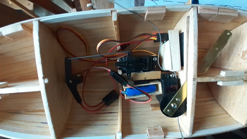

        The inside of the boat before gluing the deck:

          At the bottom of the photo is the sail arm servo, an inexpensive 180 degree one.  I cut a slot in the bulkhead just forward to allow the full movement of the arm.

            Nice neat and tidy construction. Just be sure that nothing catches you out and you cannot access it after the deck is attached.
            This tends to happen when you make modifications to a plan and you haven't envisaged every eventuality!

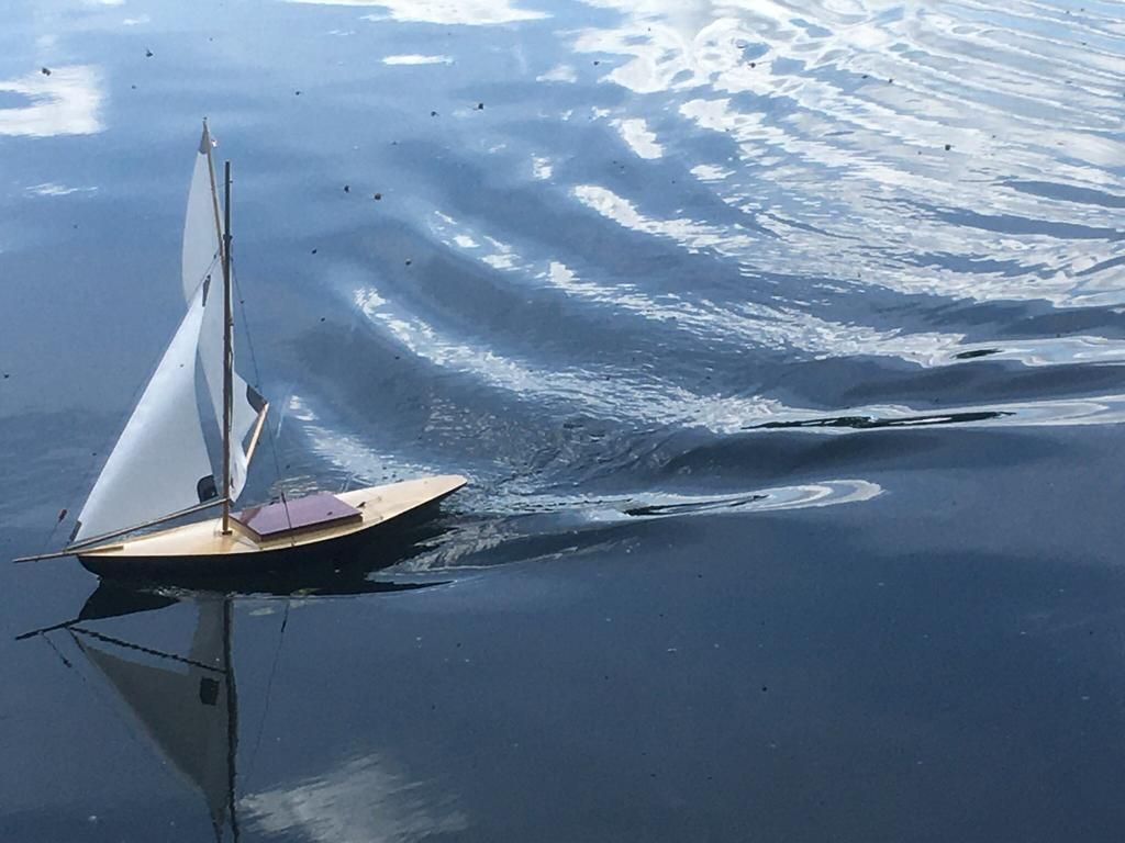

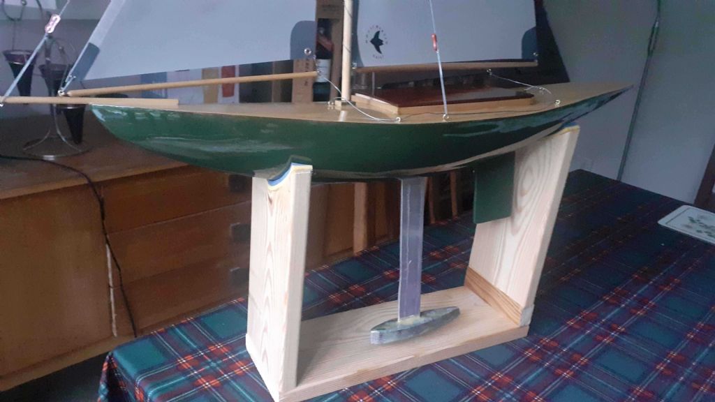

              Here is the finished model showing the fin keel and the larger rudder:
              and the boat sailing:
              I'm pretty pleased with the performance although I have no way of comparing it with the original design.
              Richard, you are so right! My problem was that, when the sheets are eased the slack isn't necessarily taken up, especially in light winds. The sail control strings could then get tangled with other parts, e.g. the rudder servo. My (rather Heath Robinson) solution was to insert a piece of thin card to separate the sail control mechanism (which is higher in the boat) from the rest of the stuff.

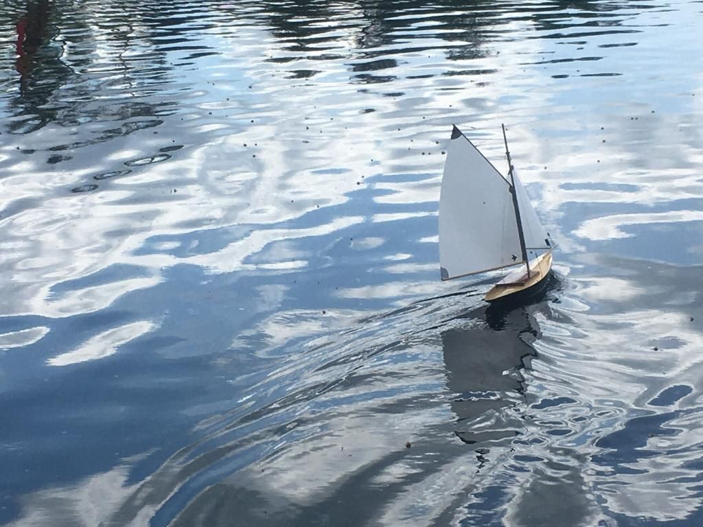

                  Here's another

                      Thank you Tony for your kind words. I haven't got any photos of it sailing to windward but it makes good progress in lightish winds. The gun'l has certainly got wet. However it remains only suitable for fairly light winds; the sail area is quite large for the size of hull.
