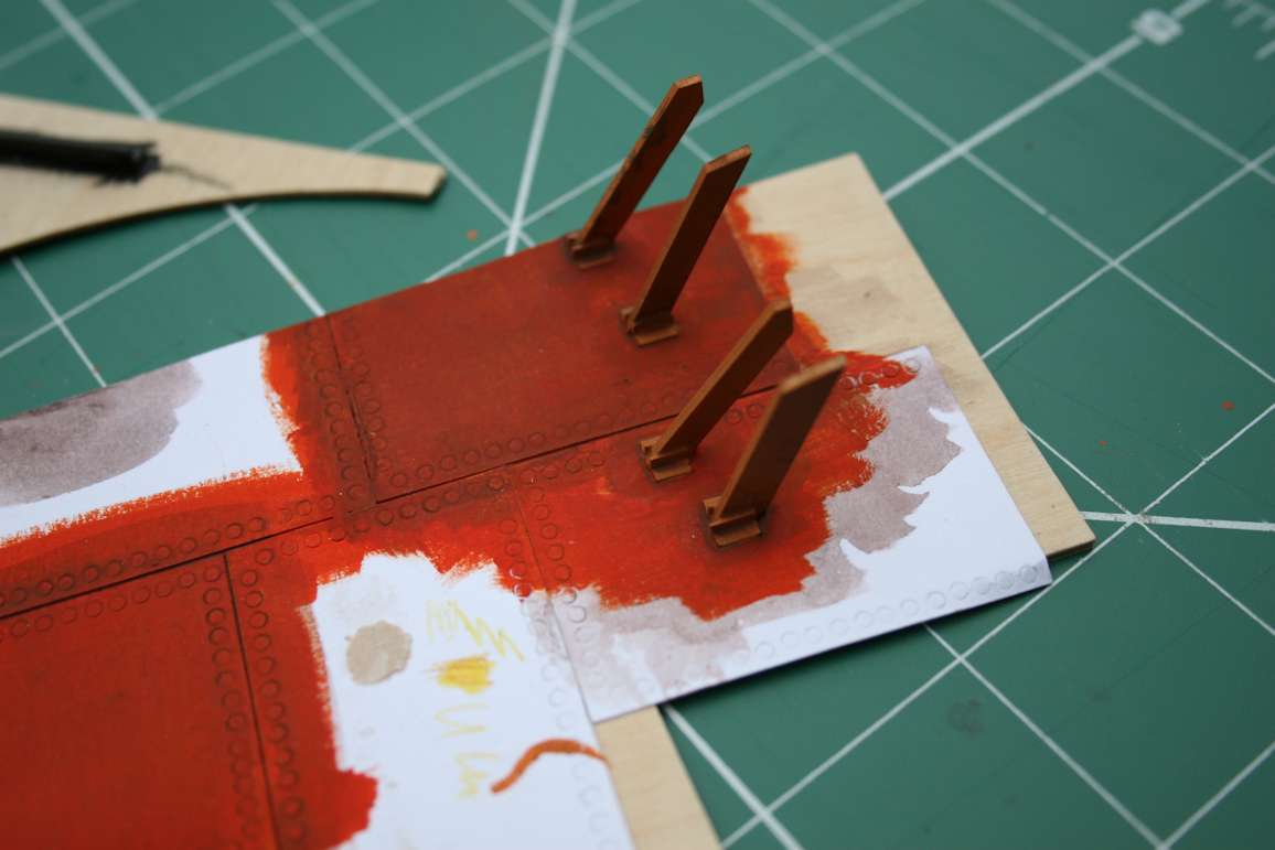

                            Paper works well for simulated plating.  I use a heavy paper, what I would have called Cartridge Paper.  This has had flush rivet detailing added as well:
                            17-02-09-04WeatheringArticle14
