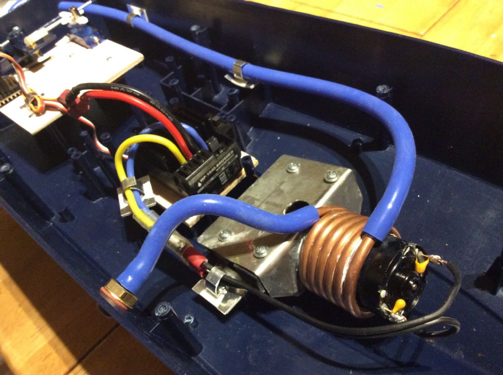

      I have got a speedboat that I adapted from a toysrus toy.
      The motor is an MFA 380, and it is water cooled because the hull is sealed and has no venting at all. This has been fine so far and the cooling coil never gets significantly warm. It runs off a 7.4v lipo and the prop is 30mm.
      After a brief session this morning there was a whiff of smoke from inside the boat when I opened the hatch to switch it off.

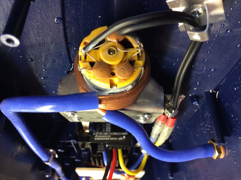

      Nothing seemed to be that hot, but when I got it home and investigated properly I found that the motor end cover had melted a bit around the bearing:
      I am pretty good at oiling stuff so was surprised about this. Am I just toasting the motor and expecting too much from it, or do I need to maybe introduce a bit of air cooling here? Should I perhaps just whack a 540 into it?
      Thank you for any suggestions.

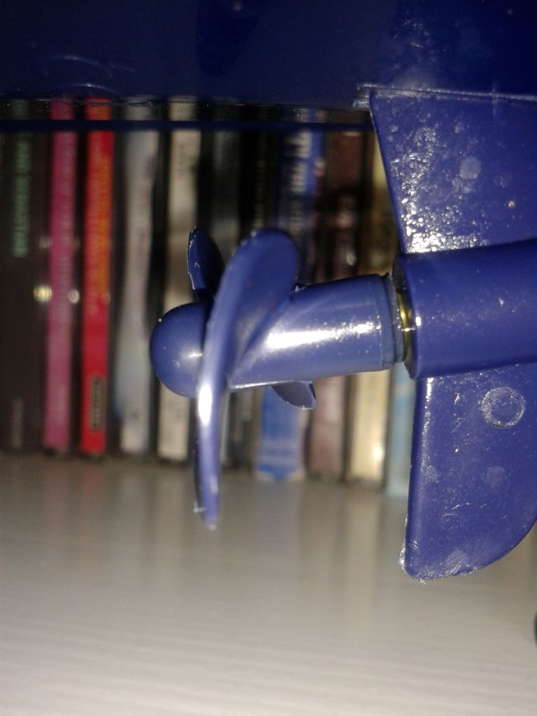

                                Re the prop, its not a "normal" X or S.
                                It's the prop and shaft as fitted in ToysRus's high technology production facility, thus:
                                30mm across. Do you think the profile is OK?
                                #73029
                                  Noel
                                  That doesn't look anything like as coarse as an X prop – you should be OK with the earlier caveat about keeping below 10A.
