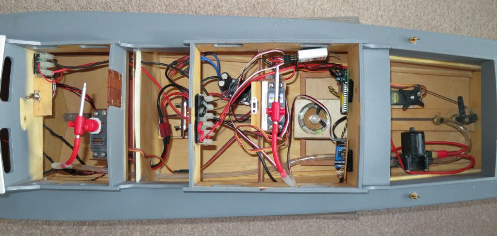

      vosper-3.jpgI have been using a HobbyKing 100 amp Quik seies car ESC with a Turnigy D3536-6 brushless motor and a 10 pack NiMh 5000 mah battery. The input voltage of the motor is 7.4-15V (OK) and 4-15V for the ESC(also OK)
      However, the ESC keeps cutting out when I throttle up. Sometimes it will restart. Sometimes not. I have had this model for some time and earlier on it worked OK. Any ideas on solving this problem would be appreciated. I could switch to a water-cooled marine ESC and link it into the plumbing of the fire monitors, but would hope not to have to do this.20150123-img_0822.jpg

          Without giving it much additional thought this sounds very much like "brown-out". Throttling up will cause a sudden surge of current and consequent drop in voltage at the battery pack. If that voltage drop is significant then the Rx will think you've switched it off and go to failsafe. As soon as all that happens the load comes off the battery which then powers everything up again! Or not…
          My suggestion would be to replace the NiMH battery pack with an equivalent voltage LiPo pack. In this case that would be a 3S pack. Go for the highest discharge current available. This is indicated in the specs for the battery pack as a value which looks something like "35C". That means that the pack can deliver up to 35 times its own rated capacity. Translate that into Earth-speak and a 4000 maH pack described as 35C discharge capacity will handle up to 35 x 4000ma, or 140Amps. I don't know of a NiMH battery that can get anywhere near this. Don't confuse this with the maximum charge rate, which is also quoted as C but will be a much lower value.
          This pack is described as 35C discharge and 5C fast-rate charge. If you look at the technicals you'll see it will deliver 140A continuous discharge current (4000ma x 35) and take a maximum charge current of 20A (5 x 4000ma). **LINK**
          The reason why your model used to work OK but now misbehaves is probably that the NiMH pack is being regularly overstretched and therefore losing its capacity to deliver high currents. A few slow discharge/recharge cycles may improve it but I'd still go for the LiPo option if 't were mine.
