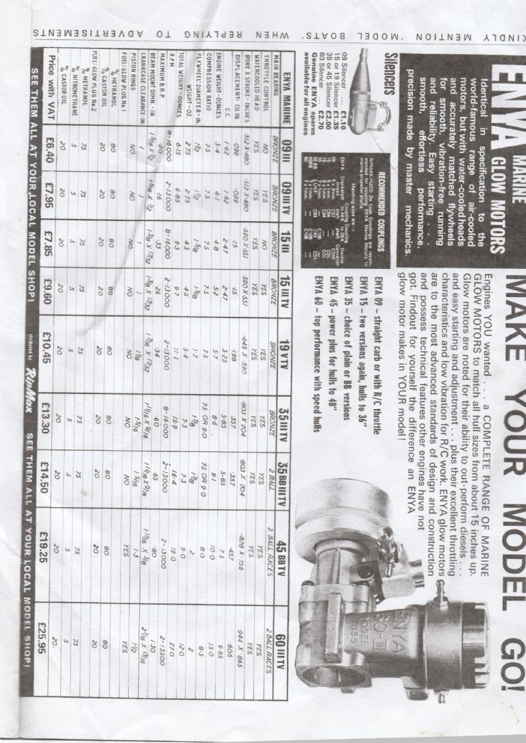

                  hi there Rich
                  Sorry I am 'late at the table' as the saying goes.
                  It has taken me quite a bit to find the information about the Enya engine. If you download the document, you will be able to expand it and read it better, I think.
                  As has been said beforehand, the main drawback about using I.C. engines in model boats these days – is finding a lake which will facilitate them (without any complainers) if you know what I mean.
                  To be honest with you, I have found that there is more spillage/oil slick from the stern tube on the model than there is from the exhaust on the model.
                  Good luck.
                  John

                    Oh thanks John, I will print that off next time I am in the library. My computer/internet stuff is extremely basic and will not interconnect. I will ask send to sosam on Cox engine forum who is an Enya fanatic.
                    Thanks again, much appreciated.
