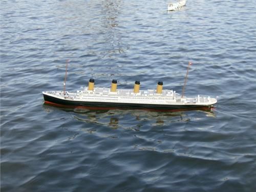

            Andy. Welcome to the forum.
            I have an (very) approx. 1:200 Titanic (4 foot long) and I have used three MFA 385 motors on it. They all run off a single 20A Mtronics esc, on anything from 6 to 10 cells Nimh battery (whatever I happen to have charged up, with added lead of course). I have brass 3 blade 35mm props on the outside and a 4 blade brass 30mm on the centre.
            Built years ago and runs perfectly. Rudder is well oversize and swings to at least 45 degrees either side of centre and the boat is manoeuvrable enough, considering the length etc.

              #87729
                Couple of snaps. This is a ply and balsa boat, now 8?? or more years old, and showing the patination that comes with hard use and loads of small repeairs and so on.
                Double coupling make this super smooth and silent, and I looked at the esc and its only 15A….never had a problem. Runs mostly on a 7.2V stick.

                  #87732
                    Andy. I have all the motors on one esc as I don't think that the props are far enough apart to have much effect compared to being deferentially controlled.
                    A point to consider is that only the centre prop washes the rudder. You could I suppose have a more powerful motor in the centre and two lesser ones on the outside. You will not need a lot of power to get the ship moving.
                    Notice the massive rudder, probably 2/3 bigger than it should be. Accept nothing less!! unless you like going in straight lines…
