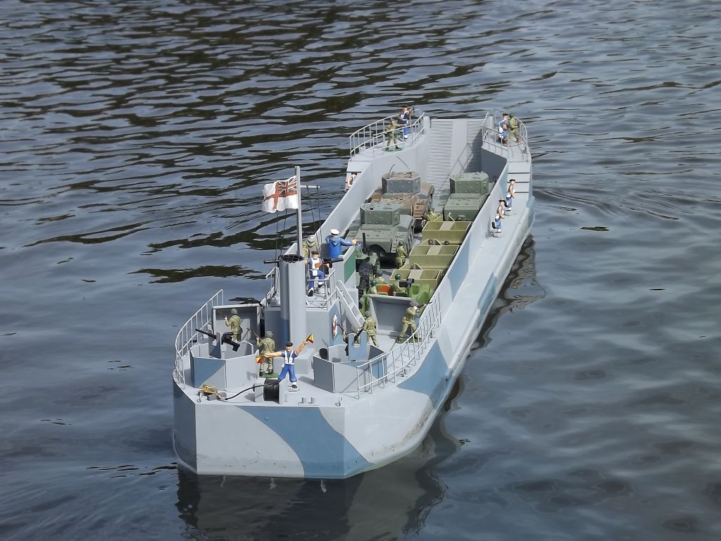

                  Francis. Welcome to the forum. Thinking outside the box, as I do, I have used galvanised garden mesh (very cheap and available in several sizes) for several craft. Illustrated on the converted lander and big LCT is 1 inch (25mm) mesh, set 12mm up from the deck, perfect for 54mm figures. Possible too big for yours, but other sizes available.
                  Purists will no doubt scoff at the use of such things, but it is very tough and effective for the incredibly cheap price.
                  I simply marked a line around the edge of the deck, drilled a series of small holes at 1 inch intervals (in my case) and simply tapped the mesh into place.
                  lct#2
                  ferry#2
