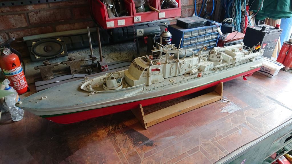

            Hi All, came across this thread having a Google for wiesel boats. I've just become the owner of this one.. Little light resto, still got the original motors.. Maybe this winter I'll give it more than a light tickle 😁
            #88318
              Hi Lawrence, and welcome to the forum. Looks like a nice project you have there, as you say just ripe for a bit of light restoration.
              Feel free to take some “before” close-ups and so on, or even create a new thread detailing your voyage of discovery!

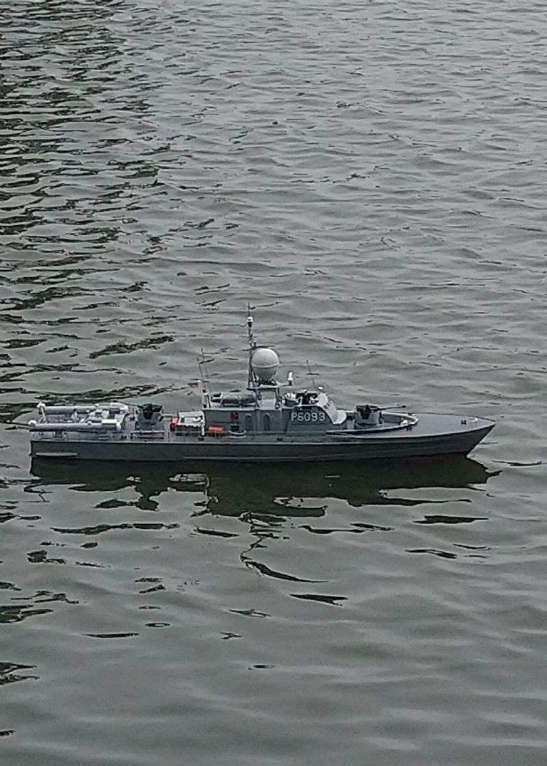

                  Maiden sail last Wednesday on the boating lake at Cleethorpes.
                  Had a minor hiccup, she took on about half a litre of water, due to my dodgy sealing of
                  the centre prop tube, getting things sorted out this weekend.
                  Edited By Kip Woods on 11/07/2020 00:25:22
                  #89894
                    Looking good Kip.
                    Water entry…through the actual tube or around the tube/hull joint.
                    Thats a lot of water…good job it didn’t start Togo under!
                    #89902
                    Kev.W
                      @kev-w
                      Around the tube, I hadn't got the body filler crammed in hard enough, must have left a pocket.
                      This time I mixed up a gill of resin , angled the hull in the correct plane & poured it in.
                      Water ain't gonna get passed that in a hurry. laugh

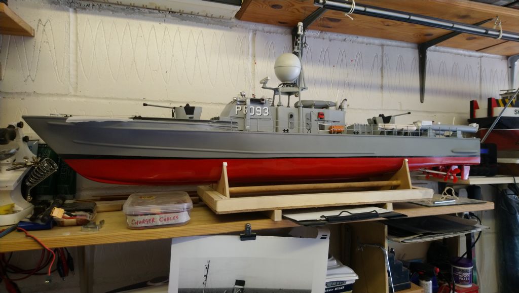

                            Update on my Wiesel, during lock down, I decided to take the advice of another club member.
                            I have added a touch more lead ballast to counter the rolling when turning, also replaced the 3 Graupner brushed motors with small brushless motors.
                            The 3 brushless are pushing the boat over scale speed, so will now change the 2 outer props so that they counter rotate & remove or make the centre prop free spinning.
