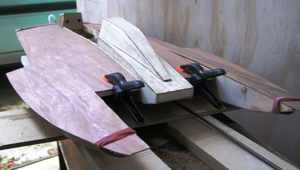

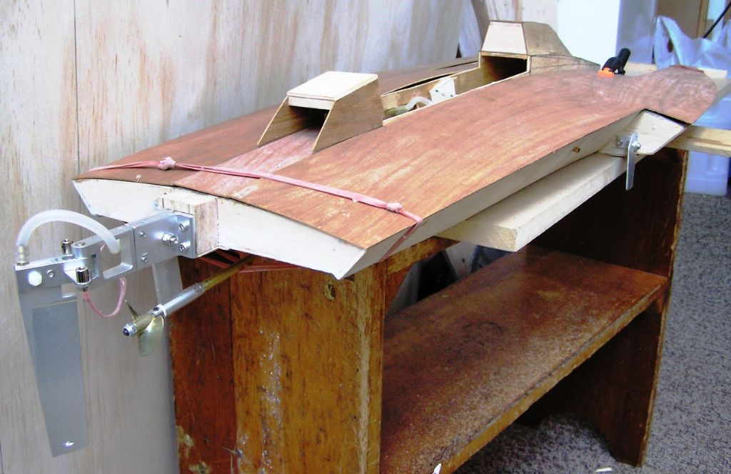

          The Free plans on the net for the Atlas Lines Hydro would be a good starting point .
          These are available in 21 and 3/4, 24, 26 and 1/2 and 42 inch.
          But if you take the PDF files to a printer, you can resize them to your requirements.
          I resized the Sea Hornet 25% bigger to 31 and 3/4 inches and the Sea Rover 20% bigger to 35 and 1/2 inches.
          I started on 26 and 1/2 one and found I had the reshape the central nose area to get a Lipo battery forward for the balance of the boat, also added lead into the outer hull sections.
          No room in the slim hull for batteries, radio and servo, so the main fuselage area is the only area.
          I like the boat to be nose heavy to start( I can move the battery back a bit).
          I have a 4mm flex drive installed with a surface prop(adjustable).
          The surface prop will shower all the boats and boys!!!!

            hydro 2.jpgHi Ashley
