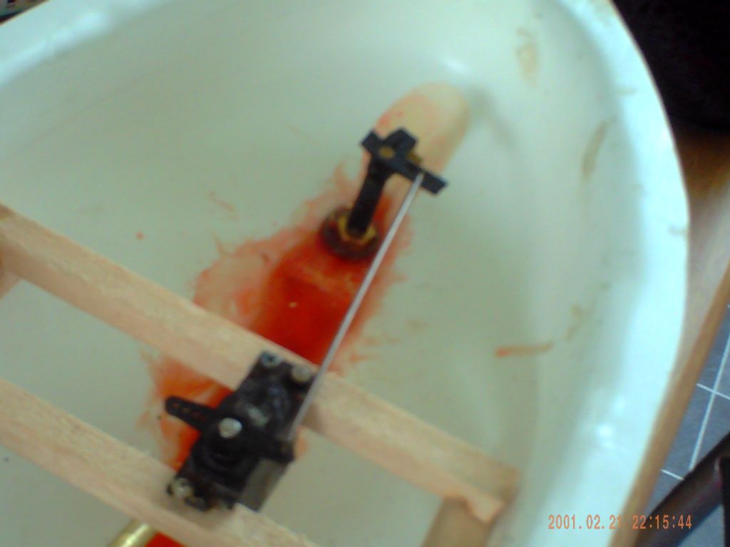

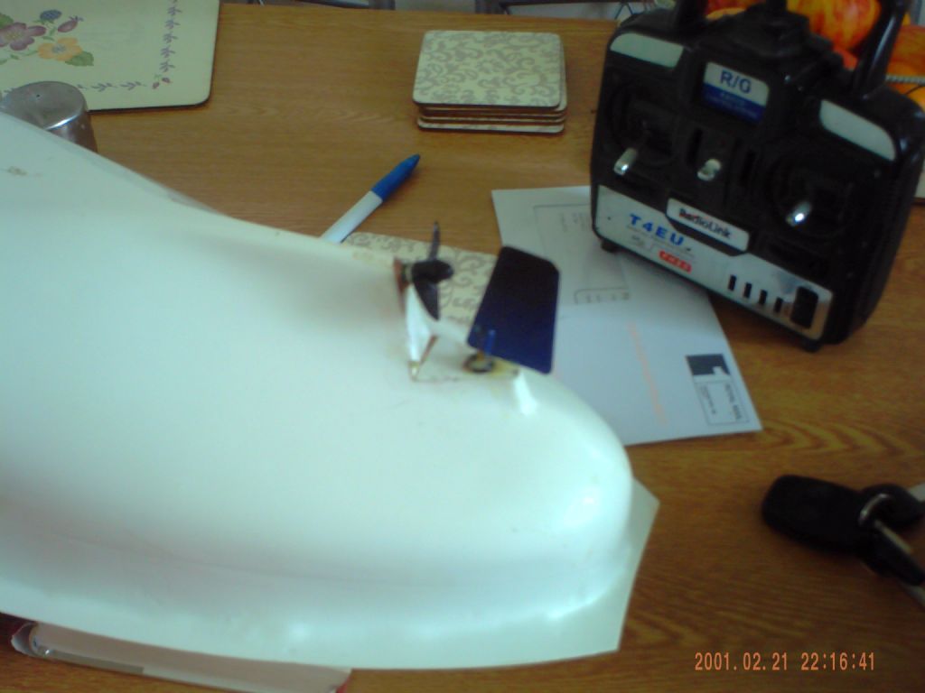

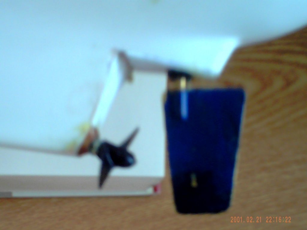

                    hi everyone thanks for the advice regarding setting prop shaft . in the end i cut out a small square for the prop shaft and rudder , i then fixed them in place using some p 40 and plasti card , then sealed it with fibre glass resin tilting the hull up at an angle so the resin covered the prop shaft and rudder tube . result a very nice weld . i stenthend the hull using 1/4 inch balsa strip round the lip of the hull and 1/2 inch balsa as beams then i laid the deck using plasticard , result .
