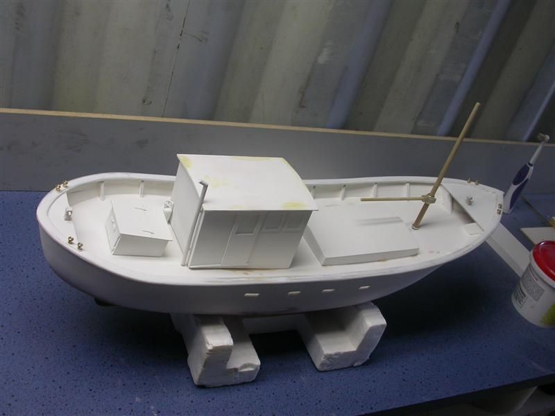

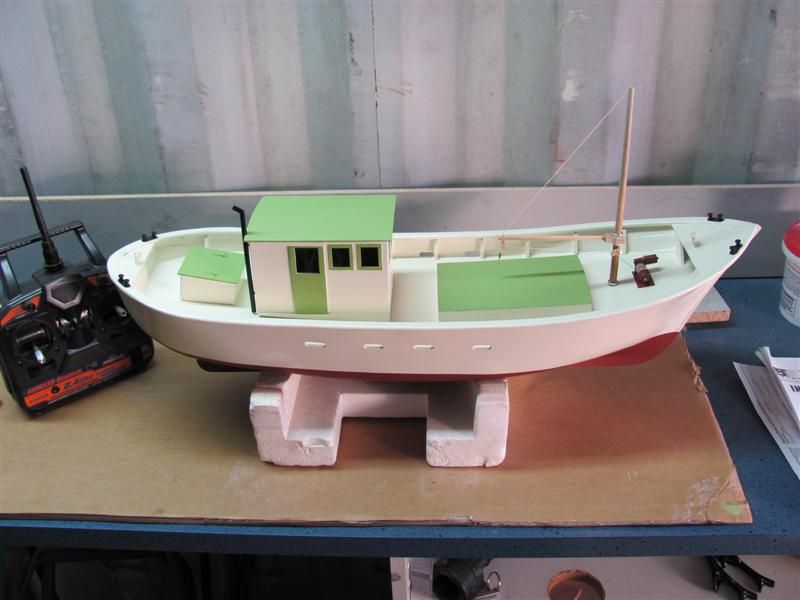

      In response to Ashley’s gentle nudging on another thread to get cracking with building boats, Here is where I have got to with my fishing boat. It has spent a lot of time sitting, between short spurts of building.
      White undercoat, I have just placed the fittings into their positions for the Photo.
      Being my first scratch build I have made a lot of mistakes along the way and will do things differently next time. A classic one was gluing the window frames and doors onto the cabin before finish painting them, now I have a lot of fiddly painting to do. I also should have been more careful setting up the frames as the hull is not quite symmetrical and I have had to fit the gunwale / hand rail carefully to disguise the fact when you are looking from above. I have done some more sanding and top coats since these photos were taken.
      David.

          David. Dont worry about a bit of cheating now and then. no one will notice.
          Nice hull shape, great bow… prop looks a bit small?? or just a temporary job.
          remind me of the dimensions. i should like to take a boat like that on the sea !

            The model is 700mm long at 20 – 1 scale. The hull shape is from the plans of an Italian fishing boat that I found on the web, but the above deck structure I just made up as I wanted it to look more like the type of fishing boat you used to see around NZ years ago.

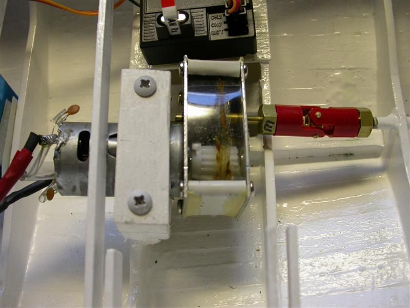

            It is funny about the prop. I made a 4 bladed one at 35mm dia and was wondering If it would give enough thrust. When I tried it in the ballasted hull, at full speed it was doing its best to plane and the bow wave was higher than the sides of the boat. So I made a 30mm dia prop and that was still too fast, finally made a 25mm dia prop and I even had to tweak the pitch back on that.
            I am using a small brushed motor running on a 7.5V battery coupled to a 2.5 to 1 gearbox that I made. I don’t know what the motor is though. Here is a picture of it.
            May be running a bigger prop on a lower voltage would be better. What do you think?
            David.
            #31712
              A bigger prop gives more “bite” for good acceleration and stop, and will sound much less busy that a toddy one thrashing away underneath the stern, although ultimately they may probably give the same sort of top speed
              given that there is a 2.5 reduction, the motor you have fitted must be a revvy thing..
              I would just put the 35mm one back and use less throttle or fit a 4.8v battery ?
              Years ago I bought. 3 x 45/50/55 mm plastic 4 blade props with quite a fine pitch…and have never found a boat to use them on. Thrust was disapointing, although they look the part in their gold paint.
              The biggest props I have are on the Fantome, at 50mm brass three blade, on an MFA 800 motor. Wow..the thrust from THOSE babies!

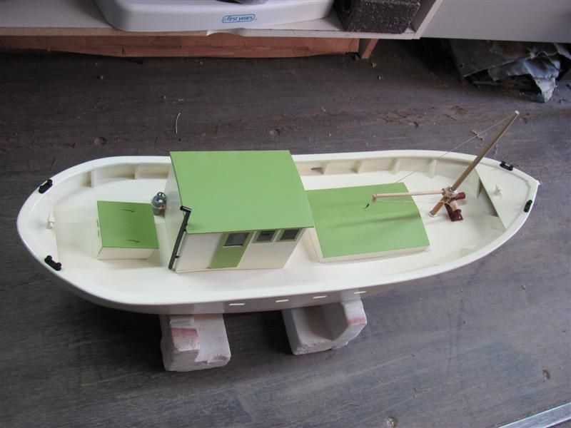

                Things are progressing, the hull and fittings are now painted and I have made a mock winch for the derrick.
                David.

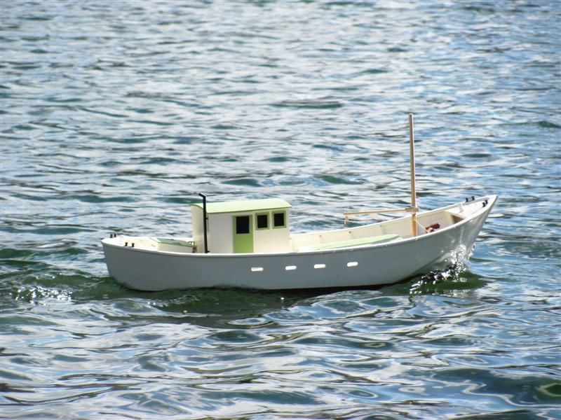

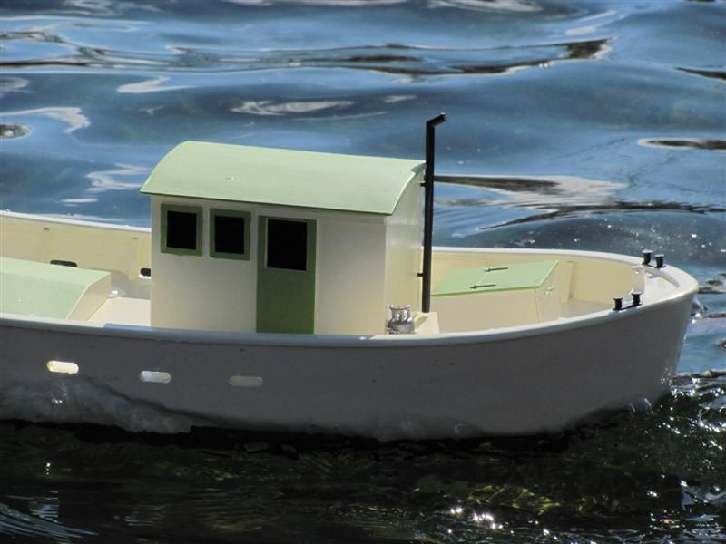

                          Henley lake was to windy even for the 1 meter yachts so we changed to Queen Elizabeth park to give my boat its first serious run.
                          Everything went well with no hiccups.
                          The pictures show it running at about half throttle with the reduced pitch 35mm prop, Ashley.
                          I think that I will leave it like that, as it gives a bit in reserve for getting out of trouble if needed.
                          I have concentrated the lead ballast at the bow and the stern in the hope that it will give a more realistic effect when going through waves.
                          It only goes forwards at the moment as I bought a cheap Turnigy 20 amp brushed aeroplane ESC for $4.95 US, with the idea of making a reversing switch which will run off the 5th channel on the transmitter. This still needs doing.
