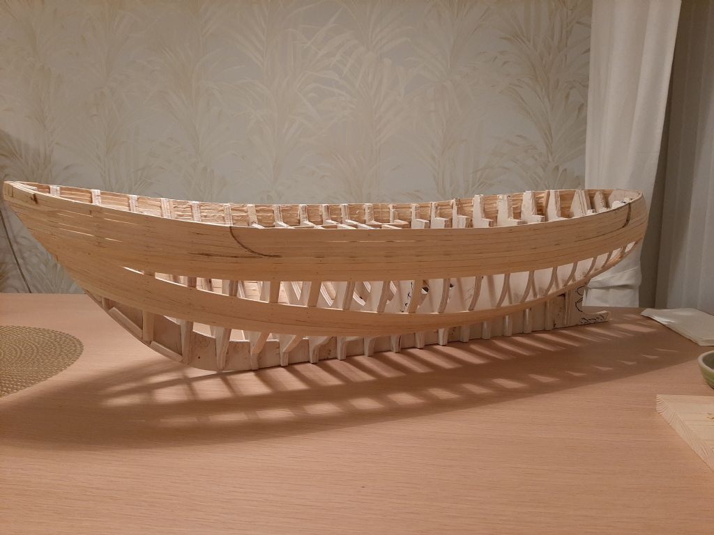

              20191105_203041.jpgResults after about three months of sawing/glue20191002_153230.jpging 9mm plywood!

                Hi George,
                You are making a fine job of your Fisher, what are you using for the planking ??

                #85145
                gecon
                  @gecon
                  The planking is obeche 1.8mm of different widths. And…… it looks better in the photo than in the 'flesh'!
                  It will be OK when sanded down I expect. Considering covering it with fine weave cloth and laminating epoxy to try to get a 'fiberglass look' as original yacht.
                  #85149
                    Obeche is one of my favourite materials for model making, worth spending time with P38 car body filled to fair the planking, as the glass cloth & resin shows exactly what's under it in my experience.
                    #85151
                    gecon
                      @gecon
                      I was advised by an experienced boatmodeller to use cloth/epoxy with added colour. I have no experience with this at all but I'm going to try it. With added glass balloons it should be OK to sand down. Time will tell.
                      I expect that I will be ready for that stage in a month or two. There's a lot to be done to the hull before it's ready for the treatment! In that this is a scratch build, I have to make my own instructions as the build progresses…..preferable a bit in advance of the each building stage!

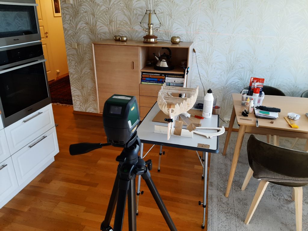

                      #85569
                      gecon
                        @gecon
                        I doubt that many are interested but, seeing I have started off on this escapade I think it's appropriate to show that I'm still using the saw, xacto knife and the waterproof PVA. So…added a few more progress photos.
