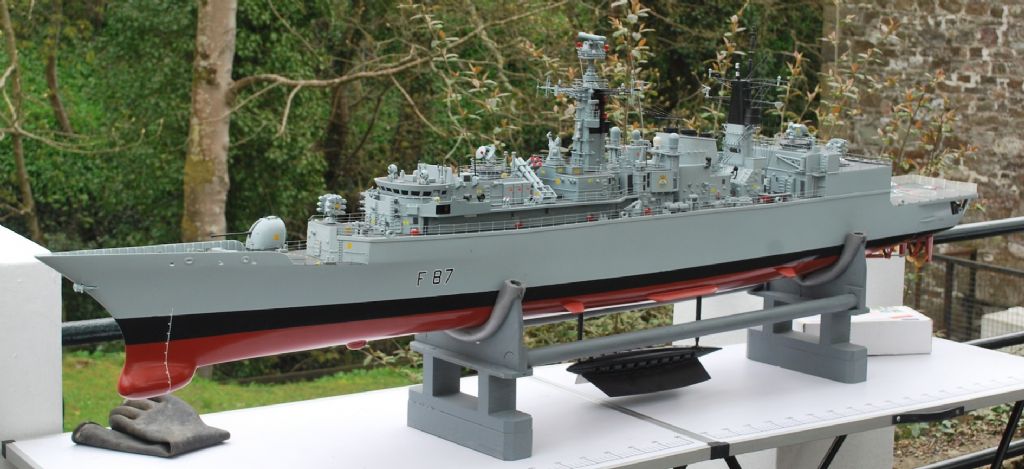

                            Kimosubby Shipyards
                              @kimosubbyshipyards
                              Hi Richard,
                              just a few ideas. The first, for a round bottomed hull (the Bounty) I just filled some copper pipe with lead and bolted that to the lower, outer hull. Works fine.

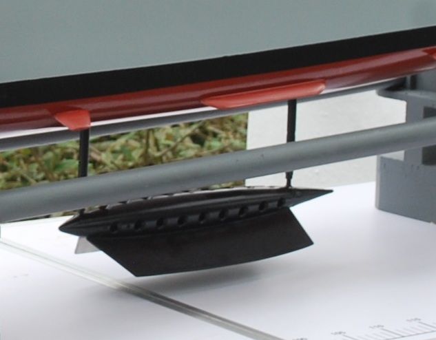

                              HMS Chatham, below, built by one of our chaps had a severe stability problem, overcome by bolting on a "marblehead" ballast with added fins when sailing, though after all the drilling out the 3.6Kg is probably nearer 2Kg.hmschatham.jpg
                              When on display the keel quickly unbolts from captive nuts inside the hull.hmschatham_keel.jpg
                              And on this monster [Deans Marine Celestine], stability came in the form of high voltage copper bus-bars again bolted through the hull into captive nuts. The bars also impart a leeway keel effect enabling very good manoeuvrability for this boat. At 6 foot she needed itSea Crusader
                              You can see the doubled bars between the two supports.
                              Kimmo
                              Edited By Kimosubby Shipyards on 03/02/2014 16:01:21
