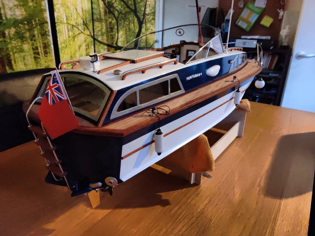

        img_20210301_174701_dro.jpgHi All, The Lockdown model is finally finished and I am very pleased with it. There are already many excellent diaries here on the Fairey Huntsman but if anyone is interested in my twin engine build, I could post a few pictures of the diversion from the standard kit. I am not an expert, just a happy amateur! Regards Joeimg_20210301_174827_dro.jpgimg_20210301_174849_dro.jpg

          That looks really nice Joe, yes we would like to see a few more photos.
          #94008
            so you should be happy Joe…………its stunning, and beautiful as well.enjoy sailing her whan you can.
            #94009
              What a cracking looking interior. Beautiful build, you have every right to be very proud of it.
              #94010
                Most of us are happy amateurs on here Joe!
                Lovely build and you have added some nice detailing. Of course we'd like to see more photos and information! It's always interesting and useful for other builders.
                What size is it? And what's the hole near the bow?
                Edited By Chris Fellows on 01/03/2021 23:02:24

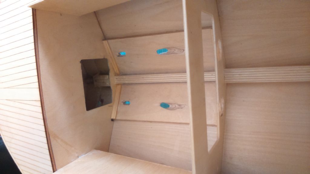

                      StrengtheningFirst deviation from the plan, strengthening to the hull skin, also inside the transom box and further ply added under the motors.

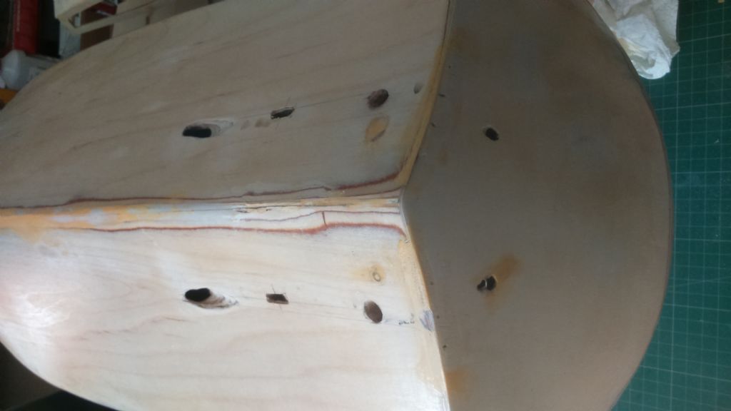

                      Holes
                      What's worse than a hole in your boat…eight holes! This was the most difficult part, with no plan, I had to guess the angle of the prop through the hull.
                      Prop angleMy plan all along was to keep to the look and feel of the original full size boat as much as possible, so by measuring angles from photos on my tv and a bit of guesstimation and cardboard templates, I arrived at approx 20deg. I didn't get it exactly right, hence the larger prop holes. and extra wood to cover the inside! I should have made up a jig from scrap wood to keep everything in line as the glue set. One of the props is very slightly out of line, I call it the boomerang effect, as it will always come back to me! We live and learn.

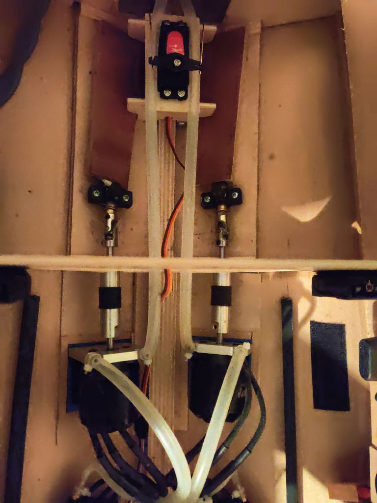

                      Motors

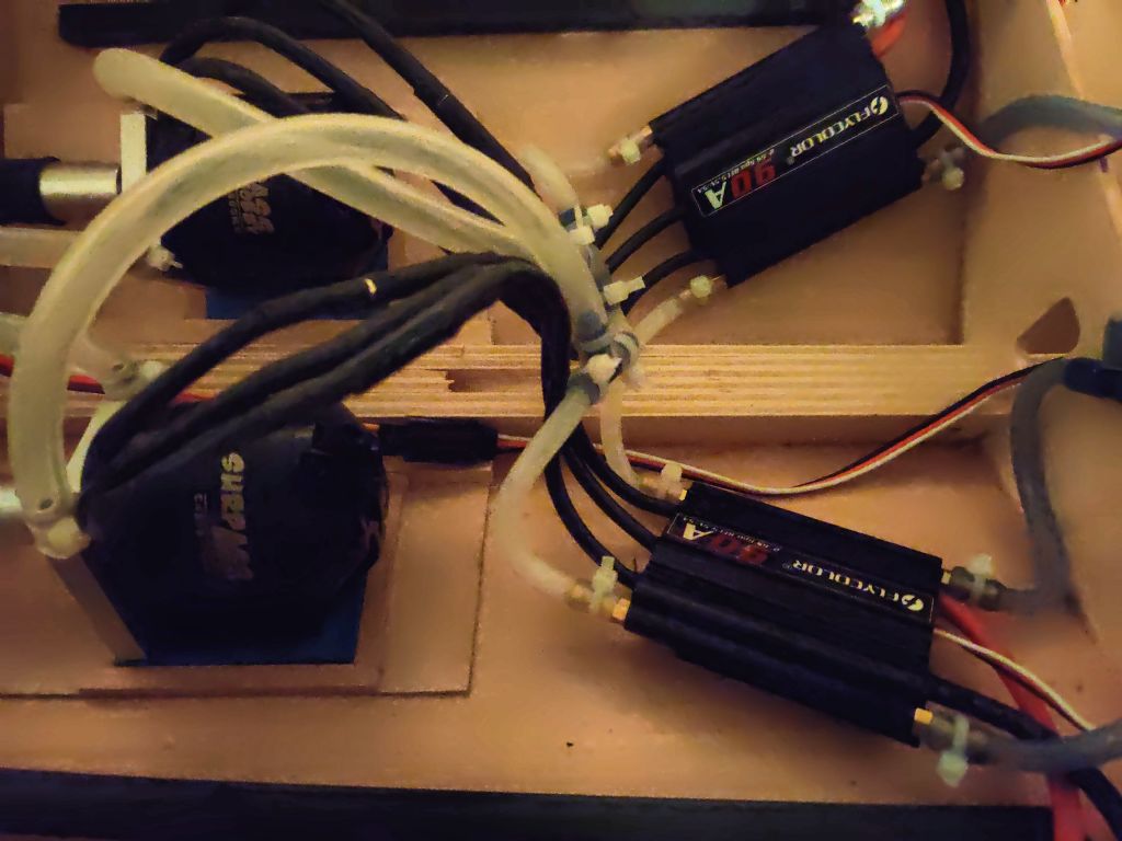

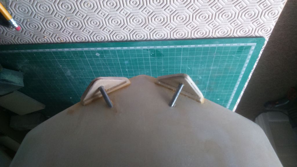

                      Two uj's per prop allows the motors to sit fairly flat on the hull. Raw water cooled motor mounts are glued directly onto dense core foam for sound and vibration deadening.

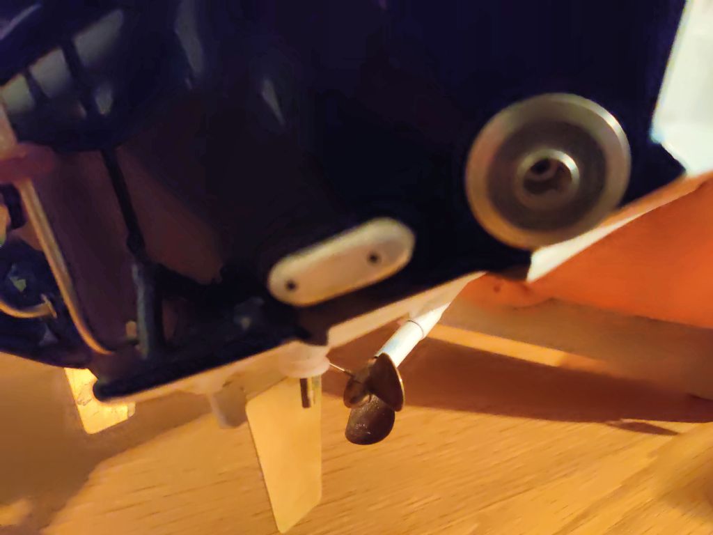

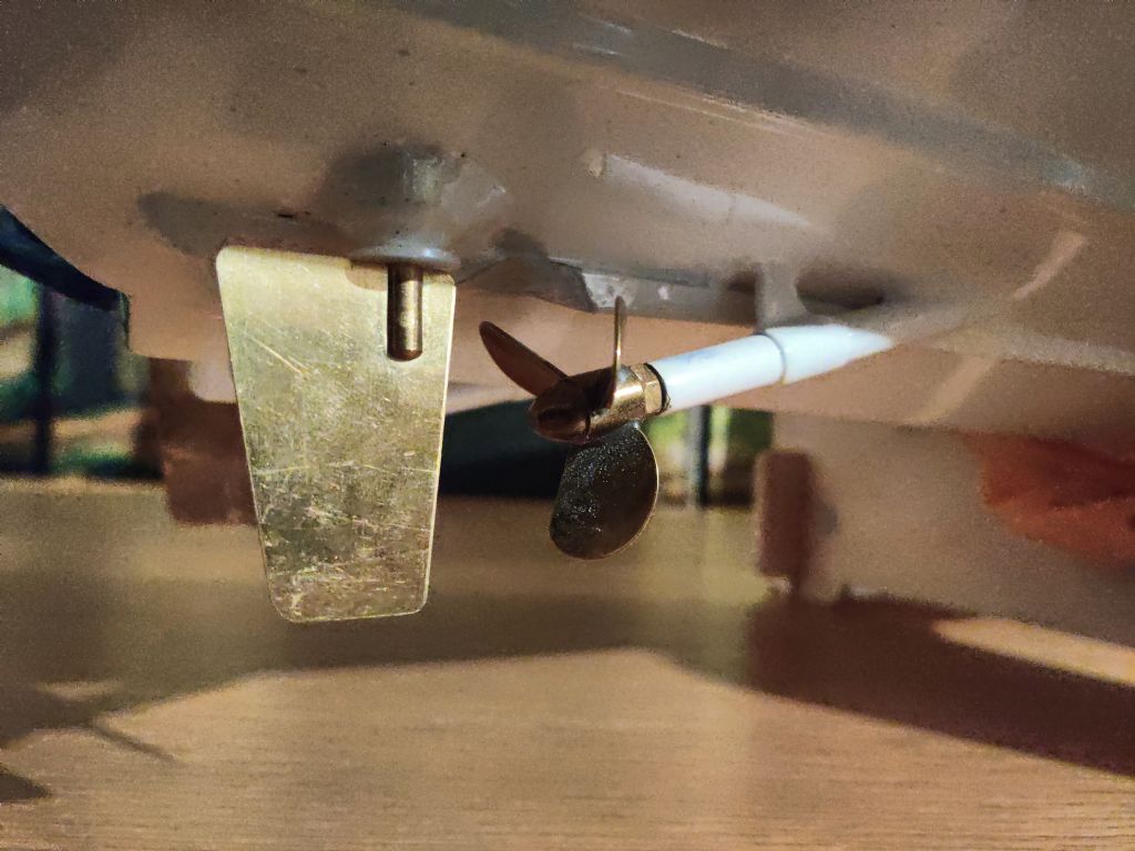

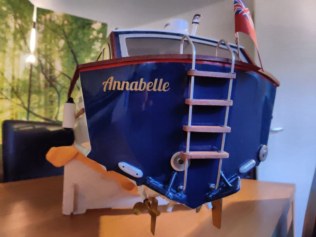

                      Cav platesTrue to life anti-cavitation plates are though-bolted at both ends and glued/pinned to the hull.

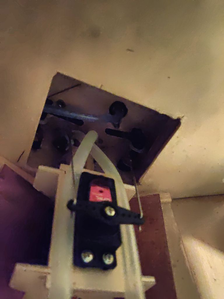

                      Steering 2
                      Rudder stocks are fitted through angle-cut plastic tubes either side of the hull skin and the entry was enlarged to the transom box for access to rudders and exhaust cooling pipes.
                      Propeller
                      Propshafts have 'p' brackets, as per the full size and the rudders are about the same shape as the actual items. Water intakes either side of the hull. Notice the hull chines cut out around the propeller…too close for comfort!
                      Motors close

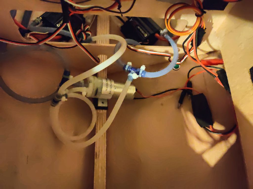

                      The motors (after much help from the forum) are Surpass Hobby 4250, 800kv outrunners and the speed controllers are fairly hefty 90a Flycolor with raw water cooling.
                      CoolingAn electronic switch operated water cooling pump allows for realistic water through the exhausts on demand as well as being forced by the inlets when underway.

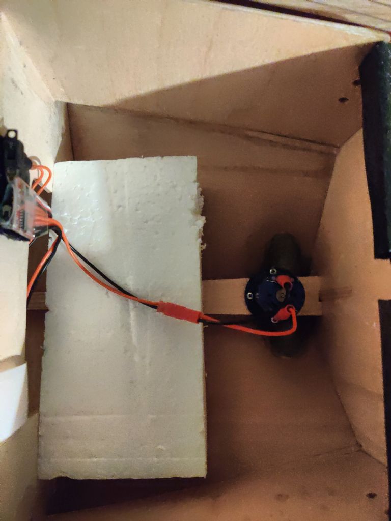

                        A bow thruster operated from one of the sticks, just because I can!!

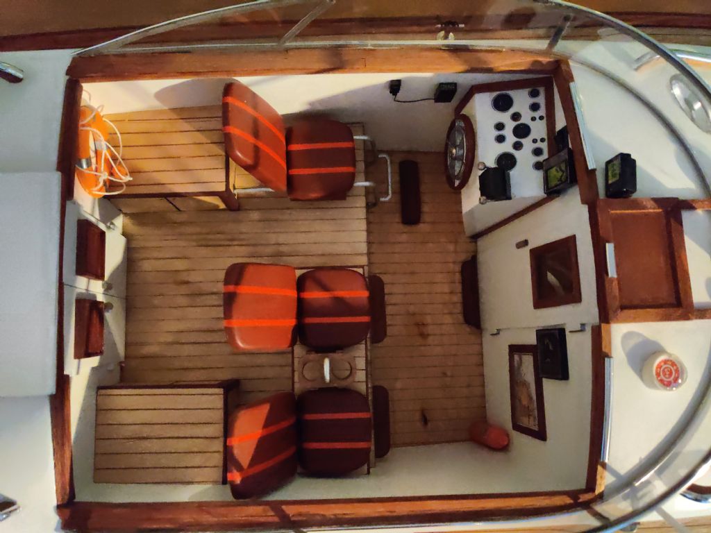

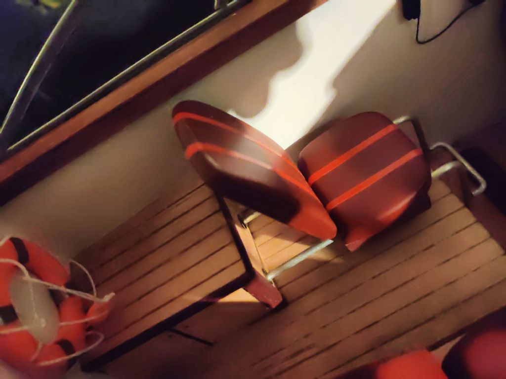

                        Captains chair

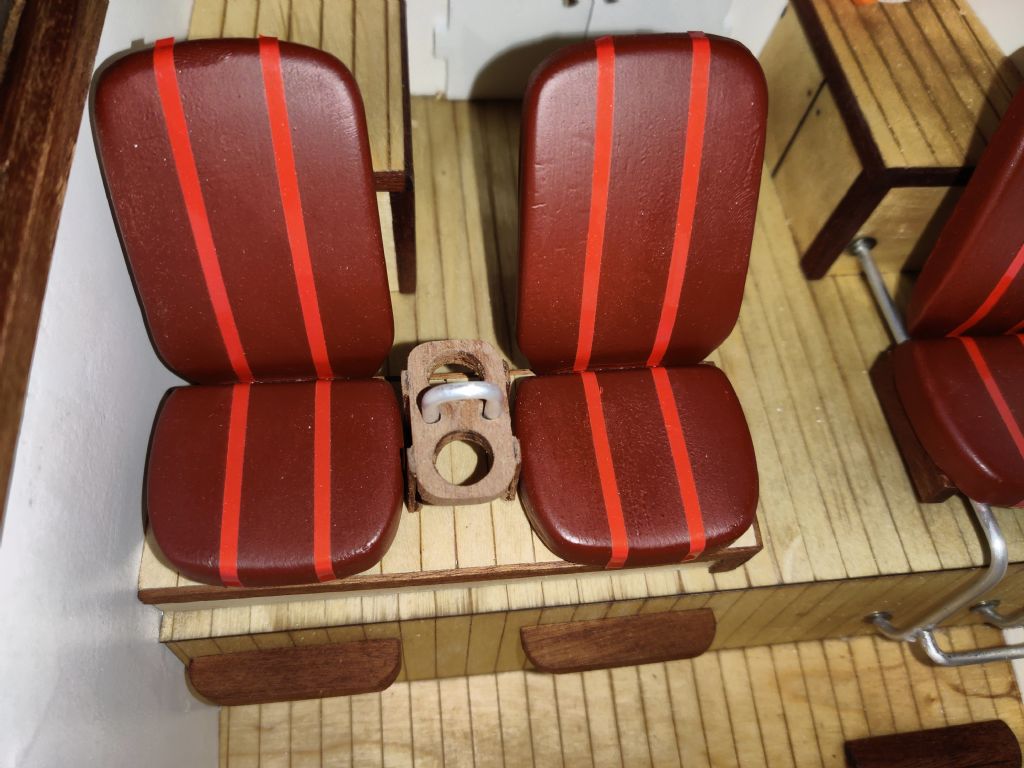

                        The skipper's chair actually moves back and forth to allow for the figures that my wonderful son-in-law is printing for me! The cupboard/steps are the same as the full size.Crew chairs
                        Crew chairs look (a bit) like leather with obligatory cup holders to hand!

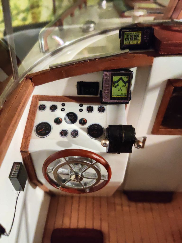

                        Dashboard

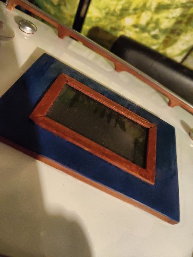

                        Cabin detail. The hours spent on that 'leather-covered' steering wheel! (red oxide primer, roughed up a little!
                        Map & radar

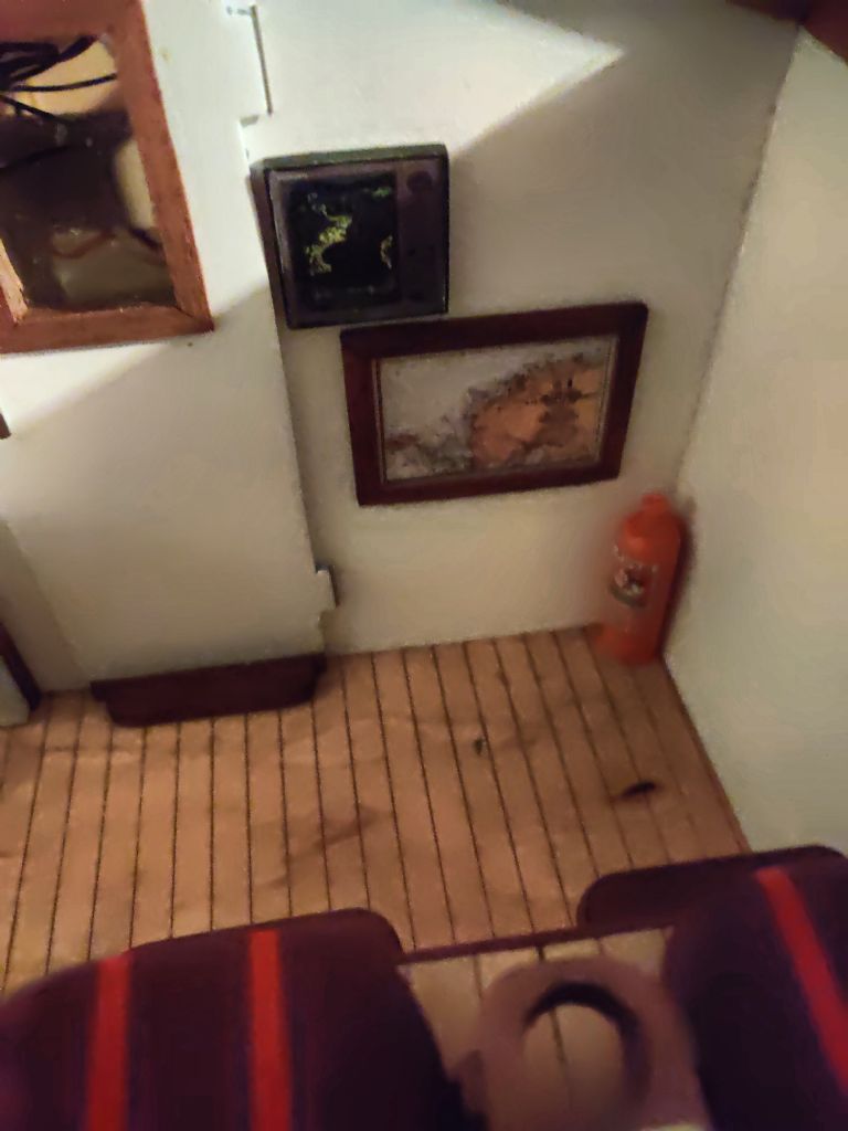

                        Local map and radar screen and a window in the door. I left the cockpit floor unstained, just matt varnish as I wanted the boat to have a slightly 'lived-in' look. The main deck was washed with mushroom coloured paint as most real boats go that lovely greyish colour eventually. I had an extra deck sent out due to a fault, so cut out the edges to make a raised gunnel rail.Front hatch

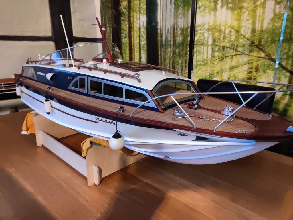

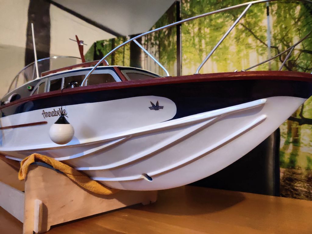

                          Will Mason 1
                            @willmason1
                            Fantastic looking model of an aft cabin Huntsman 31.
                            Those extra bits and bobs really make it.
                            I'm a huge fan of the Fairey range of pleasure boats. My Uncle had two, an aft cabin H31 and a Swordsman afterwards.
                            When are you hoping to get her bottom wet?
                            I look forward to seeing pictures and hopefully some video of her on the water.
                            Will
