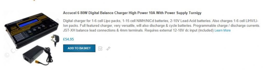

                                    I have been looking at Lipo chargers and they seem confusing, some need to connected a 12v battery to charge the Lipo .
                                    Can you recommend a charger or explain the differences.
                                    regards
                                    Bryan
                                    #83830
                                      Yes, I was confused by that at first. Those enable you to charge your LiPos at say the lakeside from e.g. a car battery. I don't know anyone who does that though!
                                      The one I have, I bought from Component Shop and it's a Turnigy Accucel 6 like the one shown below, though mine is the 50 amp one. Interestingly the 50 amp one now says it will charge 1-5 LiPos whereas mine will do 1-6 LiPos. They have either changed the spec. or it's a typo., – the detailed spec. does say 1 – 6 though. I'd buy the 80 amp one now anyway.
                                      As you can see it includes the mains power supply and transformer. I use mine for charging LiPos and NiMH batteries and once I'd got my head around the instructions find it easy and safe to use. It's a balance charger, which means that it monitors and charges each cell in the LiPo pack so that each are adequately charged and whilst charging you can see what the individual cell voltages are and the final voltage of the battery once it is fully charged. Also you can use it for storage/maintenace charging of your LiPos when they aren't going to be used for sometime.
                                      I find it a good piece of kit but there are more expensive and more powerful ones if needed.
                                      Edited By Chris Fellows on 14/09/2019 23:21:05
                                      Edited By Chris Fellows on 14/09/2019 23:26:39

                                        Some are the complete item with mains going in one end and a LiPo connection at the other. Some are just the clever bit that re-arranges a 12 volt supply to do a balance charge. Some are split because the technology for converting mains to a dumb 12 volts is well established and can be bought in bulk. The actual bit that connects between the 12 volt DC supply and the battery is very individual to each manufacturer. Not having to certify a mains unit cuts costs enormously. It gives the end user the choice of using your own 12 volt supply, be it a 12 volt battery, a car socket, or a mains driven power supply.
                                        Could be a way of final charging from storage to full on the drive to pool. Depending on length of drive and size of battery and capabiliy of charger.
