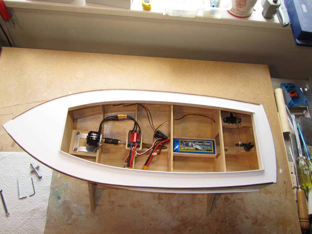

        I’m the wrong person to advise on this in a way because I use brushless in all my builds, even the very slow ones! But is there any reason you want to go brushless as a brushed would provide sufficient performance?
        For my part I use them because I was late to the party and brushless were pretty well established and I like the quality of construction even though yes, they are more expensive.
        Brushless will drive big props but I think that 40mm in such a small boat is maybe too big and I’d go for a 35mm.
        Motorwise a 28mm outrunner brushless will do the job – have a look at Overlander Batteries as they do a range – you don’t need a high kV. I use theirs with HobbyWing Quicrun ESCs and they pull away and run very smoothly at low speed. Get a program card as well. I use Wheelspin Models for the ESC and program card.
        This is the set up in my Fairey River Cruiser which is the same length.
        RC Installation 1

          I was thinking along the same lines and so your response confirms that as a good option. Thanks for the pic.
