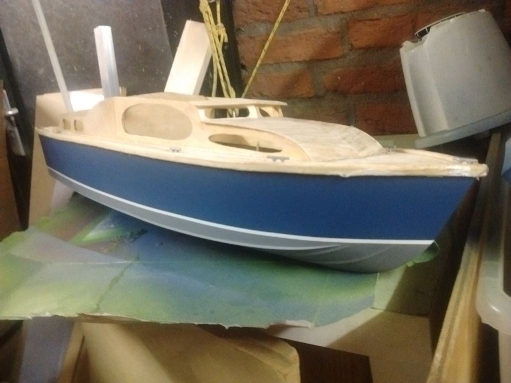

              In the mean time I painted the hull in its base-coat, but not yet in the high-gloss finish:
              Hull painted

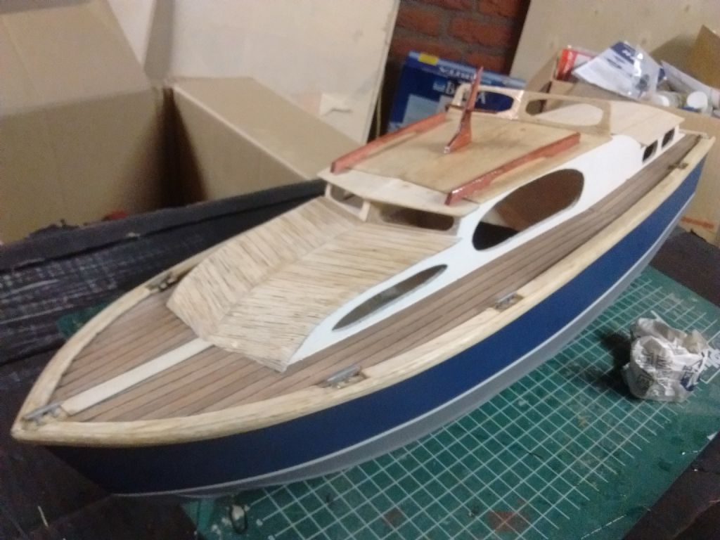

              I then commenced with painting the deckhouse white, but that went horribly wrong with terrible underrruns so I was forced to re-do the deck with 0,7 x 6mm Mahogany planking with black cardboard seams. A b**ch of a job, but the result is worth it. This is how it looks before treatment with a PU impregnating resin, which makes it a bit darker and brings out the color:
              New deck laid

                She's looking really good, that deck will come up a treat!

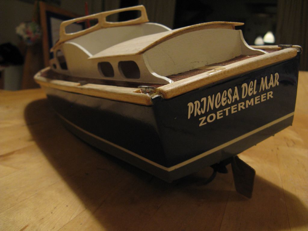

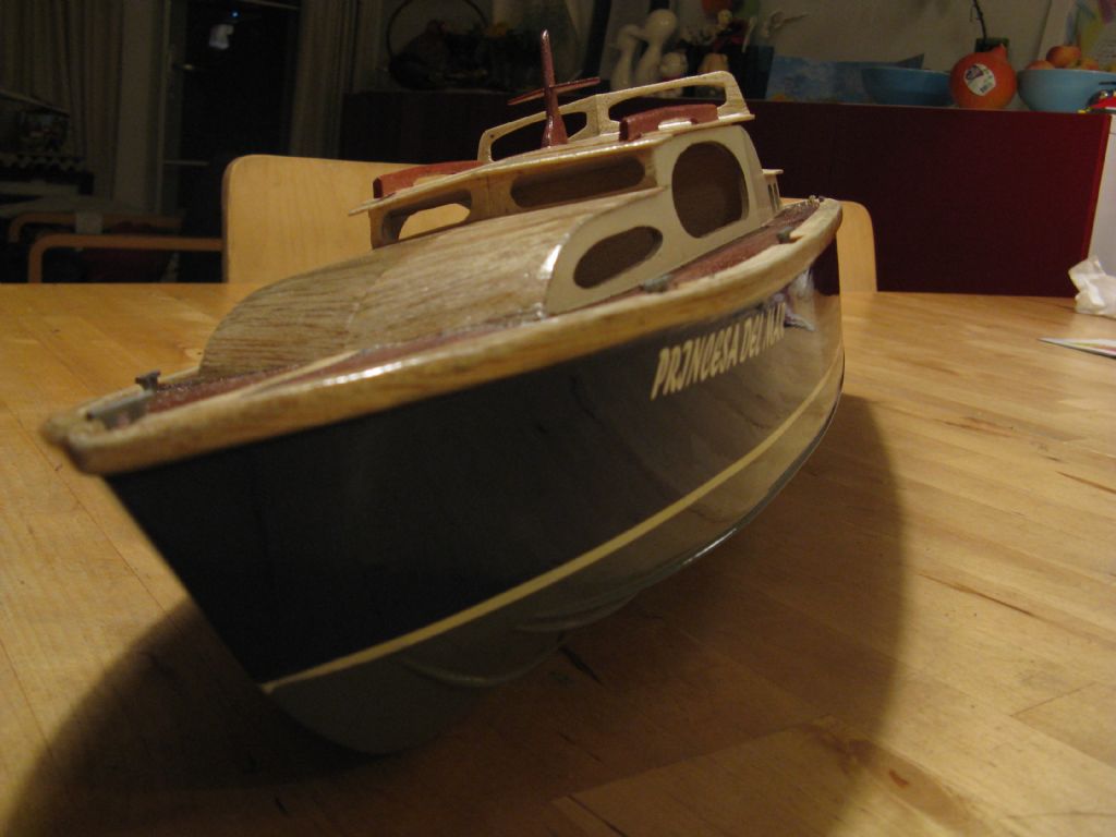

                  Sooo… that took quite some time, I had a little setback…
                  As I painted everything using acrylic paints, I decided to use Rambo gloss floorpaint – as I have had good experiences with the hardware store's own brand acrylic floor paint, but that was not available in high gloss, and the Rambo version promised to be "tough and water resistant".
                  After three layers I decided to wet sand instead of dry sanding, to obtain a nice and smooth finish just before applying the name vinyl decals.
                  crying boy was that a mistake crying
                  Within two minutes the paint turned milkwhite and started peeling off the hull in big pieces, it was a complete disaster. I had to completely strip down the layers of paint and re-do the whole scheme cryingangry 2crying
                  So after I wiped my tears and re-sprayed the whole hull, I did a test piece finishing it with spirit-based high gloss clear coat and because that turned out to be successful, I then sprayed the hull with it.
                  After three layers (each time wet sanding in between) I applied the decals I cut out in the FabLab Zoetermeer (thats quite an invention, these fablabs, very nice to have that around!) and then applied a further two or three layers of clear coat and here she is, hull now finished and running gear sort of installed:
                  Hull finished
                  Hull finished

                    That is one of the problems with acrylic finishes. They don't always bond to the substrate and simply dry as a film on top of it, in effect you have covered the model in liquid shrink wrap which is OK until you puncture the surface…. sad

                      Yeah, I guess so, I just never had this issue with Glitsa or Gamma home brand floor finish. But they only come in matt or silk finish, and I wanted this boat to be comb-your-hair-high-gloss.
                      I was actually baffled by that this Rambo stuff seemed to absorb the water (the whitening effect) and even partially dissolve again as I peeled the film off with a knife.
                      Ow well…, lesson learned, the hard way. At least this Gamma home brand, spirit based, paint sticks perfectly well, sands wet perfectly, and shines like a wet babies b*tt*m. We can proceed again

                        Maybe the formula has changed since you last used the acrylic. Paints seem to be getting more and more watery these days, presumably to comply with EU rules. Household paint never seems to go hard and car paint finishes now chip off at the slightest provocation unlike the old cellulose.
