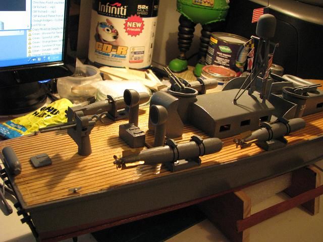

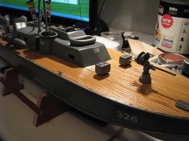

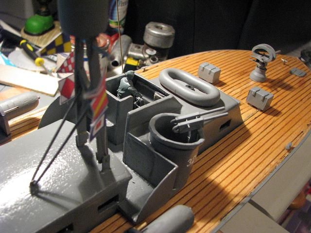

                                    • The smoke generator is balsa turned in a drill with a nut attached.
                                    • The cleats are tinplate soldered to a bit of copper wire
                                    • The twin oerlikon is brass sheet (could have been tin!) with some brass tubes and copper wire on a biro tube
                                    • The torpedoes are turned balsa with brass sheet (could have been tin), held in styrene sheet mounts (the base of an old toy).
                                    • The ventilators are bought – from my bits box…
                                    • The machine guns are brass tube and a bit of brass square section (ok – I needed to buy that…)
                                    • The figure is a 1:48 bought one…but the ship's wheel is soldered copper wire
                                    • The life-raft is silicone tube with copper wire inside
                                    • The 37mm is a bit more of the square section, with some brass tube. The flat magazine sides are beaten copper wire, and the mount is a felt-tip top.
                                    • OK, the numbers are vinyl. But I did use stencils on my Fire Tender… and there's some piano wire in there as well.

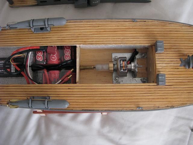

                                              Here is the motor bay for a PT-Boat – this one is a Tower 2410-12T, which is fairly similar to the EMAX CF2822. They are both around 30mm diameter and 30mm front to back. I have been running this one in the domestic test tank (bath) off a 7.2 hi-output pack with a 32mm prop (cut down 40mm), and it didn't even get warm to the touch, while pushing out enough thrust to skip over the surface like a hydroplane…
