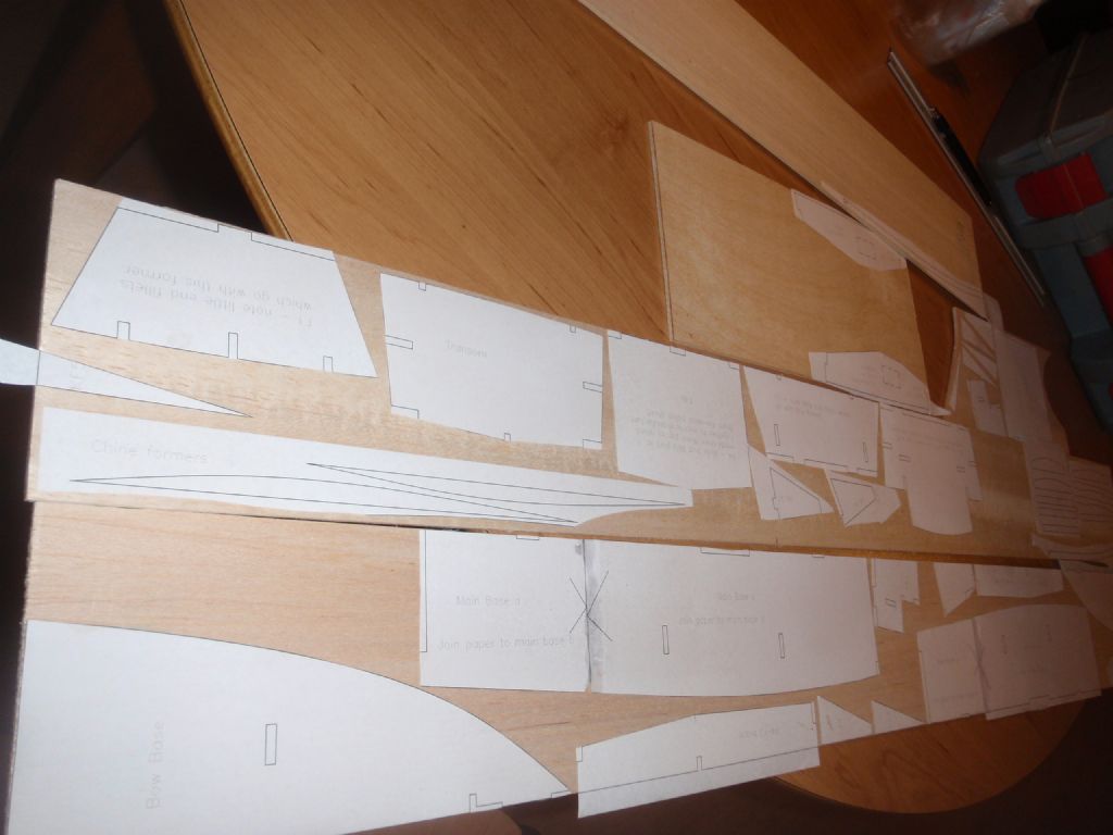

        Of course I started off with cutting out all the part templates and sticking them to balsa (and ply, for the keel, Superstructure sides and some of the formers) using spray glue:
        Part templates

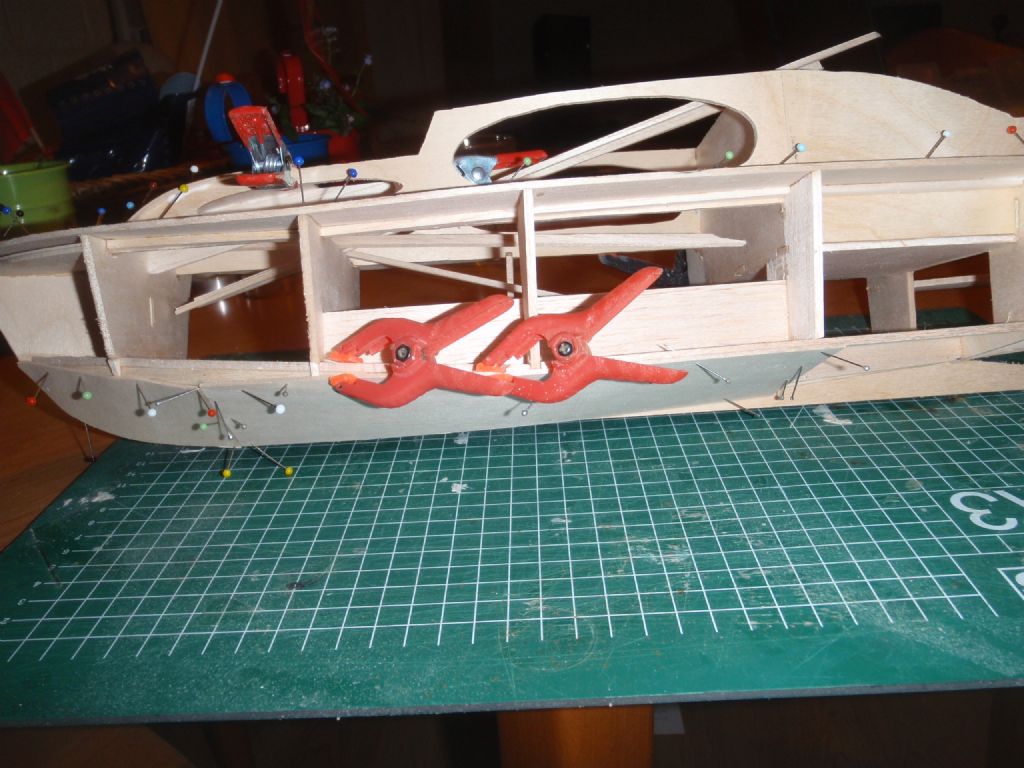

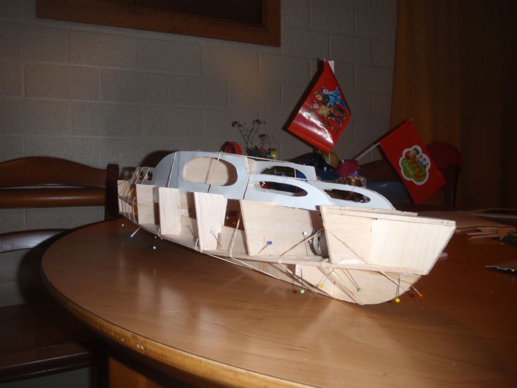

        Then, after some cutting, I knocked up the entire framework in one evening:
        Basic frame

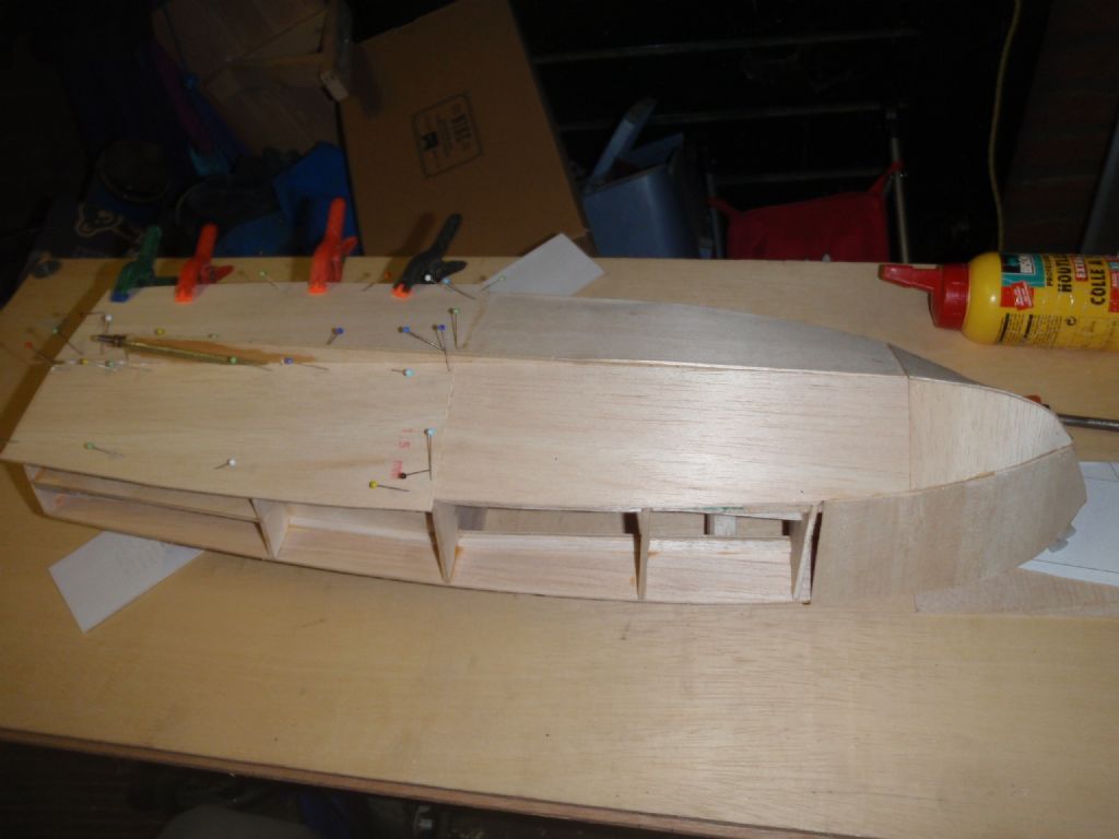

        The deck is made of two big sheets – one per side, and a little piece in the back:
        Adding deck

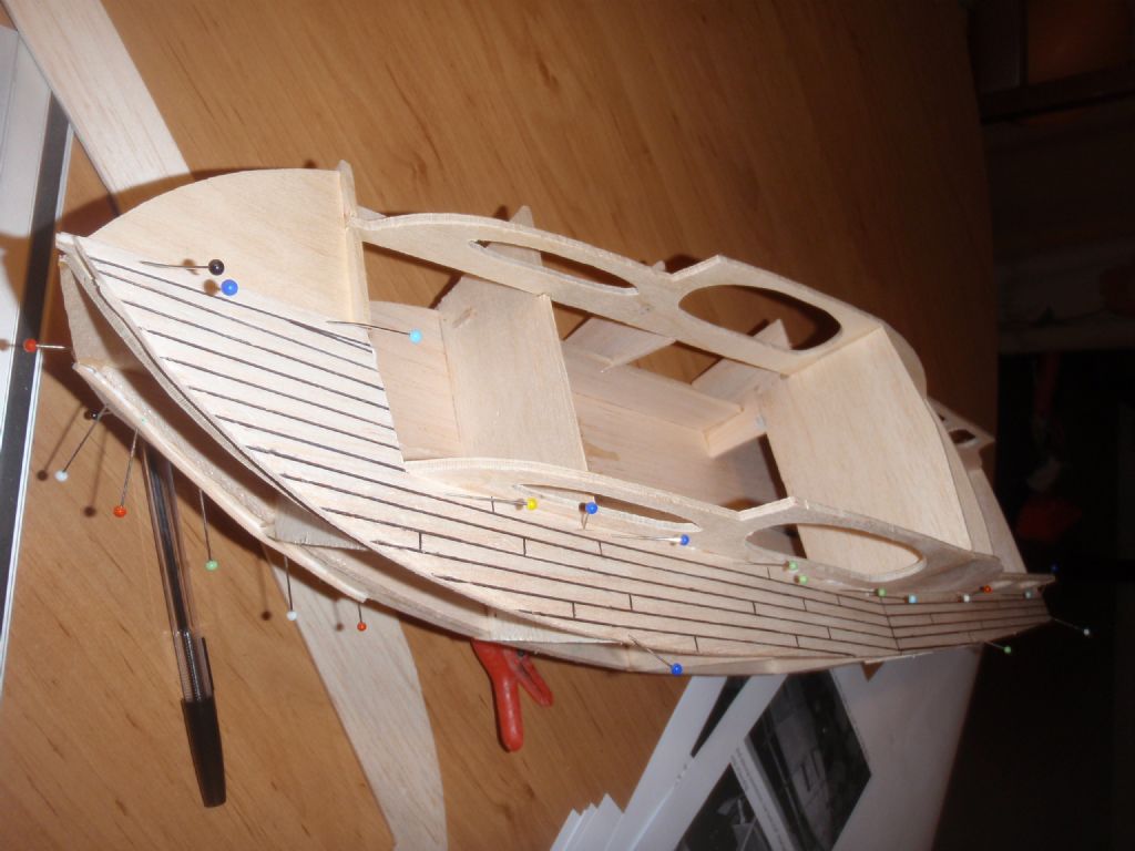

        And lastly for now, the hull sheeting starts:
        Adding sheeting

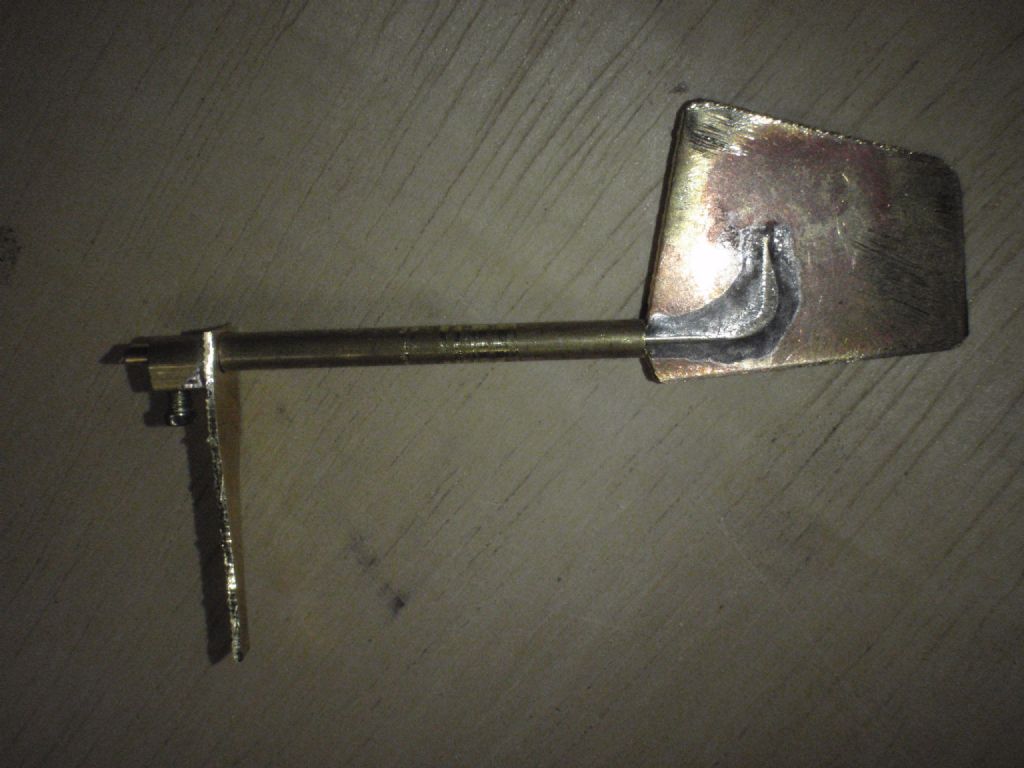

          Made up my own rudder assembly:
          Rudder assy

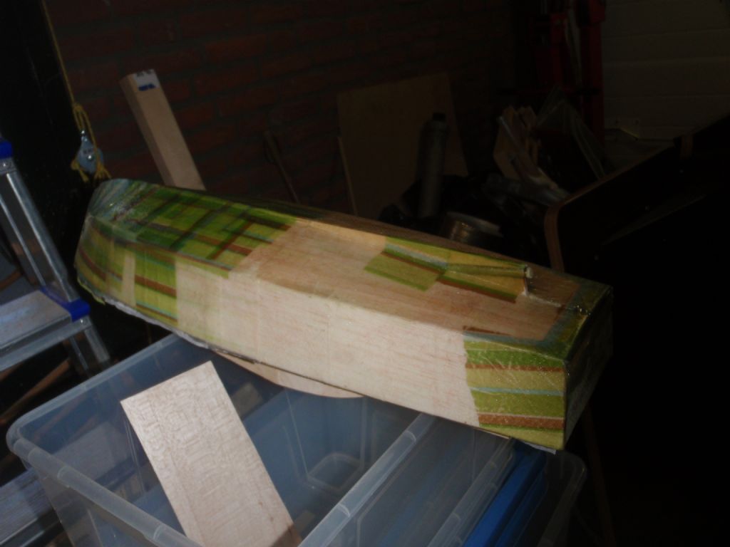

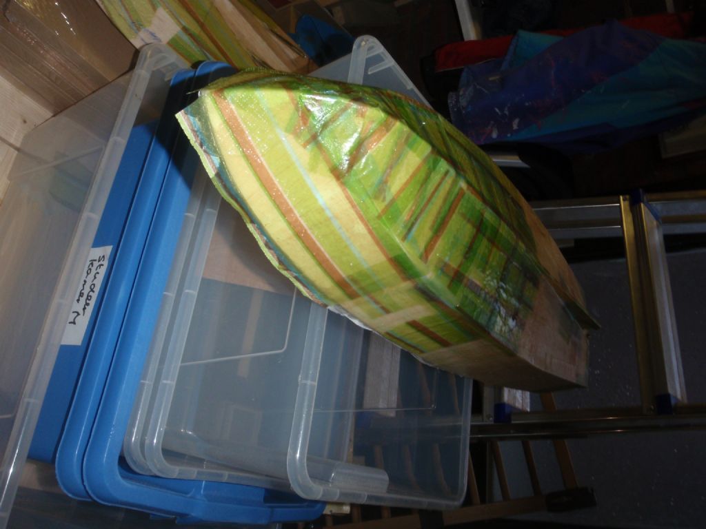

                                So…, a little update on the Sea Princess:
                                I have covered the hull with tissue and epoxy resin, on most surfaces 2-3 layers did the trick but the bow section was particularly flimsy due to some building irregularities which caused me to almost sand through the hull, so the first one third of the hull has 4-5, sometimes even 6, layers of tissue. Now it is strong enough.
                                Hull treated with tissue/epoxy
                                Now on to the boring part of filling, sanding…. until it is nice and smooth, like a yacht should be.

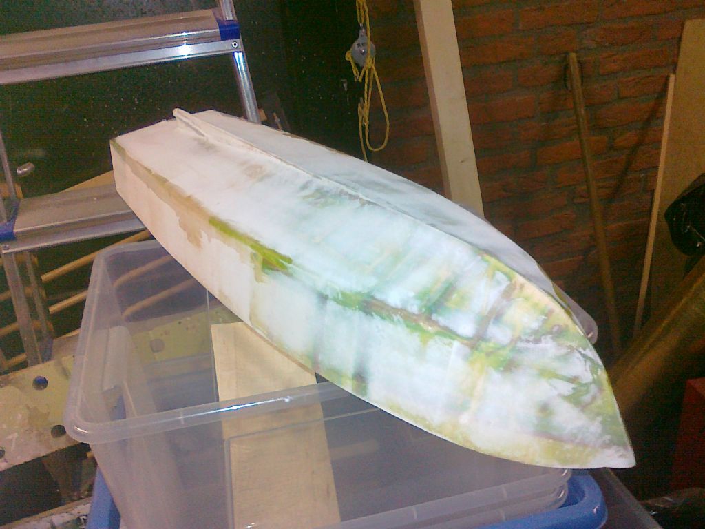

                                        Went out of my way this weekend applying home-mixed Epoxy filler and then sanding, sanding, sanding…
                                        The boat is now almost smooth, unfortunately I sanded through the tissue cladding on some spots so a second, real thin, layer of filler will be needed to get it perfect.
                                        Still, result of this weekend:

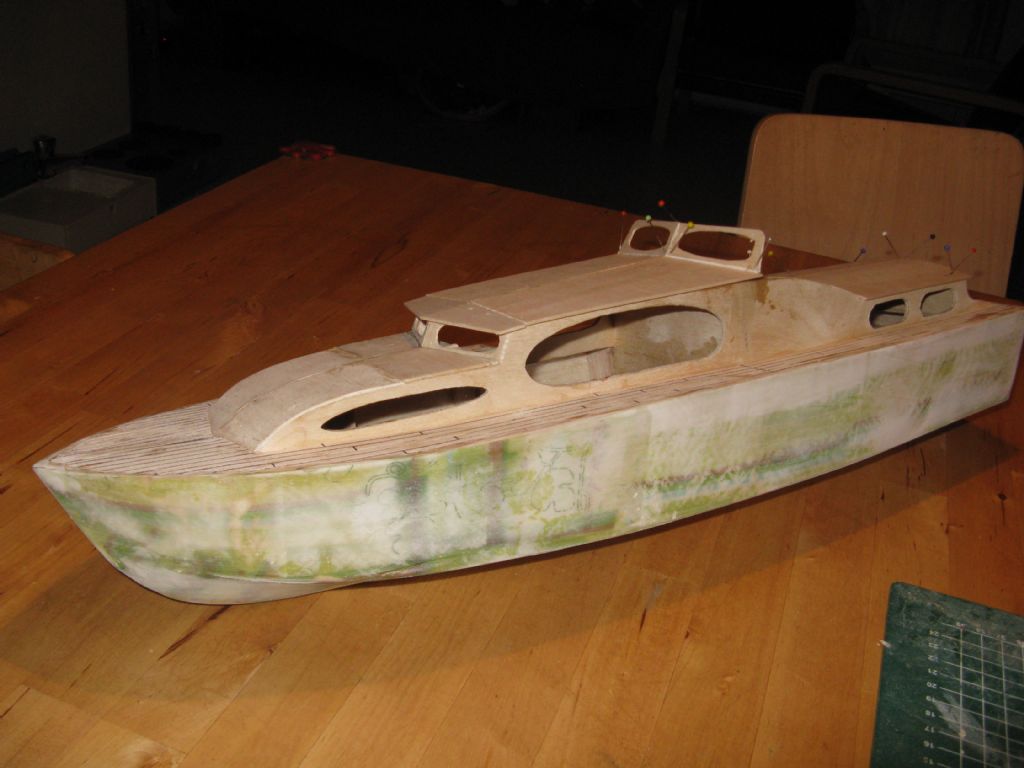

                                          After a short building stop – holidays, other hobbies, no inspiration for another tedious sanding session – I picked up the Sea Princess again. I believe the hull is now smooth enough for spray putty to be applied, but I first want the decks and superstructure to be treated with thin epoxy. So, I finished the superstructure roofs, thus adding the last parts from the plans (except for the rub- and spray rails, which I intend to make from plastic rather than Balsa).

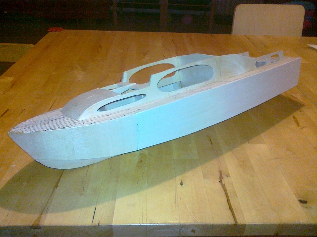

                                          It really starts to look the part now!Main build almost finished
                                          So, next step will be epoxy on the deck and superstructure, then spray-painting the hull and probably the superstructure as well, and then on to detailing! (and maybe a test run somewhere in between… lets see how much time I can free up. Schedule is damn tight, though)

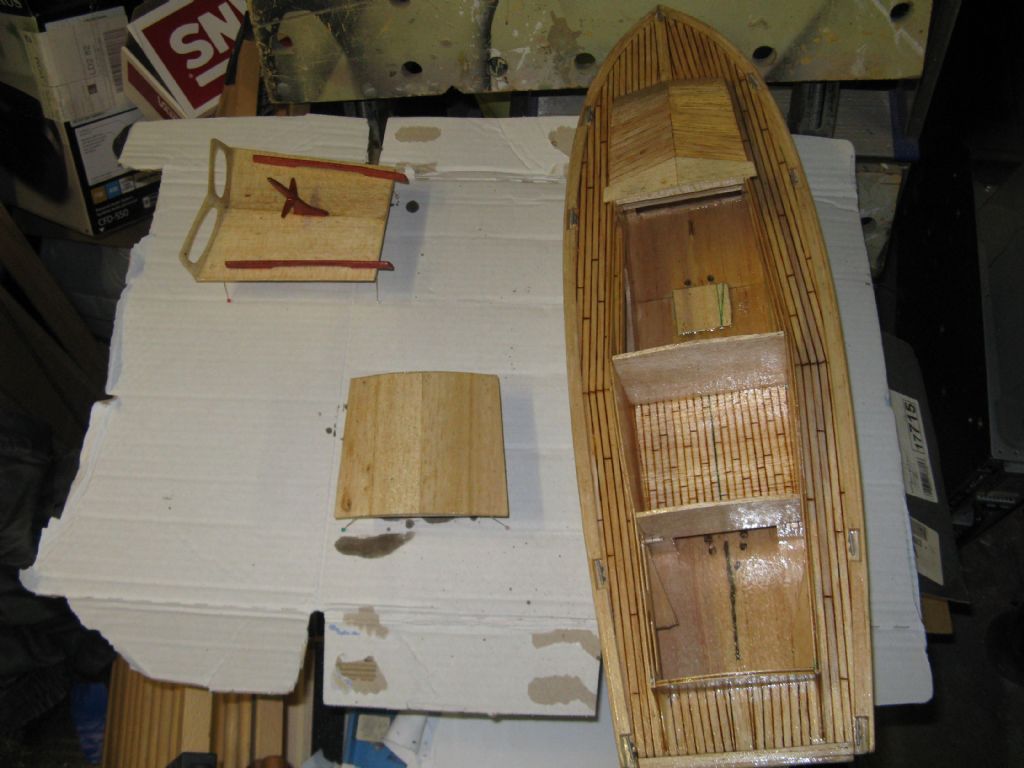

                                              Last couple of weeks I have not been so busy on the Sea Princess, but still have got stuff done.

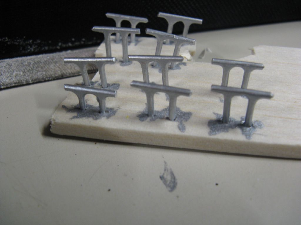

                                              I soldered some bollards (or how do you call the small 'uns in English), which after some paint look like so:
                                              Bollards soldered

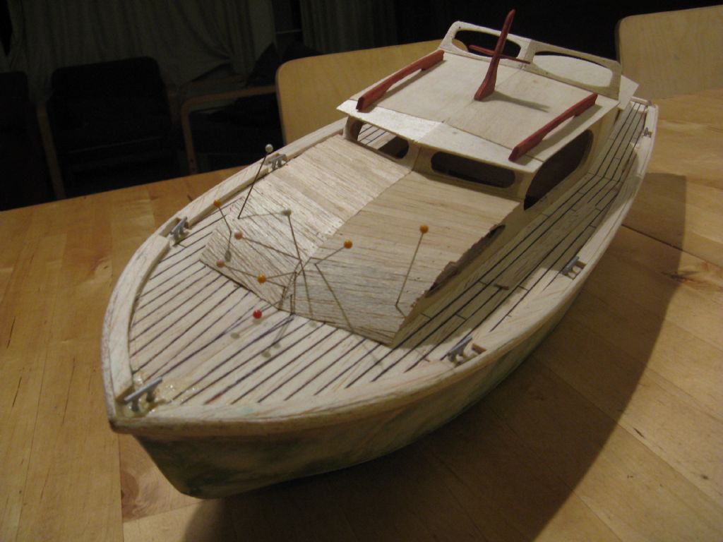

                                              Then I installed the rubrail and the footrail annex railing base, those little bollard-thingies and I decided that the fore roof was too much dented so I glued up a layer of small 1mm thick balsa strips to tidy it all up:
                                              Rubrail and footrail

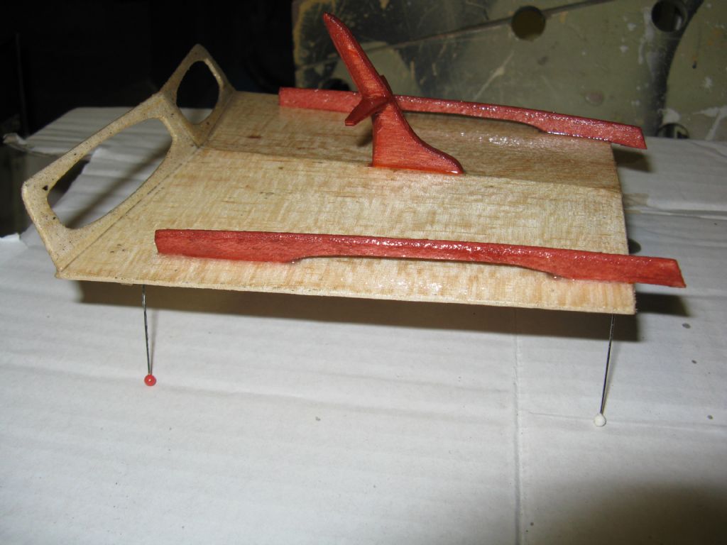

                                              The main roof now has its handrails and mast (including wings made of 1mm thick ply) "stained" and installed, and consequently covered with some thinned epoxy:
                                              Handrails and mast stained
                                              And while I was fooling around with epoxy I immediately did the entire boat and roofs, so it is as waterproof as it will get. Overview of how it is drying now:
                                              Overview after epoxy

                                                Your bollards (in fact, they are closer to the fitting the English call 'cleats&#39 are very distinctive. And, sitting in the little cut-outs in your foot-rail, they make the line of the vessel much more 'business-like'. The picture taken from the bow could be a professional advert for the boat – it looks better than anything I have seen advertising the full-size 'Sea Queen'! I look forward to seeing it in its final paint job…

                                                  As for the cleats; I realized some days after posting it should be cleats – too late to modify the post. That's what you get when you are not writing in your own language sad Ow well… Thanks for rectifying anyways.
                                                  I am really happy the way the foot-rail and cleats turned out, it gave me quite something to think about how I were to do the foot- and rubrail and not make it look silly. Indeed, the devil (and most of the fun) is in the details, and I am only at the start of it all… First I'll need to do a flotation test to determine the waterline, I think. And I am still out on the color scheme. The only thing I know is that rub- and footrails, decks and roofs will remain wood, and the superstructure walls and window frames will probably be white – and the rest…? Time will tell if I go for high gloss white or a nice deep marine blue or green.

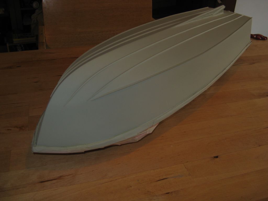

                                                  To finish this post, a little picture of the strakes installed and the whole hull covered in spray-putty:
                                                  Strakes added
                                                  I think this will be quite a performer, once again laugh
