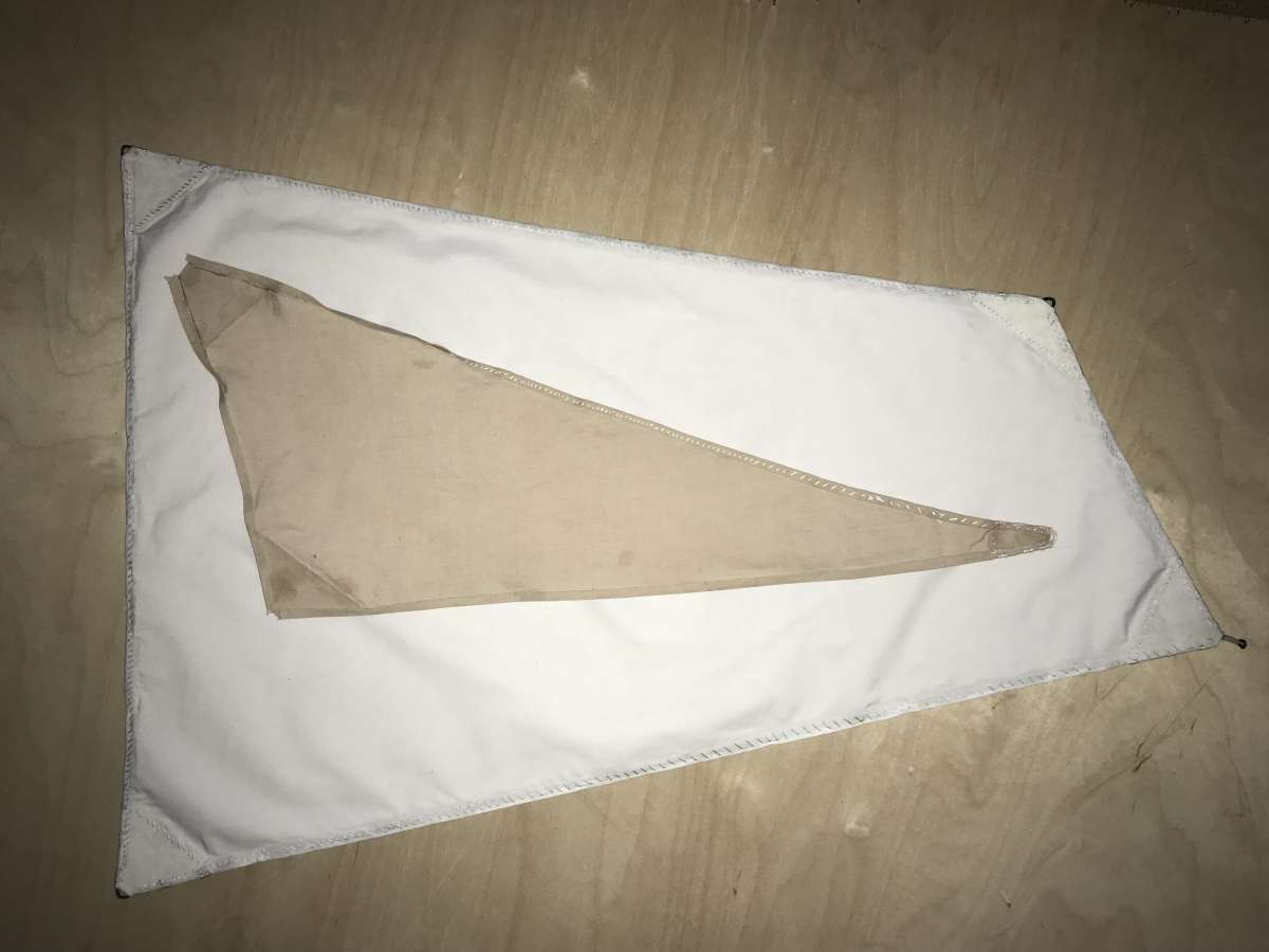

                IMG_0034IMG_0026
                #118191
                Johannes Jones
                  @johannesjones12331
                  Okay, I couldn’t work out how to add text after I’d uploaded the photos, so they’re in a separate post. I uploaded 2, one of the sails with the tea-dyed jib on top of the main so you can see the difference in colour, and one of the boat for which I’m making them.
                  The mainsail is a fail because for some reason, it came out undersized, and the jib was a fail because, as it was my first attempt at sail making and I hadn’t quite figured out what I was doing. Also, It’s the wrong shape, and this time it was my fault. I’m using these attempts to experiment on.
                  Anyway, hopefully you can get some idea of what tea can do to cotton. NB, the stitches are polyester and, as such, don’t take dye.
                  Enjoy.
                  John
                  PS the dark patches on the dyed sail are scorch marks from when I nearly let the saucepan boil dry.

                    wow! very impressive!
                    would you consider changing to cotton thread as the white polyester really stands out, or try beige polyester!!

                          I should perhaps add that the dyed sail was treated twice, once with 6 decaf teabags and again with 4 teabags (all I had left: I’m a coffee drinker) to deepen the colour. I added a spoonful of salt at the end of each boil to try to fix the dye. Also, to see how much colour I’d lose, I soaked the sail in cold water for several hours. Didn’t make much, if any, difference.
                          I should also point out that I have no idea what I’m doing here, so don’t take any of it as being the correct method.

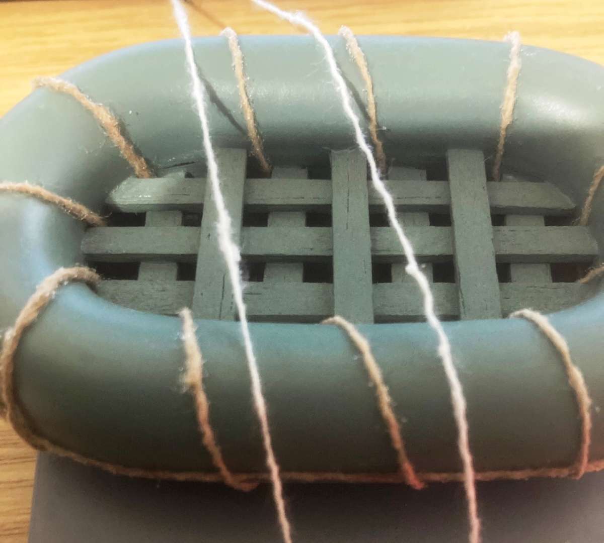

                            I used the same tea dying technique as you, including the salt. It was to dye a rope wrap (cotton twine) around a carley float on the back of another boat. It’s been out on the water a few times with no sign of fading.
                            Laid across the top in pic is the undyed twine for comparison.

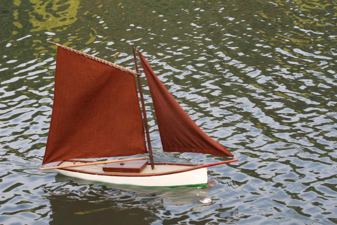

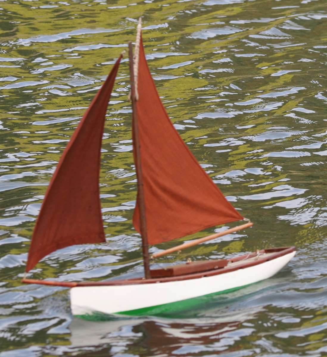

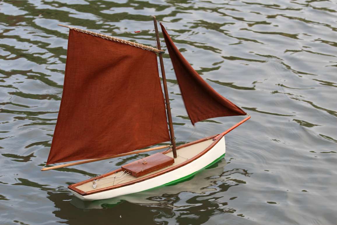

                                            When you say ‘Terracotta’ I’m assuming this is the sort of effect you are looking for:
                                            18-10-06-03WiltonParkMyGaffSloop3
                                            18-10-06-15WiltonParkMyGaffSloop15
                                            18-10-06-13WiltonParkMyGaffSloop13
                                            Unfortunately I don’t think any sort of household product is going to give you either the depth of colour, the opacity or the longevity you are after.  The only way you will be able to acheive such a colour will either be with a manufactured proper fabric dye or, as was the case with this model, buy yourself a piece of ready coloured cotton cloth to make the sails from.  A piece of cloth big enough for a model is surprisingly cheap and I’m sure would give you far better lasting results.  Check this out:
                                            Terracotta Cloth

                                                Richard: That’s exactly what I was looking for. 5 metres ordered. Thank you. Btw, that’s a nice looking boat. Are the plans available anywhere?
                                                Colin: As you can see above, for this query, Richard has come up trumps. I will visit the address you gave me for future reference. Thank you.
                                                I think I was blinded to the possibility of finding material that was already the colour I was looking for because I thought buying cotton intended specifically for model sails from Nylet, and then using Dylon products was the way to go, not realising that Dylon had completely changed their colours.
                                                Once I’d bought the cloth (@ £10 per square metre, btw), I was stuck in that groove and didn’t consider using the 6 square metres of cotton to make hankies or something and finding cloth already in the colour I wanted.
