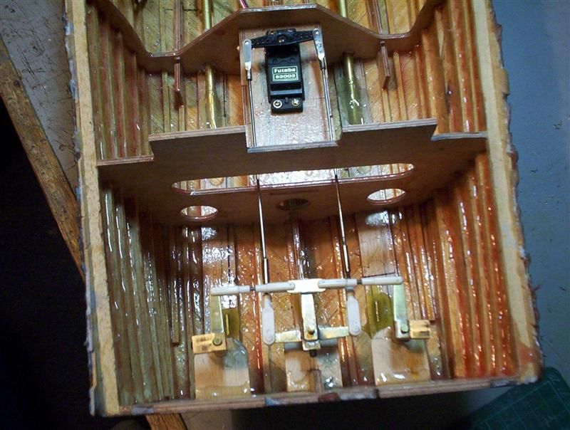

            hi there
            Heres a pic of the RAF Air Sea Rescue Launch (63 ft one triple rudder) this gives equal amounts of movements on the rudders and is a fairly robus setup. If I remember rightly on this particular model the 2 outer props rotated inboard towards each other as looking from the stern. The centre prop turned anti clockwise if I remember rightly. If you want to be pedantic some of the real Coastal Forces Vessels (PT boats) have all their props turning the same direction due to the fact that they were unable to obtain or manufacture in time, the reverse gear boxes.
            John

              Thank you Ashley! I did actually order two CW props in error which I will have on for now and later on will swap
              for a ccw. I did make the motor connections to
              allow for a swap later.
              And thank you John. I do wish I had went for the triple prop and rudder now. 🙈
              The Raf launch is many times neater than the inside of my PT offering. 😂🙈
