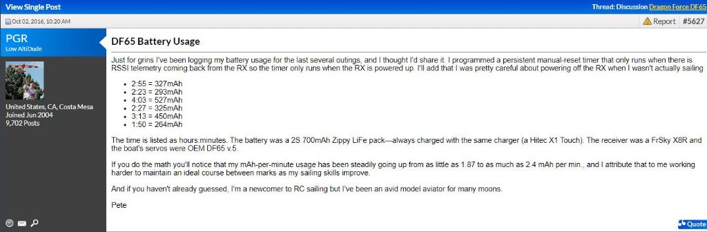

        I am using the Joysway 700mA LiFe battery and found this post on another DF65 forum. I should be able to get a day’s sailing out of my battery. I bought two of them and the small USB charger.

                Hi. Steven, your battery usage appears to be roughly in line with mine.
                Eddie.

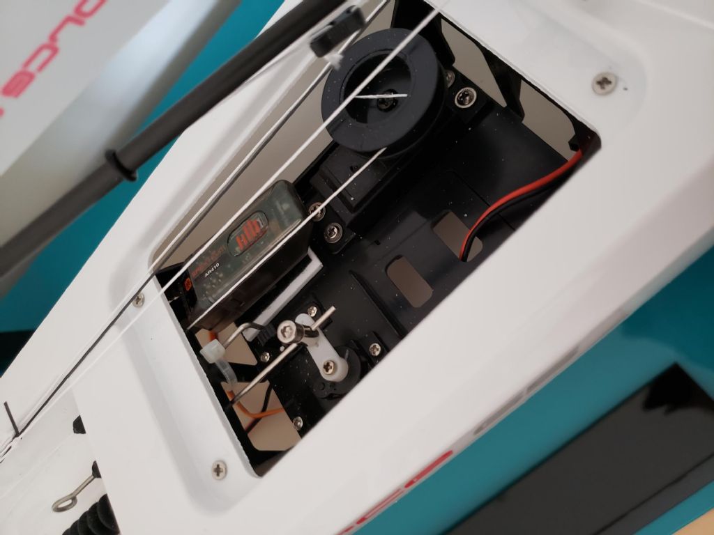

                  Each step I take, is tentative, often having to retreat.
                  Resetting the jib to ensure clearance with the mast. It proved much easier said than done. I ended with jib completely of and quite a lot of reworking, to an extent that I much regret not getting things right in the first place.
                  Anyway, I now have my new receiver, the servo and power leads in their correct channels. It is a bit tighter than I would like, in that the leads sit higher than I would like. I have bound the receiver.
                  I have issues with the aerials, which seem to have no provision for locating conveniently, with the tips set at 90 degrees. With model aircraft, this is important. I am guessing not such a major issue for yachts. What do others do.

                    Hi. Carl, although I haven't done it on this boat glue a couple of pieces of drinking straw where you want the aerials to go and then just tuck them in.

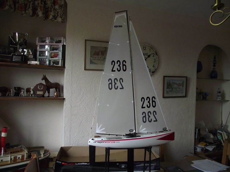

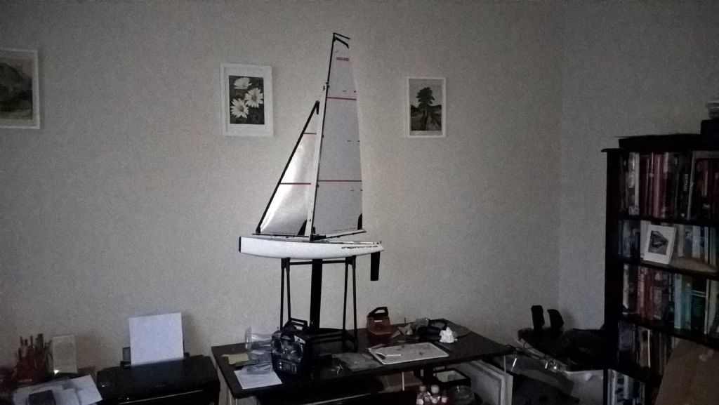

                    The A+ sails are now fitted to my boat alone with it's new reg.number.
                    As suggested by others I have replaced the wire forestay with a Dyneema cord, also the wire mast rings and the tack hooks,to allow the sails to move freely,especially in light winds.
                    When I tried to set the mast rake according to the instructions I was using, 985mm. from the hole at the back of the crane down to the transom, I had to put on a lot of backstay pressure, looking at a YouTube video the figure of 951mm. was given,this was achieved with the backstay loose and just a little forestay pressure, more inline with the A rig settings.

                      All ready for action now then Eddie. The jib sail is considerably higher than the A rig one.
                      I like the red strip below deck level, the hull is a bit bare otherwise.
                      Carl – given the size and narrowness of the hull I just pushed the aerials under the deck and didn't worry about them being 90 degrees. No problems on the water.

                        Hi. Chris, the main difference between the rigs is the jib, the mast is also 10mm. higher.
                        Yes ready for action and with a sail number they will all know who is causing havoc blush.
                        I think that less is more, I just want to see which is fore and aft, and which direction it is going.
                        Eddie

                          I like the Spectrum AR410 receivers, they have no external antenna and the leads fit into the end.ar410.jpg

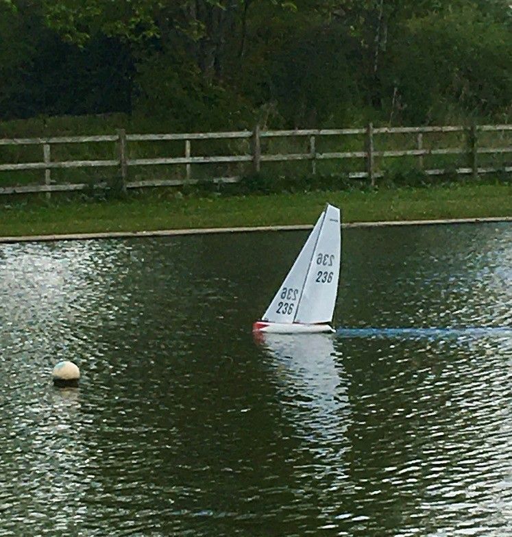

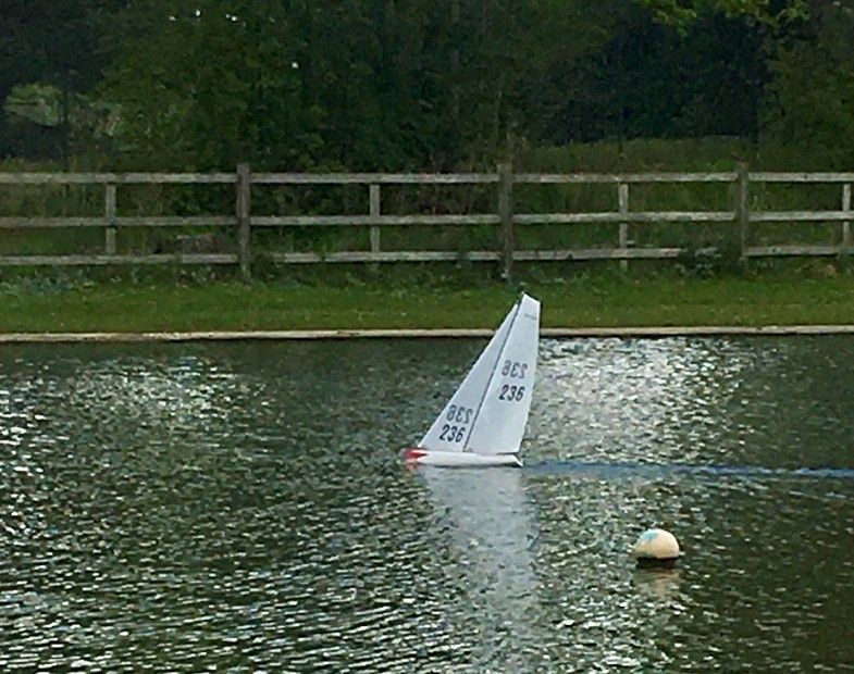

                            Took the DF 65 to Wicksteed this morning to try the A+ sails, the wind was quite light at around 5mph. The boat handled very well, it would set its own course upwind and needed little input from me, looking forward now to tomorrow when I can try it against the other boats and skippers.
                            Eddie.
