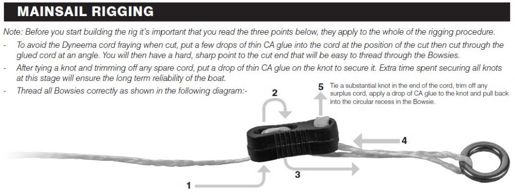

I always take a long time over assembly, being careful and have to retie sheets etc. to get the right lengths. Rigging is fiddly for man sized fingers and thumbs and so tweezers and long nosed pliers are useful.
It shouldn't take as long as the HydroPro though (which used earlier DF sails and rigging etc.) as improvements have been made and the instructions are clearer.

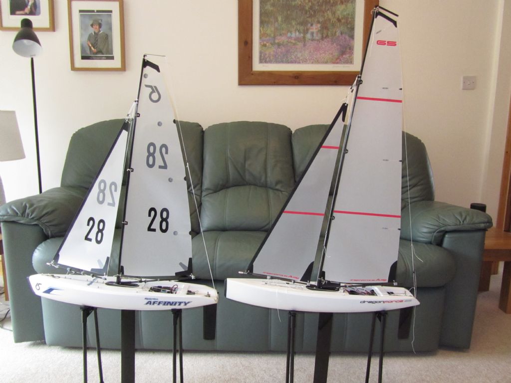

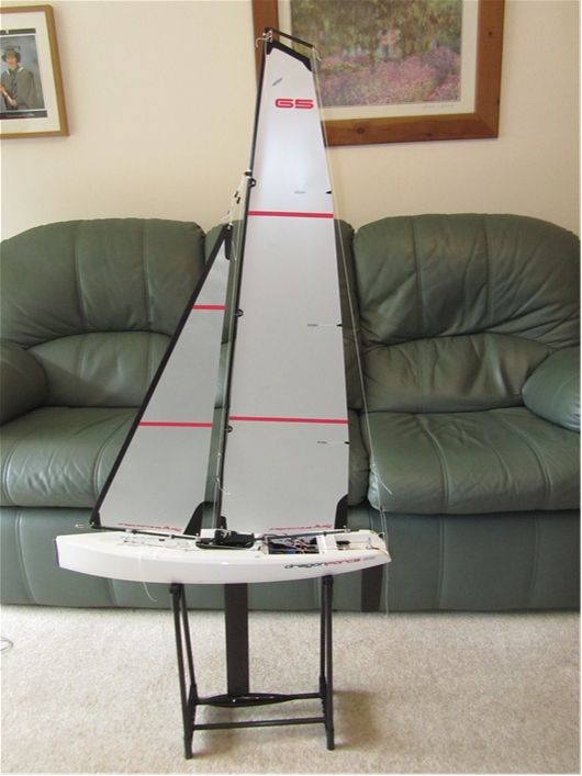

Photo attached which shows the narrower beam of the DF compared with the HydroPro. Surprisingly the A sails aren't much taller than the B sails on the HydroPro.
