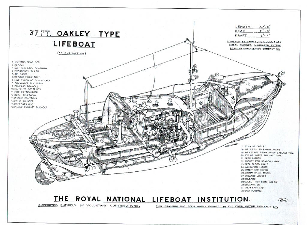

                      Oakley persepective view..

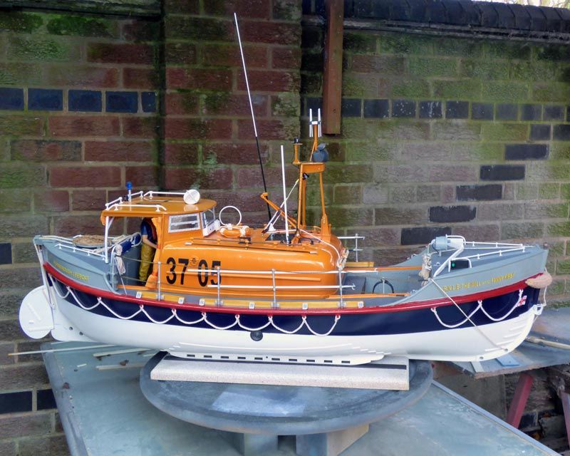

                      I have built several Oakleys with all the variations of steering position from fully open to the semi-permenant cover.

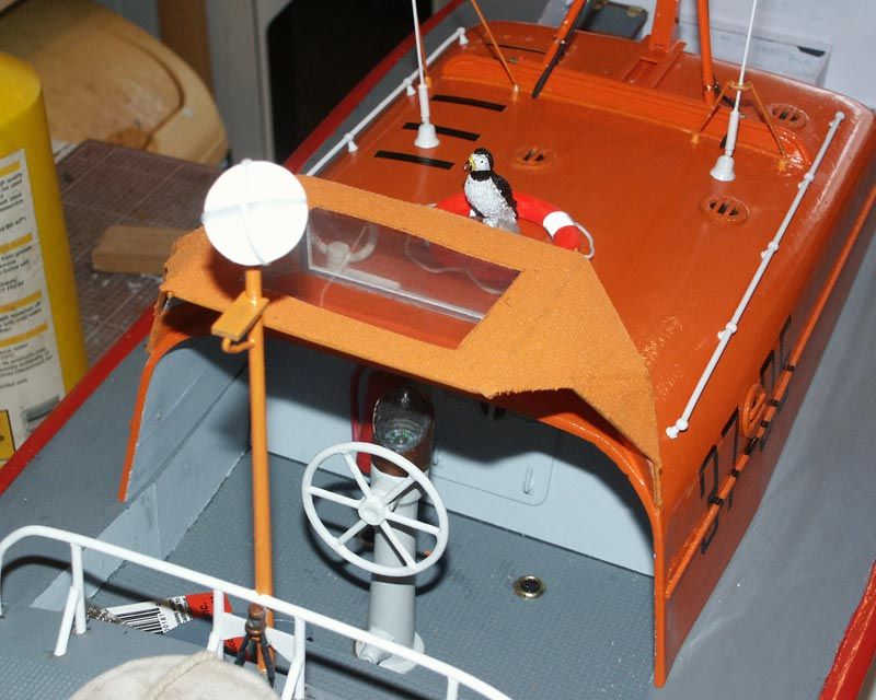

                      Early part covered steering position
                      Semi-permenant cover with roll up sides.
