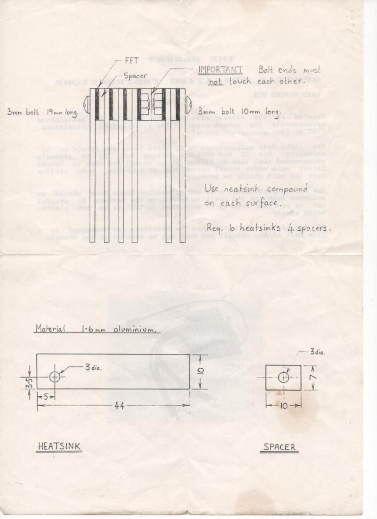

            This may help. Mine wasn't very good it didn't last very long it keep packing up. sc.jpg

              Hi guys, many thanks to both Dave Milbourn and Barry Gibson, your info was a great help and judging by that info it looks like alot of my equipment is a bit dated to say the least but as most of it still works perfectly well i.e. electric motors, r.c. gear and the boats themselves i will carry on recomissioning my small fleet so as to get them back running and make good use of the many lakes around my area now that i have retired and have abit of spare time these days, just don"t tell the wife will you, ha ha.
