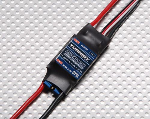

        esc.jpgHas anybody had experience with these ESCs? I need 3 of the blighters for my new Italieri Schnellboot and at a tenner each they seem good value but are they any good?
        #50657
          Paul. good make, obviously forward only but should be fine.
          May need to arrange a bit of airflow in the boat to keep cool, depending on the current your motors will be drawing.

            I didn't realise there was no reverse (where does it define that?) I've just found out that the motors I've ordered are 385s rated 15 amps so thats the ESC I'm looking for. Would welcome your suggestions smiley
            Paul L
            #50670
              PL. I think you will find this is listed as an aircraft speed controller, hence no reverse and not much in the way of a heat sink..although some I have come with a stick-on one.
              If you are not fussed about reverse and are not using too much power, these are fine and i have used a cuople (different makes) already. You do need to make sure bthey are set to the right battery and do not have a high voltage cutout. These are normally programmable and you need a program card, Not very expensive, worth their weight in gold. Ask Bob…oh, no perhaps DONT ask Bob!!

                  To figure out the required ESC you need to know what current your motor will take from your battery in reality rather than from a spec sheet which might have measurements taken in totally unrelated circumstances. Measure it under load, double the number, go for the next higher value ESC available, and that's your lad. Cautious derating like that ensures that the chosen ESC will survive boat use where they work harder for longer usually without the benefit of airflow cooling them. That, and avoiding ESCs with obviously extravagant claims regarding current handling.
                  The cost might be an upset, but performance costs, best to only spend it once.
                  Changing from 385s to 380s might take the single 15A ESC out of its comfort zone and eat into the safety margin. The increased performance will result in a higher current draw.

                    Your earlier post has some inconsistencies. A 380 motor has three poles and will spin at about 19000RPM on 7.2v unloaded i.e. it's a vicious little beast. Three of those in an Italieri MTB will make it fly but you mustn't run the motors at any more than 10A each or you'll be in danger of burning them out. The Turnigy ESC looks OK as long as you're happy with no reverse. In total contrast, the 385 is a 5-pole motor and generally runs on 12v, when it will spin at around 9000RPM unloaded. No way would it ever draw 15A unless you stalled it and three of those will make your MTB perform more like a narrow-boat.
                    I'd advise you to double-check what you've got before you go any further.
